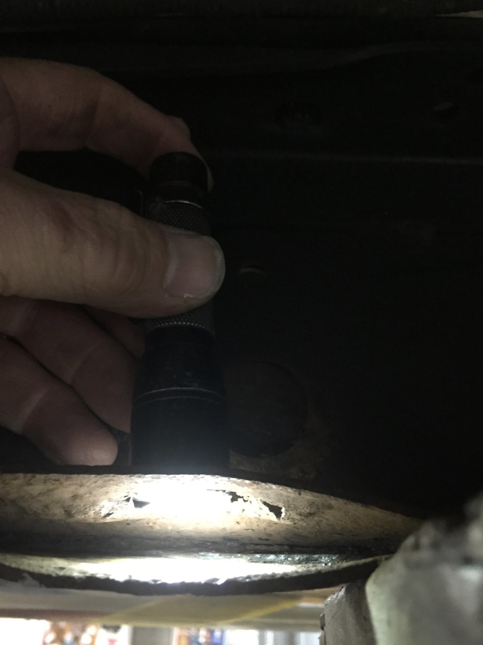

    CRC Coating is very temporary, and you should be wary of its application if you are very deep into the inspection timeframe. My 2005 had been inspected in 2015, passed with the coating applied. I had it parked for most of the following winter. Early 2017, all of the coating was coming off and the rusting was worse than ever. Mind you, I live in MN and rarely drove it in winter. I had originally acquired the truck in June of 2008, with date of first use Feb 2005. In fall of 2017 truck went into a different trusted dealer. Frame failed and all was replaced - got back about a year ago and all is well. Beware of the CRC coAting on a horribly rusted frame - not a good idea.

    I had the same experience and complained about extensive delamination under the bed. Having it inspected Decemeber 12.

    I just had my '08 inspected on Monday. It failed and a new frame is on order. They let me keep the truck until the frame is on site. The service manager said they'd use any replacement parts (leaf springs, shocks, etc) I'd want to supply (or order through them). I've got 163k on it and everything is original. Any suggestions for what I should consider replacing? MFRs?

    There were few objectors to the Class Action Law Suit, a tiny percentage - I objected to the CRC usage and the inspection criteria, as frames can be on the verge of failure due to significant thinning and delamination, but not technically fail. I also found that two of three dealerships in the Twin Cities difficult to work with - later finding out they are owned by the same outfit. Burnsville Toyota will treat you fairly in MN, and that’s who did my frame last year. Just sayin’.
