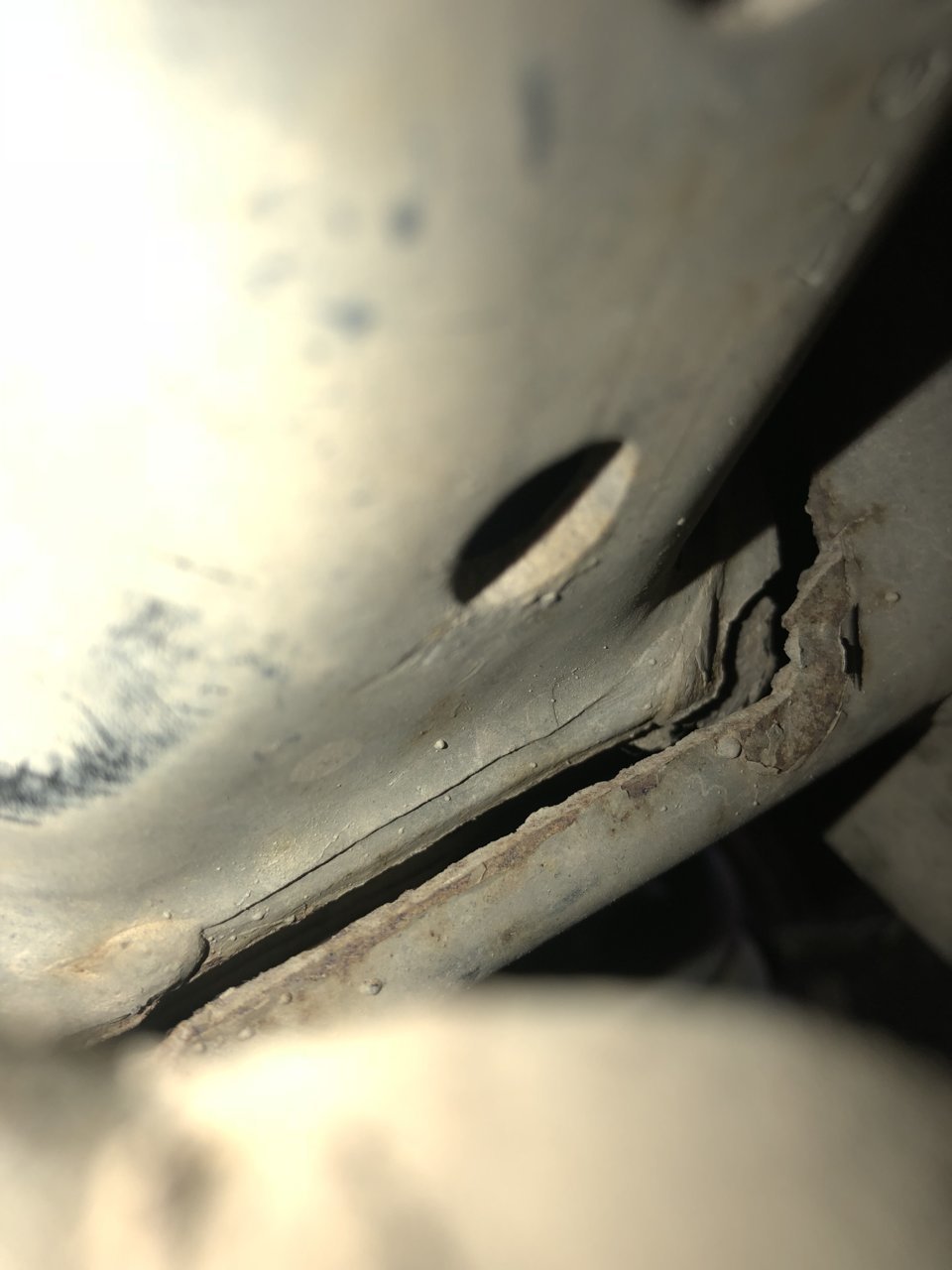

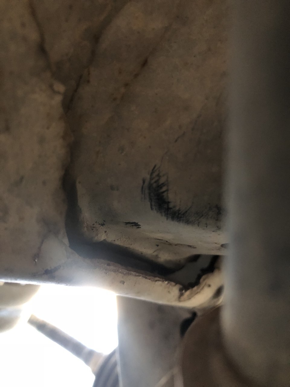

    That crack wasn’t due to rust perforation. There isn’t any rust around the crack. After the metal cracked it then rusted due to the metal being exposed and areas where the coating chipped off around the crack. Can’t tell from those pics if it was due to a defect in the welds or if it was abused. But definitely not from rust perforation.
