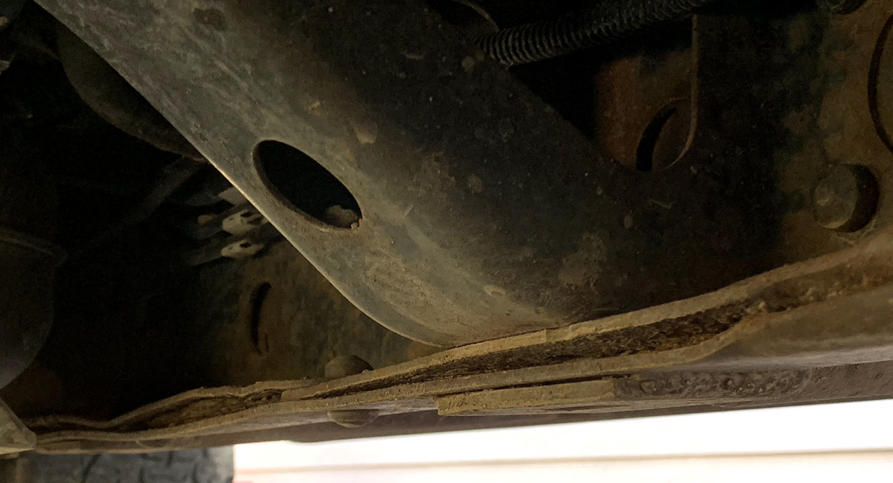

    When I bought my truck, I took it to my local dealership to get it inspected since my frame had been only coated. They told me that there was a hole in the frame and that it would need to be replaced. They said I would receive a letter in the mail when I could get it replaced. A year later no letter. Took it in again to see what was up. They continued to say that I needed to wait on this letter. I ended up taking it to the next towns dealership and that day they ordered everything for me and within 3 weeks had my frame replaced.
    This is the spot that they said why it needed to be replaced. If I would have touched it, it would crumble in.
