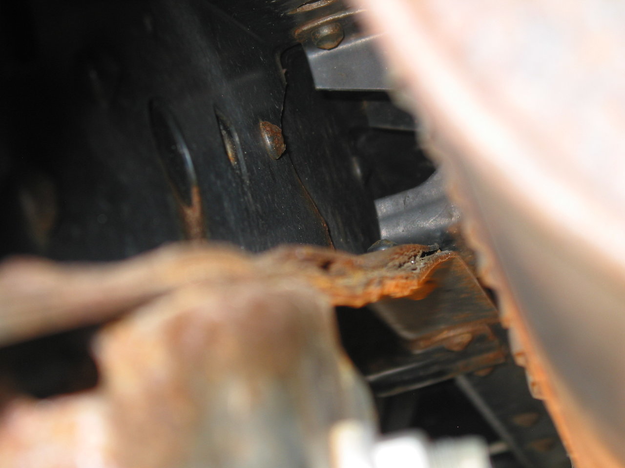

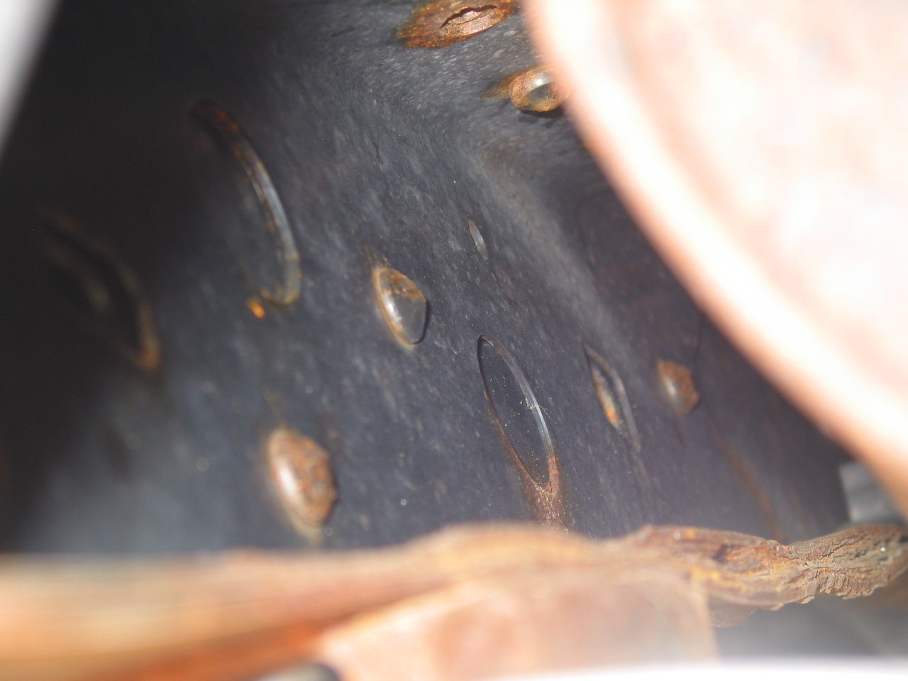

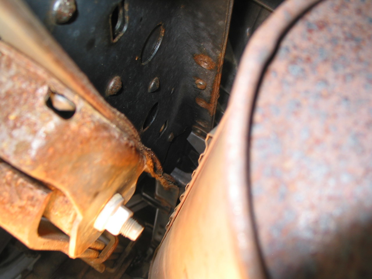

    These pictures of my frame rail next to the muffler were taken 3 years ago before I was scheduled to have the CRC applied after the LSC inspection passed. I never mentioned it to the dealership when they inspected the frame and was thinking that when they inspect it again before the 12 years expires, I will ask them to look at it. It must be more than 10mm by now, I thought it had to be a 10mm hole and didn't think it would qualify for the internal layers bulging out would fail it like it did yours @roadking1 . I dought they even checked that area, being almost hidden by the muffler and don't think it's an area they test with a hammer either.

  18. Dec 26, 2017 at 2:28 PM
    #118
    roadking1
    roadking1 Well-Known Member
    Sep 28, 2010
    #43941
    910
    n.j.
    2023 Solar Octane TrdPro 6-speed manual
    The frame rails on mine were in the area high lighted by Toyota as structurally unsafe. Not hidden by the muffler or anything else.
  19. Dec 26, 2017 at 2:35 PM
    #119
    Markcal
    Markcal Well-Known Member
    Aug 14, 2014
    #136147
    3,115
    Does that mean this area wouldn't qualify because it's not in an area high lighted by Toyota as structurally unsafe?
  20. Dec 26, 2017 at 2:42 PM
    #120
    roadking1
    Sep 28, 2010
    #43941
    910
    n.j.
    I think that it is still bad enough to fail. When do you take it in for the inspection?
