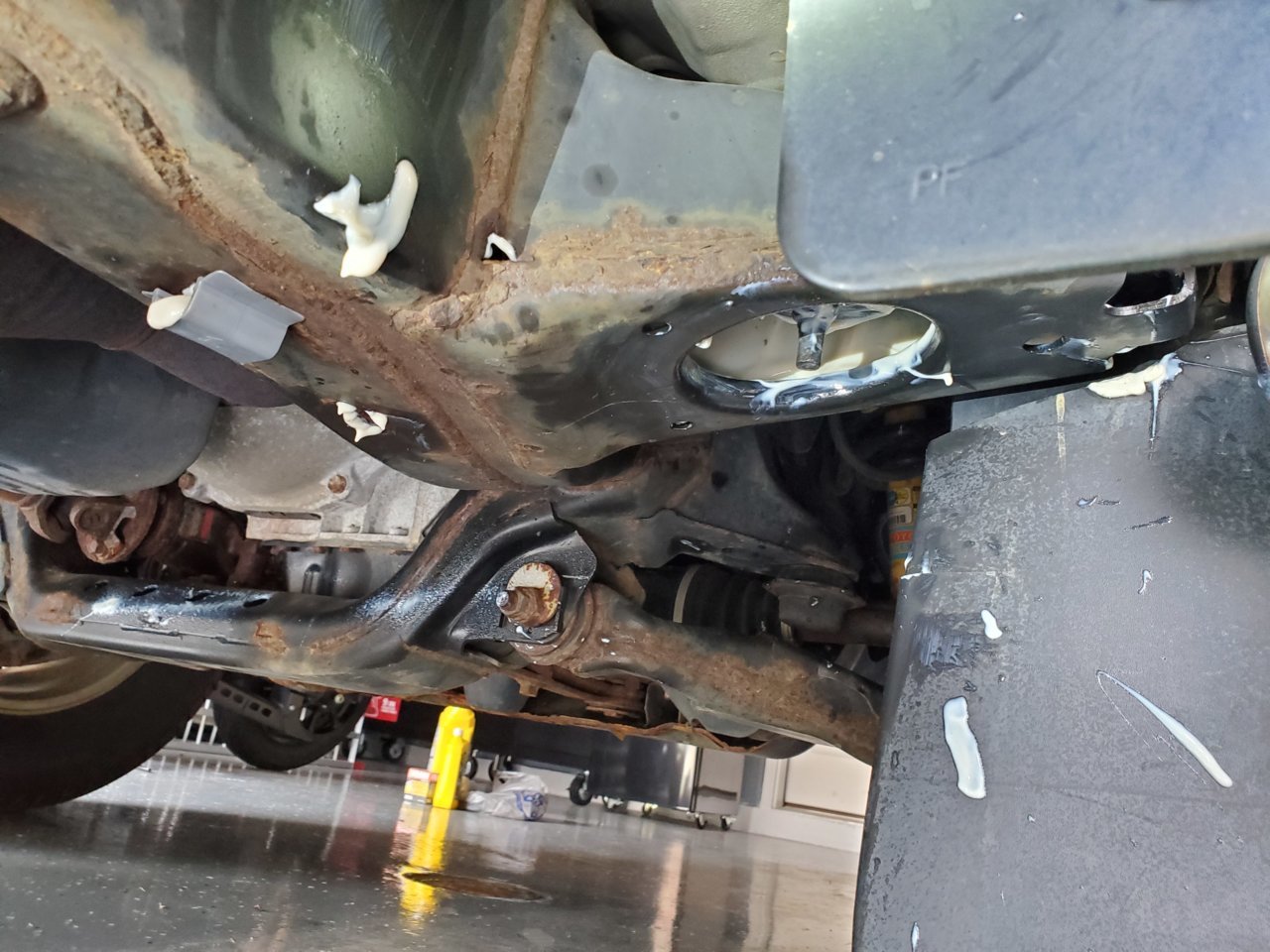

    what the Hell is this? that looks like shit. I had my 2004 get a frame rust treatment under a recall they sprayed the entire frame with some sticky black stuff and I thought that was a bad job

    Yeah i thought so too. Wanted to see if anyone else had a "professional" job done like this. But if it does its job that's all that matters I guess

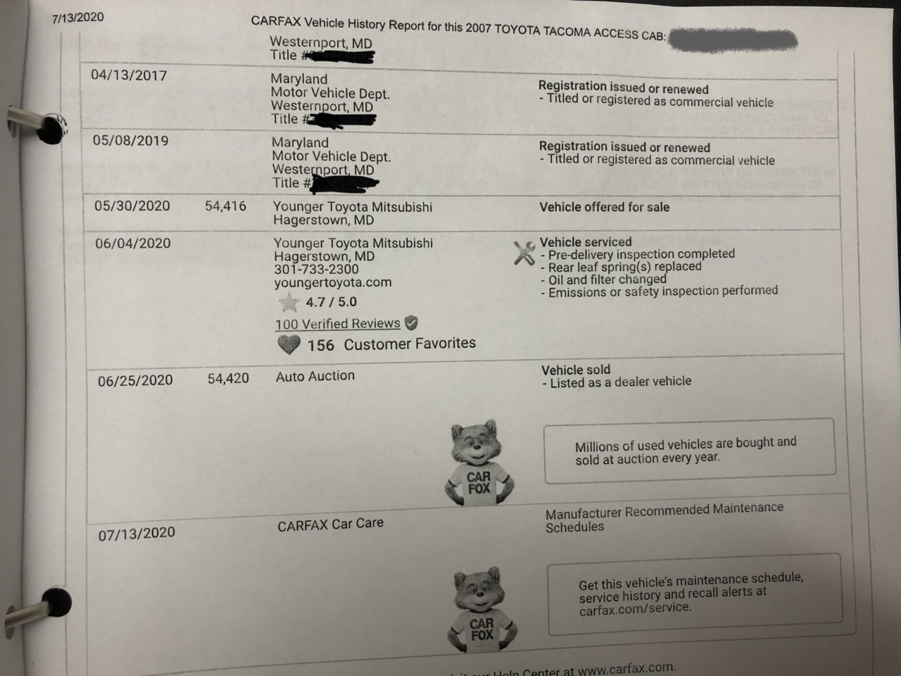

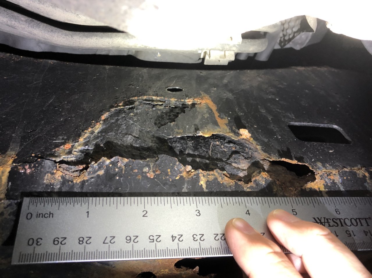

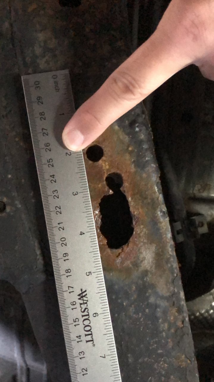

    I just bought a 2007 Tacoma from a random used car dealer. Roughly 55,000mi and for a fair deal. Checked the Carfax, other websites, VIN looked good. Looked it over, look at the frame, appeared to be coated and I presumed it was cared for. Everything looked good. Mistake I made was that it was not inspected, It came from out of state. Having seen the Toyota dealership that sent it to auction had done a PDI inspections and "Safety Inspection," I presumed it would pass without fail. Fast forward, I finalize the sale, "as is" and took it to my local garage for inspection. They find holes in the frame, all located in the same area behind the front driver side wheel. Well I'm beside myself, like "what have I gotten into." So I sit on it for a few days and a friend of the family who is welder, like that's his job, offers to look at it. Goes at it with an air hammer, finds a hole on the inside of the frame is as big as his fist. So I've been looking into the recall and extended warranty, called the local dealership here in town, they essentially said, "Nope." So is that it? Am I SOL?

    Unfortunately, yes.

    Is there a CARFAX warranty that can be invoked? Maybe they have a clause that says they overlooked a lemon, can file a claim that the safety inspection was fraudulent? I think your options are pretty limited, sorry to hear about this.

    I think you're too late with Toyota. You might be able to argue the "safety" inspection wasn't proper. Or the 'as-is' vs any lemon-laws PA might have for used vehicles. Best of luck.

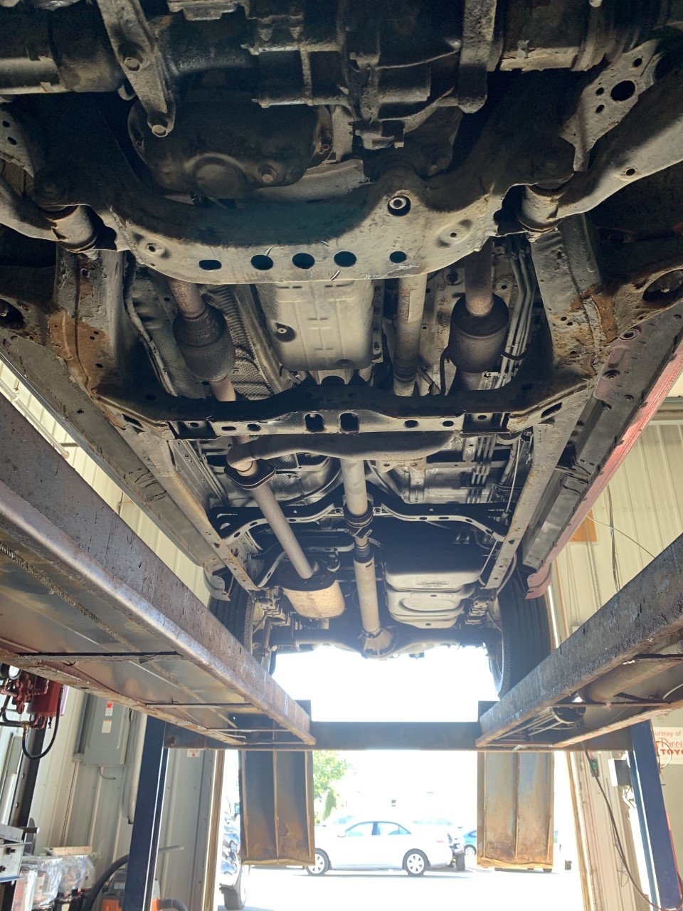

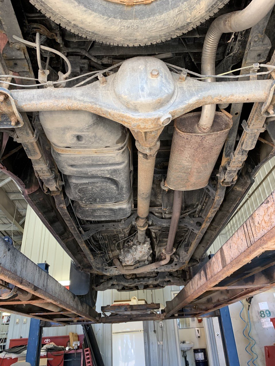

    Hey folks. I'm new to the forum and I'm looking at buying an 09 taco up in Canada. I believe the CRC remedy was done early last year and 12 years would expire in December of this year. Does this frame look alright for a truck with 170k km / 106k miles?

    ^^^ To be honest with you It looks like it was neglected it’s whole life.

    Test frame with hammer all over
    If you do buy it rinse road salt often and apply Fluid Film Spring and fall

    Coming from someone who lives in a shitty salty spot of Canada, it isn't terrible. It's not great, but not terrible.
    And as for being neglected its whole life.. It has undercoating applied (You can see in the first picture, it is worn off where 4 post lift pads go, and the indentations from a floor jack on the front cross member.)
    I would do what most people suggest, and take a hammer to the typical spots that are known to rot through first. These are right by the cats on the boxed section of frame, and check it over reaaaaly close.

    I appreciate the advice, guys. After checking it out in person I decided to pass.
    A local dealer told me there was a shortage on new frames so I didn't want to risk not being able to get it swapped before the enhanced warranty ran out.
