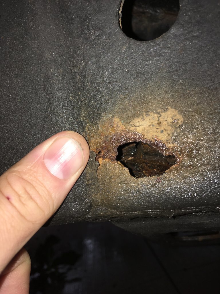

    It's raining here today and I don't want to climb under the truck. Here is the hole by the cross member on the passenger side. I would say my thumb is 20 mm wide. I can stick my finger all the way through the frame. The holes on the drivers side by the cat is way bigger. IMG_1196.jpg

    Wow thats crazy, and it looks like your frame was coated too :(

    So much for them fixing this shit with the newer gens.

    It was coated two or three years ago. The truck has 70k on it. It is getting inspected as I type this.
