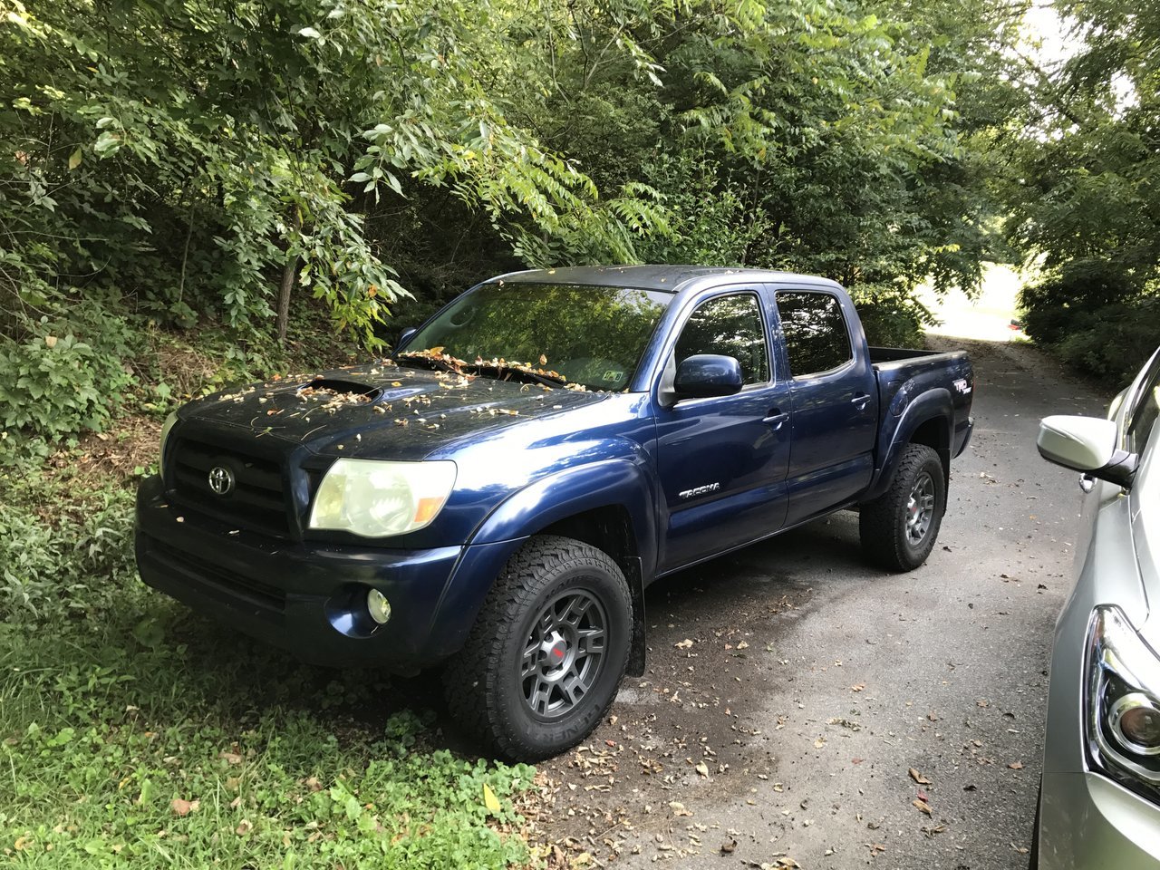

    2006 Indigo Tacoma
    Yup, that was me and my parts manager told me that they were finally able to order the parts on Tuesday and mine failed the inspection about a month ago. I just bought the truck 6/30/17. I already submitted the documents that they asked for to get reimbursed for the frame patch that I had done and the brake lines that I replaced. I was told 2-3 months before the parts are in. Luckily for me, I can wait and have have to take a used truck off the lot if I need to use one.
    I also found out that the tech will take a picture of any holes with a 10mm wrench held up to it so the size of the hole can be put into perspective to whomever is reviewing the photos.
    Here's my truck since I never posted a pic before. It's a 2006 6spd with 64k miles. I asked about the hitch and my parts manager said they most likely won't do anything about it. I'm probably going to buy a new one along with shocks and I'm thinking about a ToyTec lift kit while it's apart. For what I bought it for, thinking I'd have to pay out of pocket for the frame, I'm not going to complain about the hitch. If I was in the position of some of you, I'd be trying all I could to get them to replace that as well.

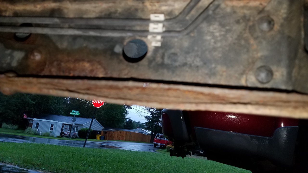

    Bill
    East Central Upstate NY

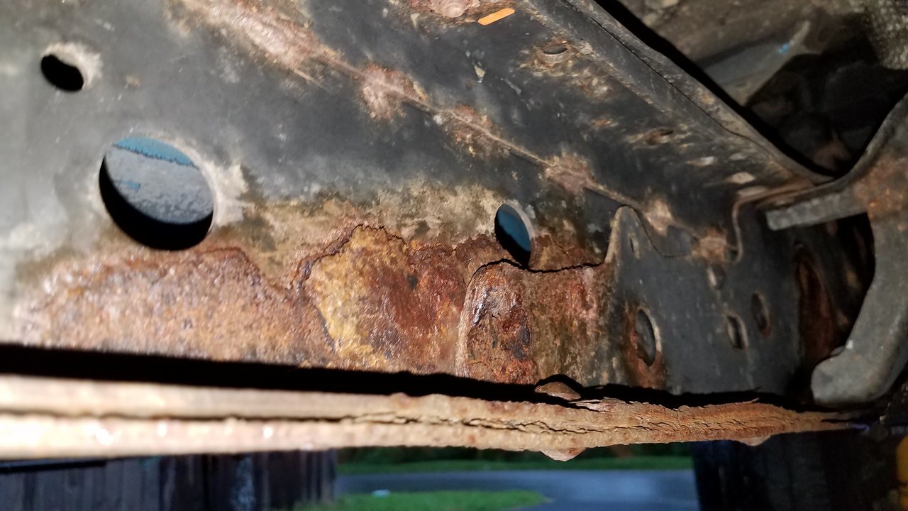

    I have what is in that 3rd pic and dealer said it's normal .My frame has lots of rust but no holes. I or the dealer can notfind any holes..Acually most of those picture look like my frame but no holes .

    I'm looking right now ......... Nothing

    I'm trying to figure out my next step since my frame passed inspection (no holes) but I don't like the looks of it .

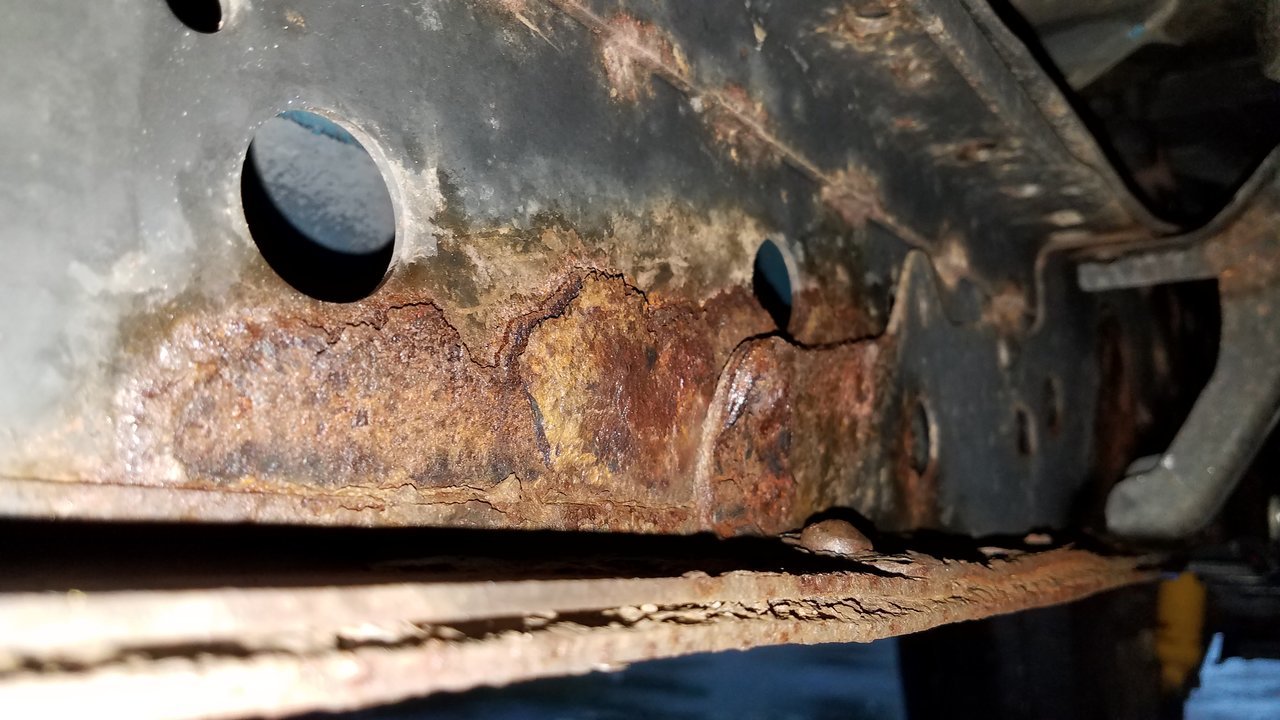

    Bill
    I need to crawl under again and take another look .Part of frame rail is coming apart in layers and the dealer said it's normal .

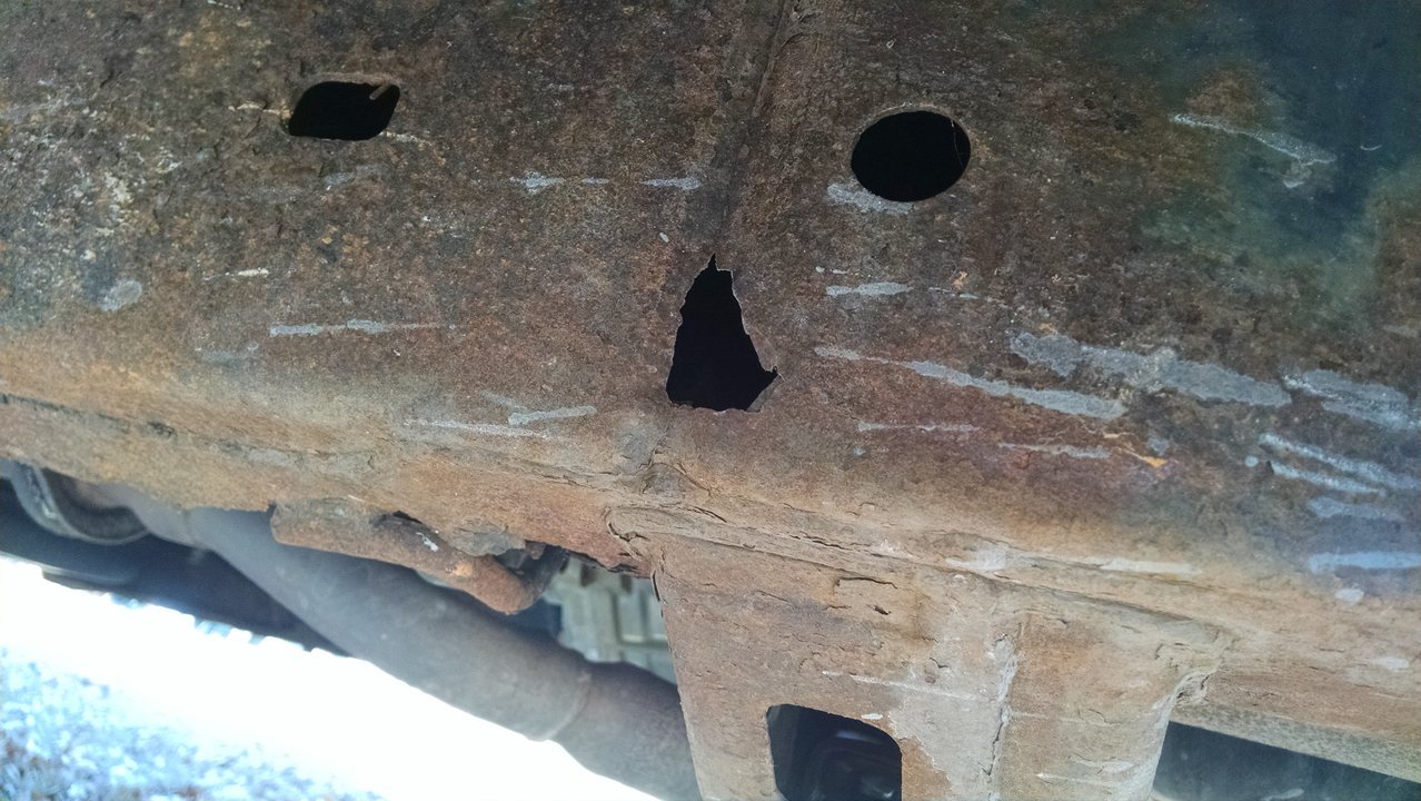

  19. Sep 3, 2017 at 12:35 PM
    #939
    Gaunt596
    Gaunt596 Well-Known Member
    Jun 19, 2013
    #106627
    5,790
    Matthew
    Central Maryland
    mine failed entirely because of the first picture. youve still got time, give it another winter and dont wash it and maybe youll get one. you need one 10mm hole ANYWHERE on the outer frame rails, and that fails it.
