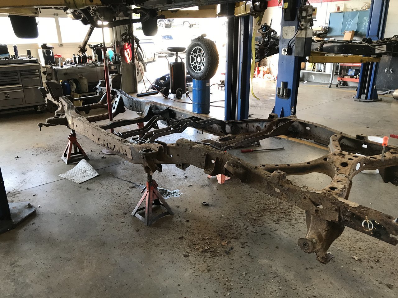

  5. Sep 23, 2017 at 6:12 AM
    #1085
    20RustyTaco06
    20RustyTaco06 Well-Known Member
    Jun 21, 2017
    #222088
    434
    Allen
    Dublin, GA
    2006 sr5 Tacoma DBL cab auto/4wd
    Complete Pioneer audio Supreme Suspension 3" spacer lift 255/75-17 Kuhmos/Sport wheels 1.25" wheel spacers Tint
    Well...Frames in and they've already started the swap. The beds off and the new frame is sitting across the aisle, NAKED.
    Manager says I should have it back in a week. :bananadance:

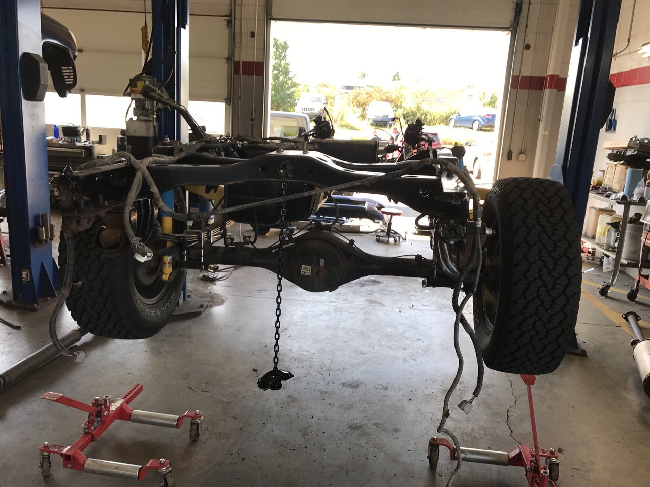

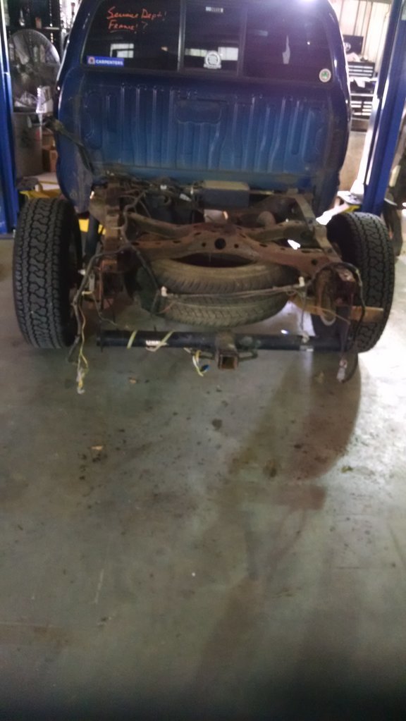

  9. Sep 25, 2017 at 7:37 AM
    #1089
    ruskymx
    ruskymx Active Member
    Jul 4, 2017
    #223127
    25
    2006 Indigo Tacoma

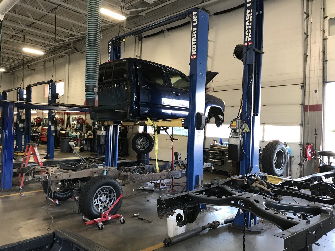

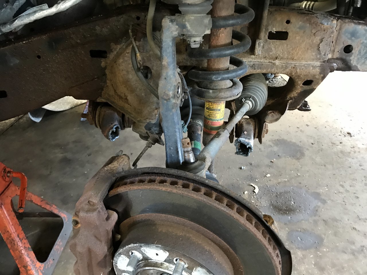

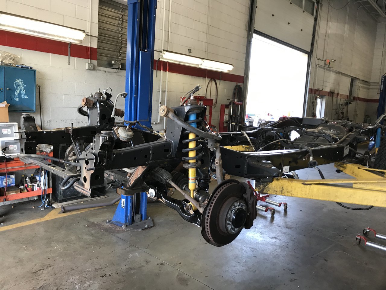

    The last picture is from this morning when I dropped off the hitch to the tech. He said he should be done tomorrow. He's going to take it home to make sure everything is good and I'll take it home Wednesday. I'll stop up after lunch today and take pics of more progress. He was changing the front struts this morning. Not part of the process but I am replace them and the rest shocks Ali g with a new hitch since my original was a rusted mess.

    Moving right along :thumbsup:
  11. Sep 25, 2017 at 9:54 AM
    #1091
    Edwinc357
    Edwinc357 Well-Known Member
    Jun 20, 2017
    #221960
    155
    Edwin
    2006 Toyota Tacoma

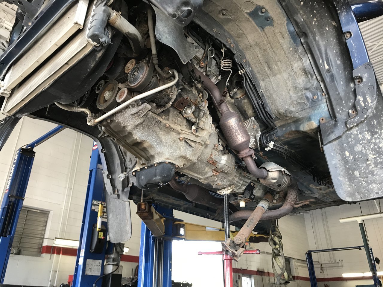

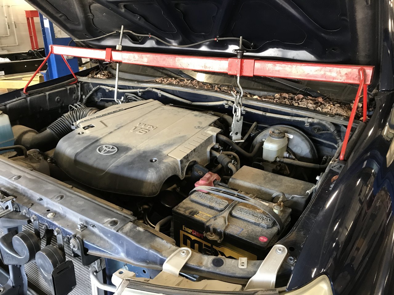

    He is just letting the engine and trans hang on the support bar. Crazy crazy haha but nice to see people getting a new frame.
  12. Sep 25, 2017 at 9:55 AM
    #1092
    Muddinfun
    Muddinfun Well-Known Member
    Apr 17, 2017
    #216500
    7,489

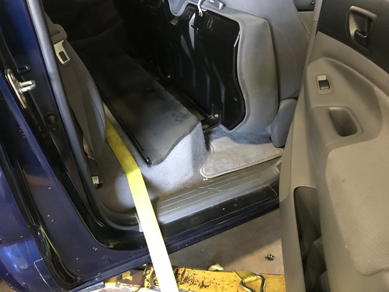

    Interesting that they're leaving the the engine/trans/transfercase with the body. I thought of this awhile back and wondered if anyone was doing it that way. By doing it that way, they save a lot of work with, hoses, wires, coolant, refrigerant, shift cable, exhaust, etc. Even if some special fixtures were needed to support the engine/trans/transfercase, it would save time. The only thing I would wonder about, is if the front structure is strong enough to support the weight of the engine, and if the rockers are strong enough to support the whole load. Since they have a strap on the rear, obviously the entire weight is resting on the front lift pads. I'm guessing that the official Toyota way is not like this and some creative tech figured out a way to save a bunch of time.
    Here's a video that shows what I would call the more traditional way. After all, this is the way the truck was originally built.
    https://www.youtube.com/watch?v=ibfjzXwY8GE&t=2s

  13. Sep 25, 2017 at 10:06 AM
    #1093
    ruskymx
    Jul 4, 2017
    #223127
    25
    2006 Indigo Tacoma
    There's a alarge strap around the transmission and looped up through the back seat area or the cab that supports some of the weight as well. I'll try to get better pics of it.
    I know the guys can still make some time on these but no like they used to. It used to pay of 60 hours but toyota cut that down to 45 I think.
