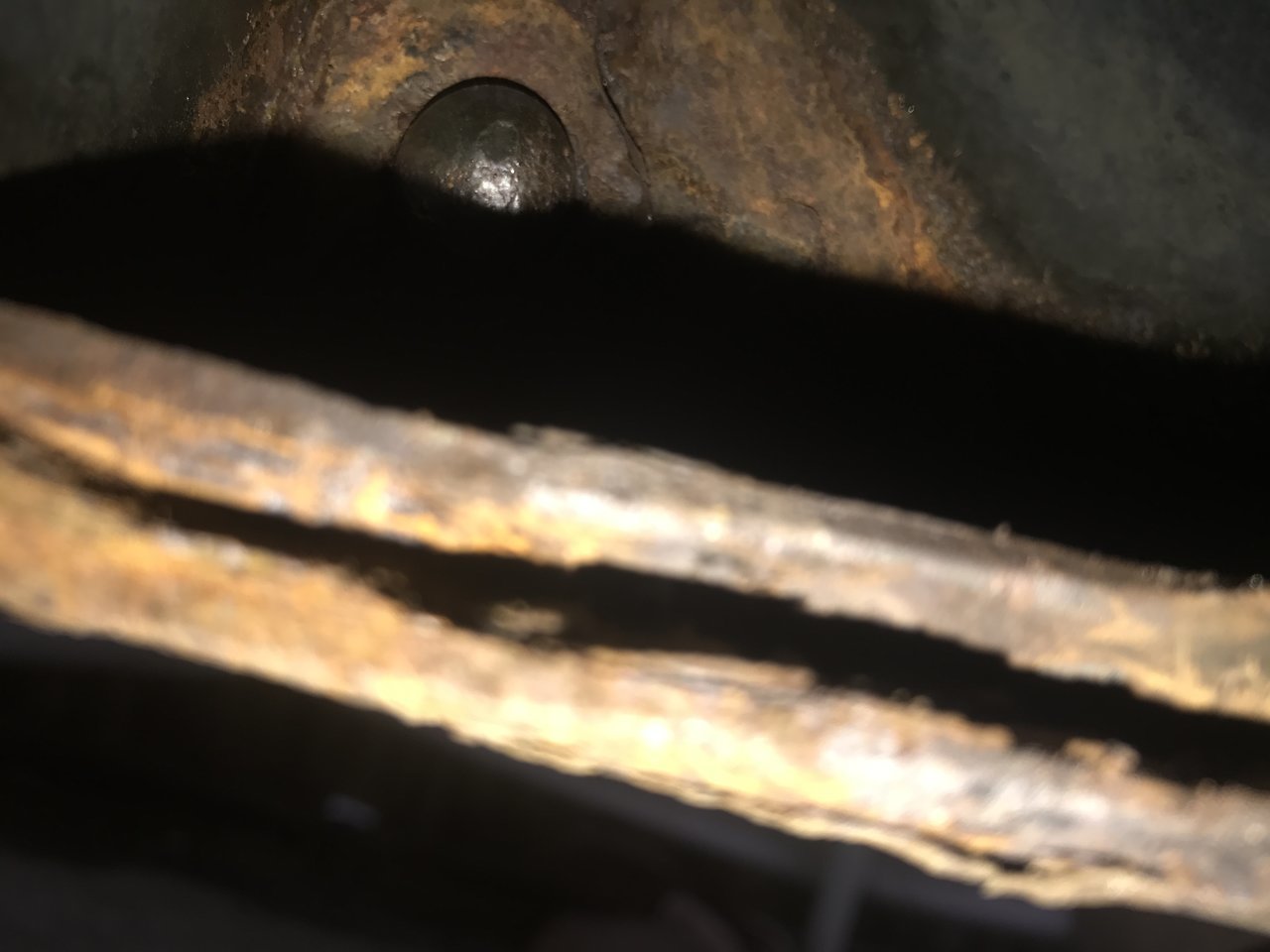

    Question for people who had theirs replaced, any idea if frame separation counts or is it just a hole? I was looking under mine today and there are several spots where the overlapping frame rails are peeling away from each other, some spots it’s at least a 1/4 to a 1/2 inch gap. I will try to post a picture later.
    Also, some of the drain holes are definitely getting larger, one on the passenger side is pretty big compared with the drivers side. I don’t know how big they should be on a new frame.

    get some pictures. The requirements are 10mm perforation, the drainhole is probably what would fail you.

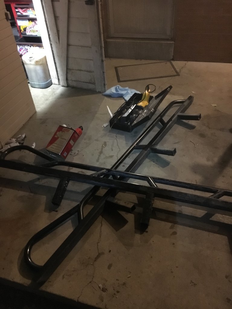

    Question - any of you guys that have weld on sliders having problems with the frame recall ?

    Mine failed, and once I got approval from toyota I cut off my sliders
    Razorecko[QUOTED] and Edwinc357 like this.

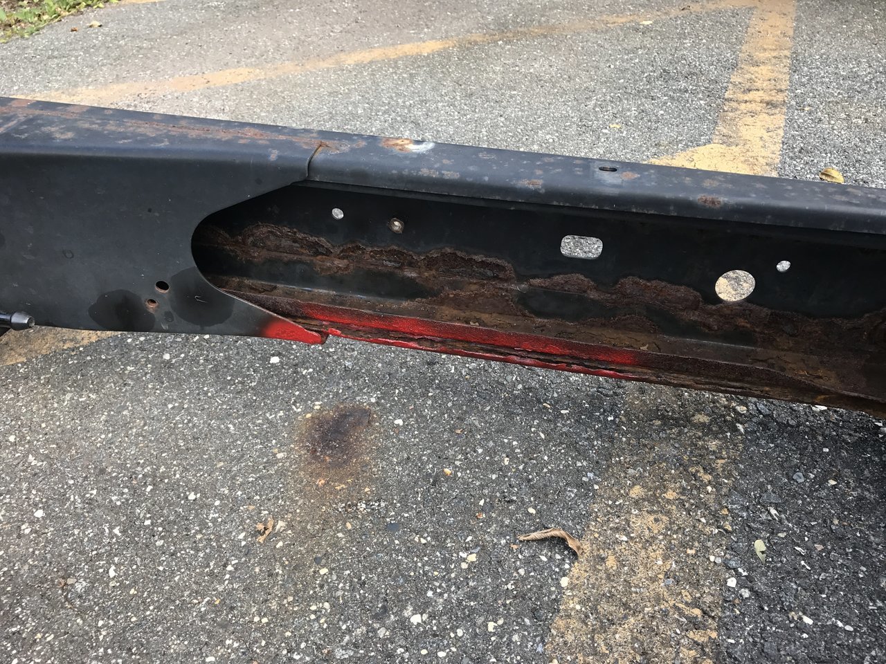

    My frame rails were separating... it failed because of this.IMG_0638.jpgIMG_0734.jpg

    It was separated so much that it probably counted as a 10mm perforation

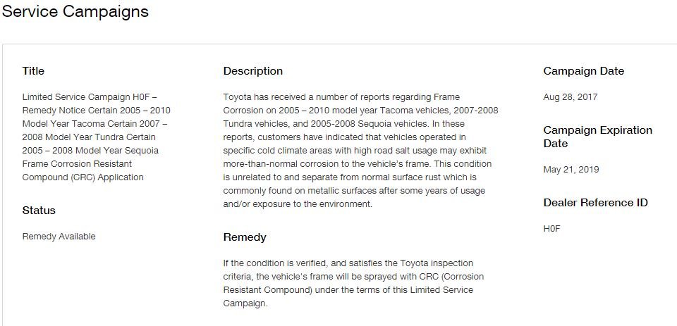

    So just recently I had the frame replaced on my 2008 Tacoma. I was at the dealer this past weekend for maintenance and they told me I still may get a call to have the CRC under coating done. I thought the CRC under coating was only for those Tacomas that didn't get a new frame. Anyone else hear anything about this??

  11. Oct 16, 2017 at 7:31 PM

  12. Oct 16, 2017 at 7:35 PM
    #1292
    roadking1
    roadking1 Well-Known Member
    Sep 28, 2010
    #43941
    910
    n.j.
    2023 Solar Octane TrdPro 6-speed manual
    That was only being done if you passed the frame inspection.. A new frame or the spray
  13. Oct 16, 2017 at 7:36 PM
    #1293
    kilroy2963
    kilroy2963 Well-Known Member
    Jul 16, 2017
    #224168
    163
    Massachusetts
    2008 Blue TRD Offroad
    Thats what I thought also until they told me they are doing both this past Saturday.
