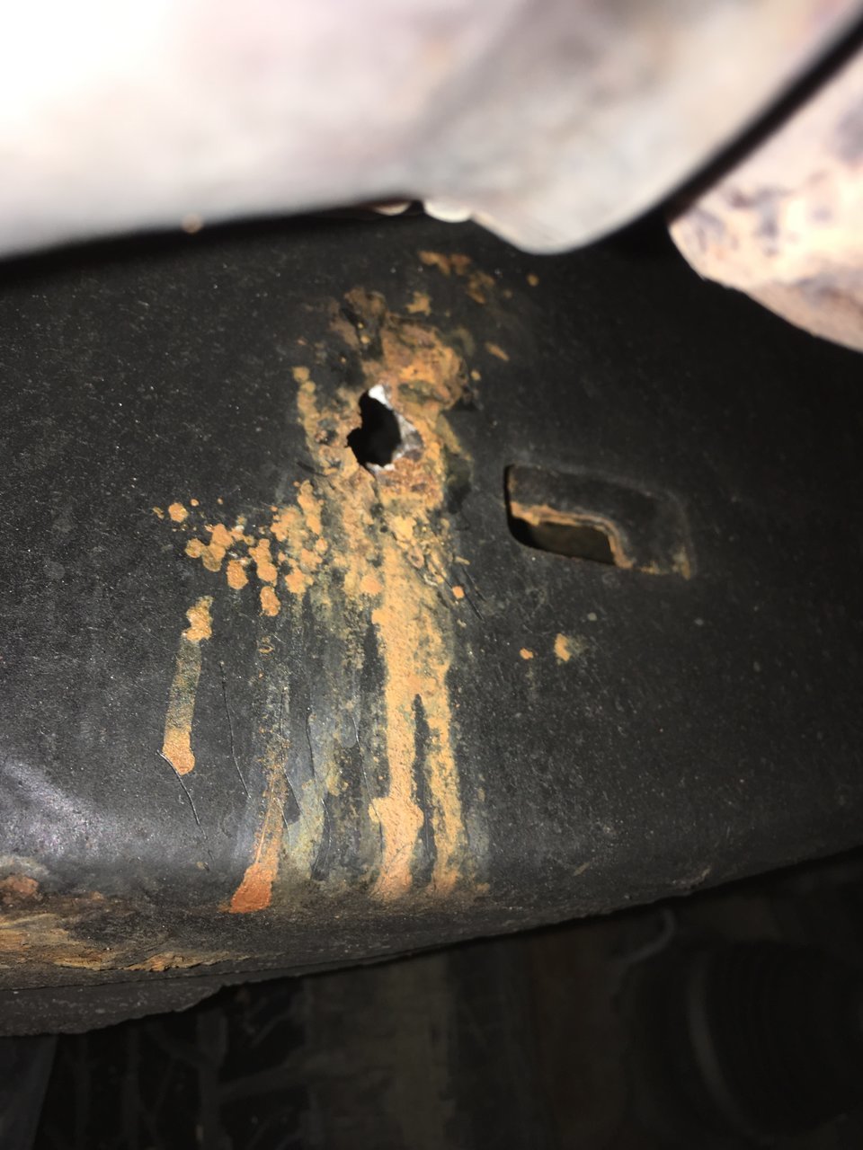

    Good for you for pursuing this. Hope something comes of it. When I had my truck inspected in the spring they didnt even undercoat it, just checked it and said I was good to go. Then 6 months later I find a 2" hole in the frame that was underneath some of the old undercoat the previous owner did.
    My truck is american so the recall that went through toyota canada got approved by toyota USA I believe. But ill be doing the frame swap through a dealer in toronto anyways.

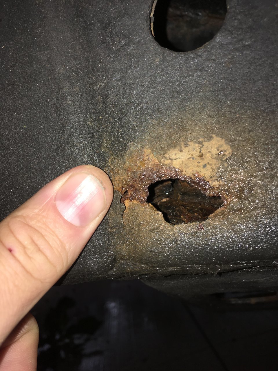

    I’m spending the morning at the stealership for the frame recall. They told me it won’t be replaced but will be covered with some type of black tar type goop and they have to put it on one day and let it sit until the next day to dry. Anyone else have this done???

    I did, two years later the frame had holes in it. My truck has been at the dealer since 10/3/2017. I called the service rep three times this past week with no response. The goo doesn’t work. It just hides the rust underneath.

    What's this stuff look like? Got some pic's? The parts on my install were all factory coated, nothing more.

    Mines definitely not like that. I saw that earlier but thought it was user applied. I've got some numbered/barcode like stickers on most replaced parts so I know nothing more has been applied

    The coating was put on at the dealer in 2014. In 2016 the same dealer found those holes in my frame.

    I don't understand why Toyota would do the repair different ways? Rust is rust, replace the damn part.

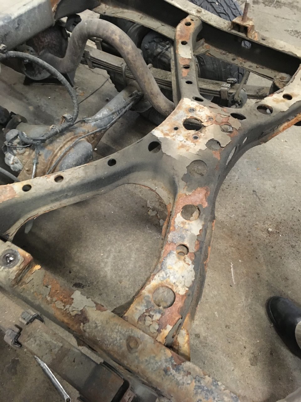

    I just showed up at the dealer yesterday because they would call me back. This is how it sits now. The CRC is obviously a joke.
    I took more pictures but for some reason they didn’t focus. It still has a long way to go. The drivetrain is still sitting in the old frame.
