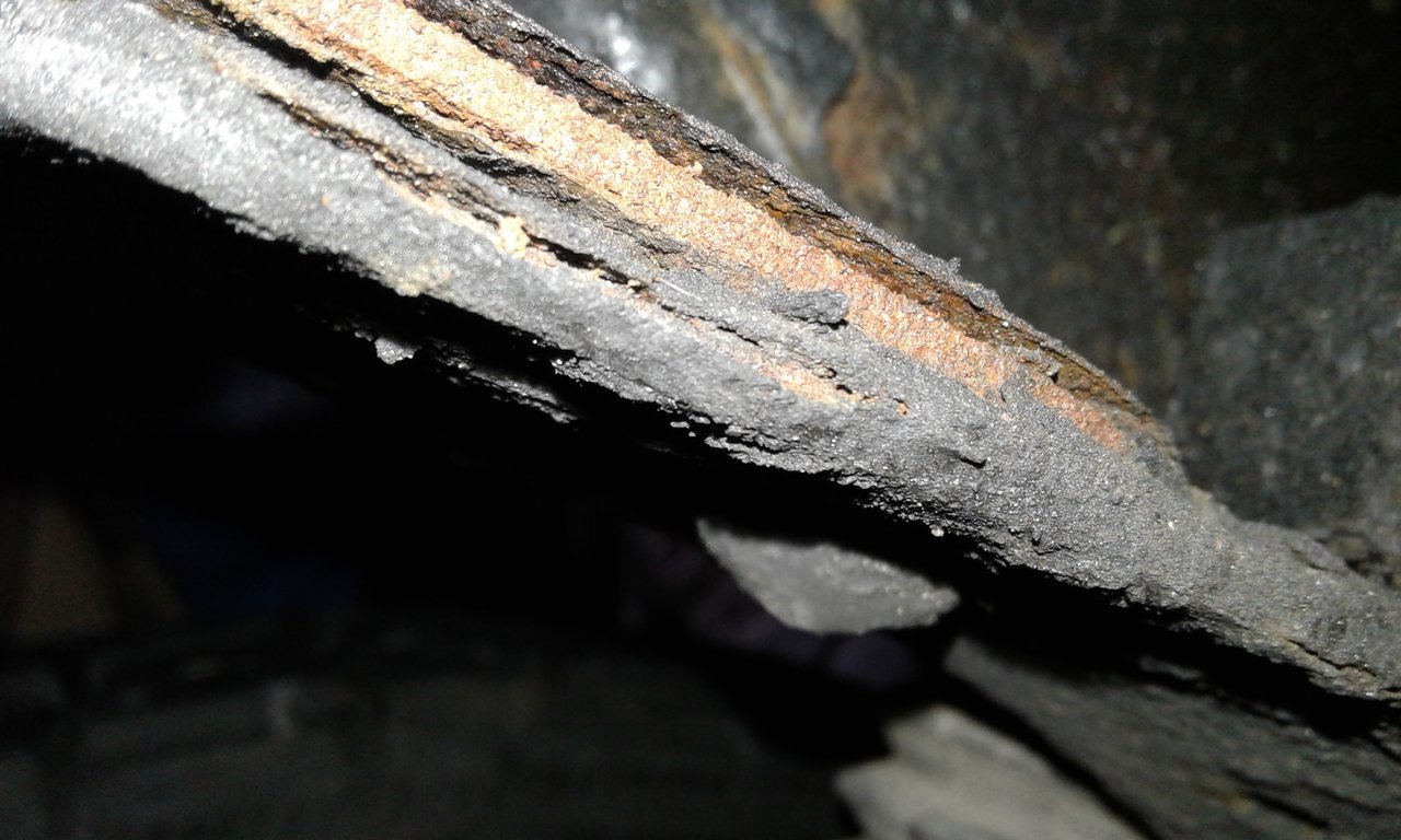

    Tdawg0
    Tdawg0 Member
    Aug 2, 2017
    #225786
    7
    Just wondering anybody's luck with their frame getting replaced because of their frame rails separating. Mine passed the inspection, then I found this. Going to a different dealership to see what they say.IMG_2979.jpg
    lynyrd3 likes this.

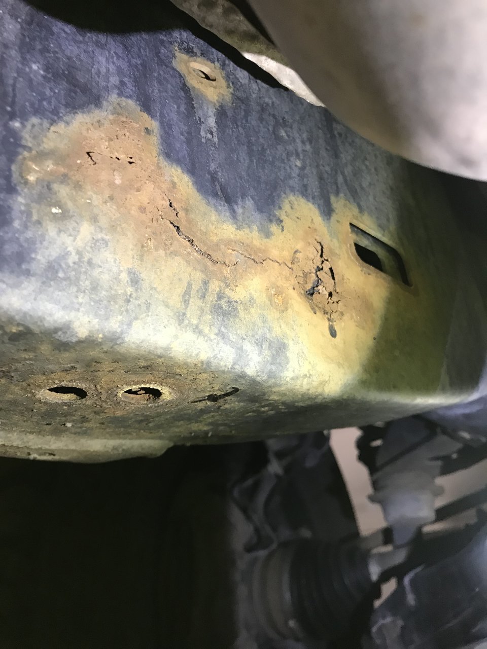

    fixnfly
    fixnfly Well-Known Member
    Oct 1, 2011
    #64450
    751
    S.W.PA
    05 Access cab 4.0 4WD
    Here's mine.
    I have not taken it in yet for an inspection, waiting till the salt stops flying.
