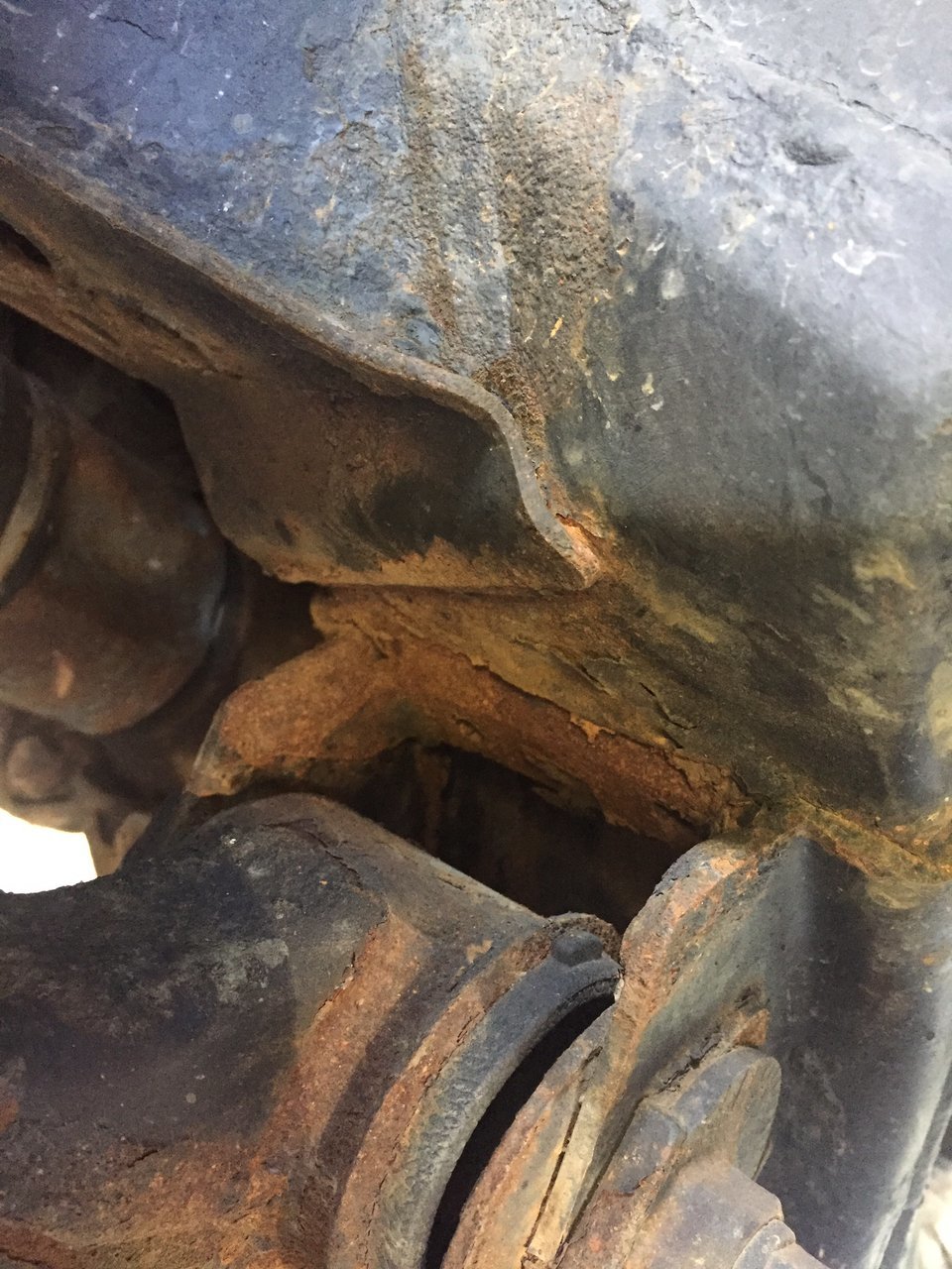

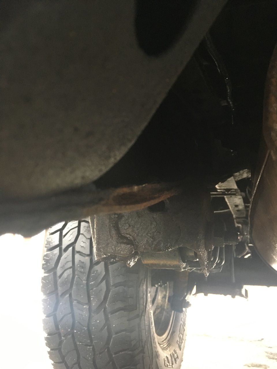

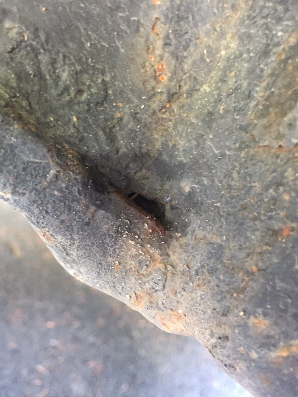

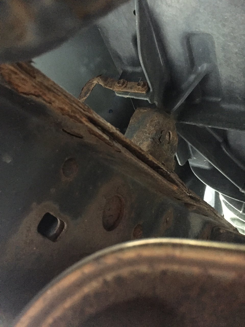

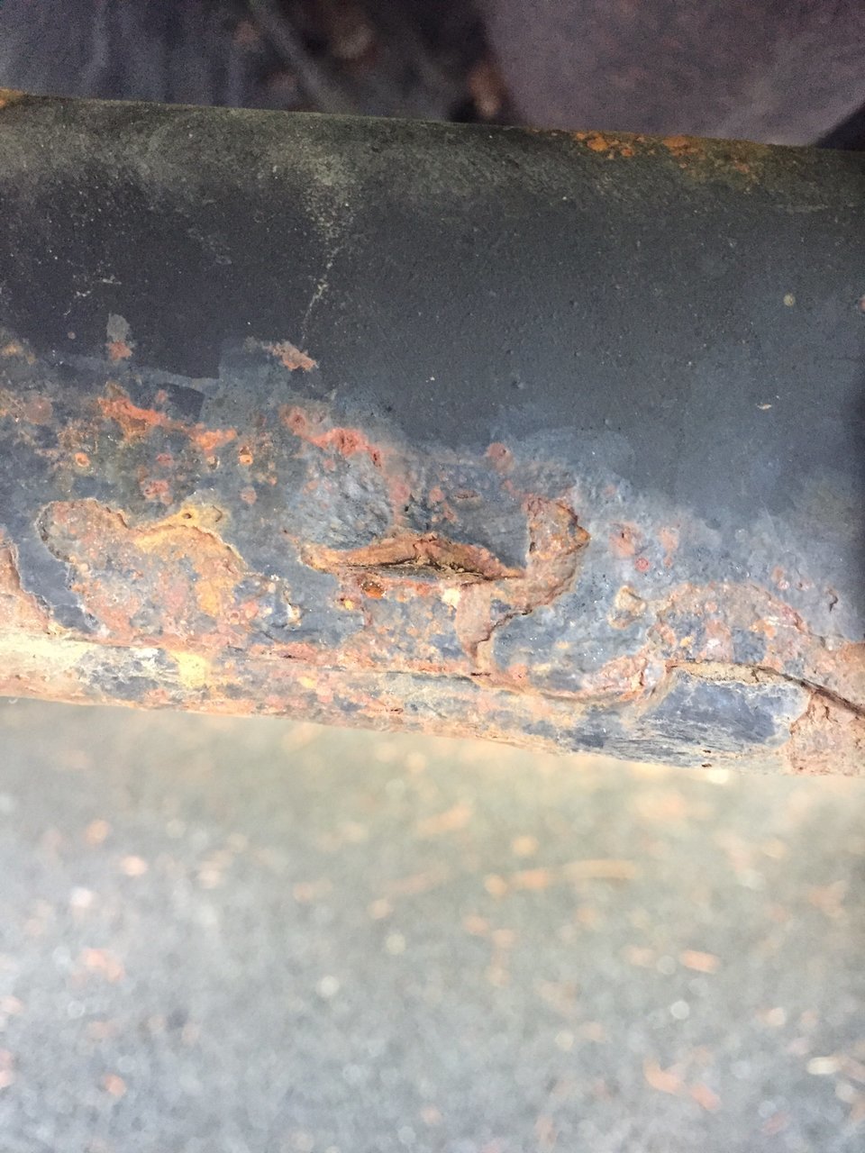

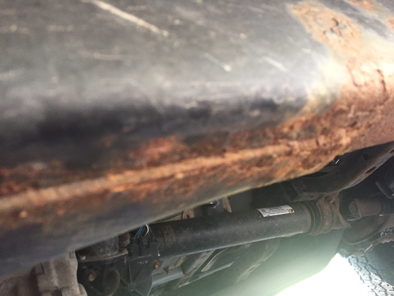

    Mine is the same and they passed it . Dealership said that was normal !:mad::annoyed:

    Mine looked like that also they said that does not fail (delamination) only a hole is 10mm or bigger.
    ANYONE TAKEING A TRUCK IN FOR FRAME INSOECTION crawl under your truck,passenger side where the frame comes down and goes back on the inside. Get a ball peen hammer and give the frame some taps if it sounds dull give it a harder hit. This is toyotas procedure. Give your self piece of mine weather you a good, bad or maybe.
    It's YOUR truck you are allowed to hit it with a hammer if you want.just my .02
