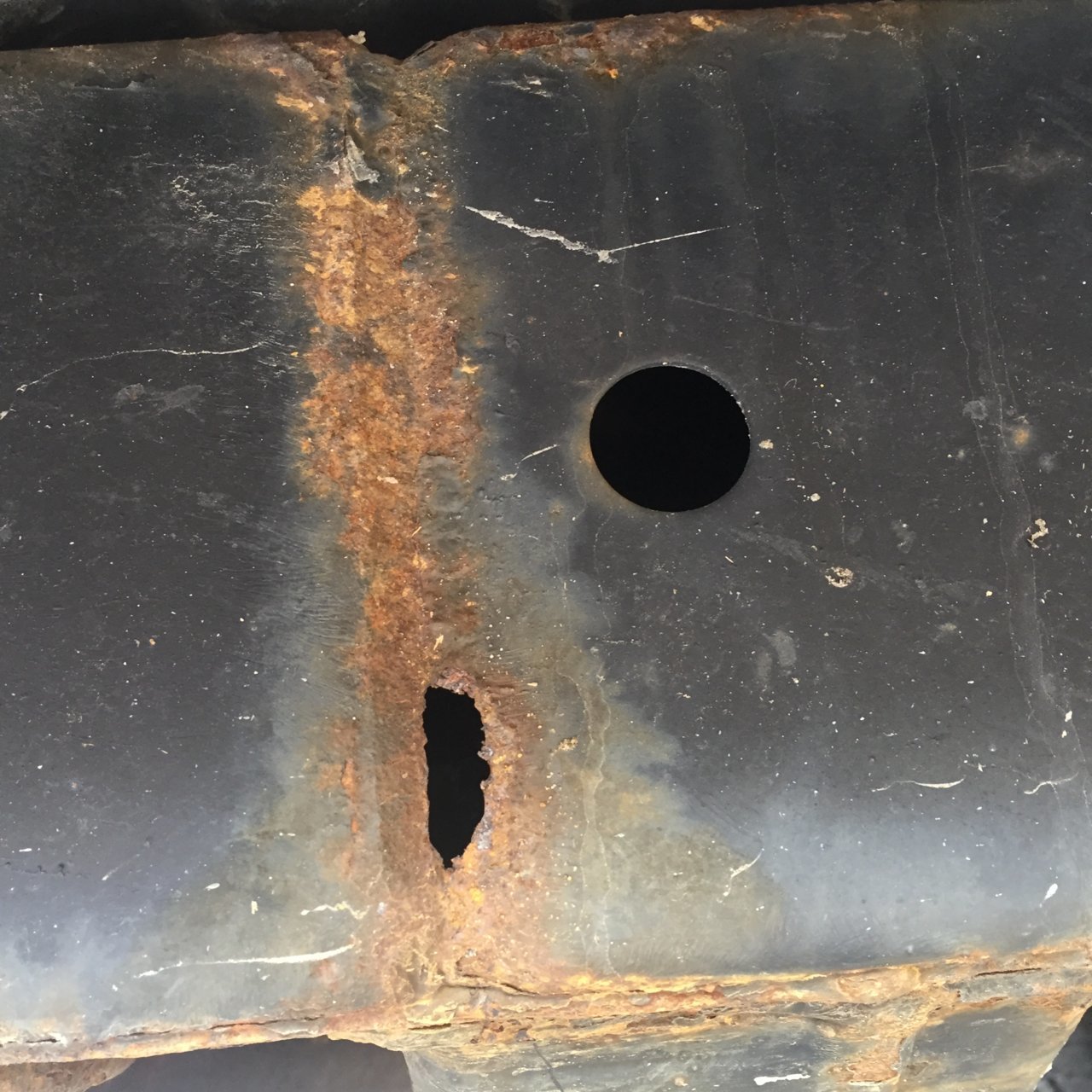

    Did they spray your frame instead of replacing it and then it really fell apart .

    That's what happened to mine originally now there are a couple of good sized holes and my frame is on order. I am excited for a new frame.

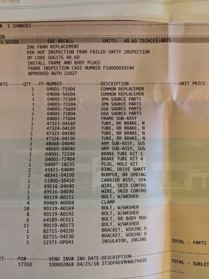

    That's BS they replace everything and have to transfer all your old struts over, sway bar, etc. You'll get new LCAs cam bolts and the like. My dealer did mine without fuss really. I think your dealer is just not wanting to do it.
    Here is a parts list break down of what they are replacing now a newly updated version now vs. what they were doing before. Or that's what I was told. Everything else that isn't listed is taken off of your old frame and put on the new one.

    Thanks for forwarding that parts list, by the way. I’m much obliged.
