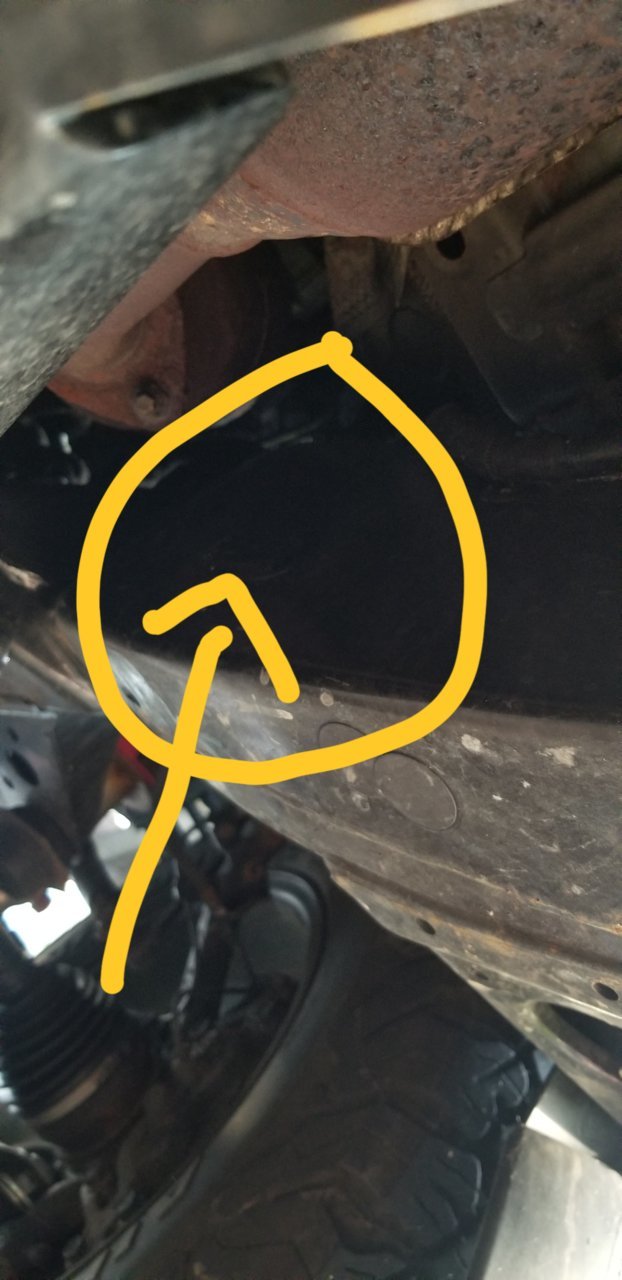

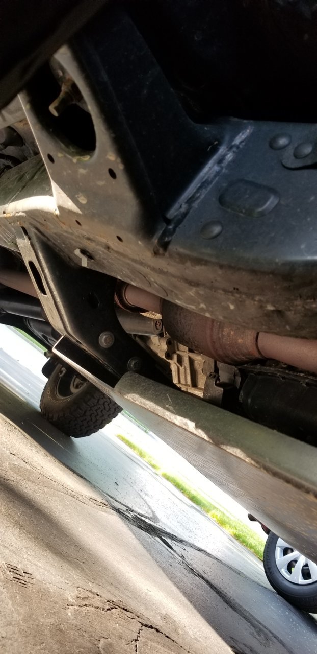

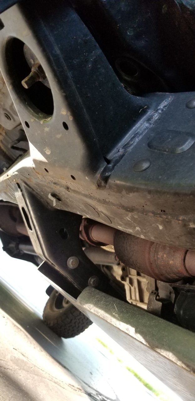

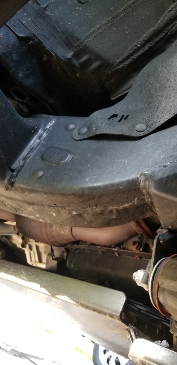

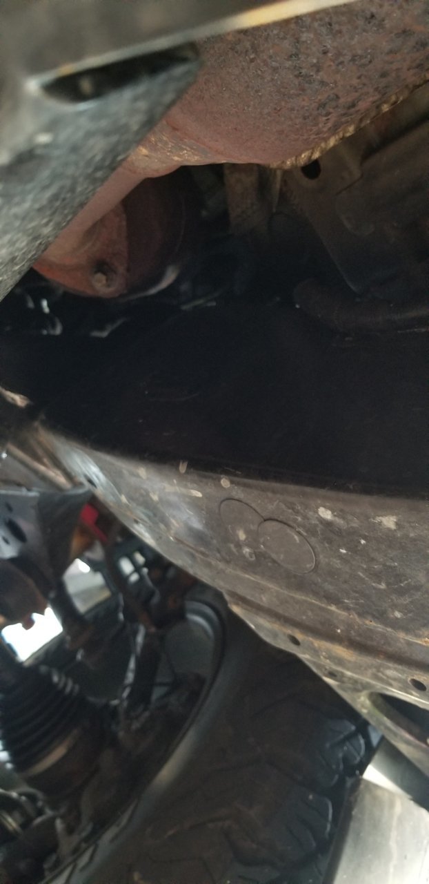

    I'm sorry, but I can only post the picture come Monday. I switched cars for the weekend at work. I tried taking the picture this morning, but realized I'll need to jack the truck up to get a good picture. I've got armor currently obstructing the shot.

    where is the spot that they easily poked through?

    If you're under the truck and find the catalytic converter... look adjacent to it by the frame. Water apparently pools in this area and rots the frame from the inside out... same area on the left side too. It was explained to me the problem predominantly persists here, facing toward the catalytic converter.
    It might look perfectly fine on the outside, but if you wire-brush or slightly angle grind the paint off and use a punch or Phillips head screwdriver (solid core)... and a couple taps of a hammer... it might pop through... that's all you need to qualify... this applies to any part of the frame you can punch through actually. Good luck!

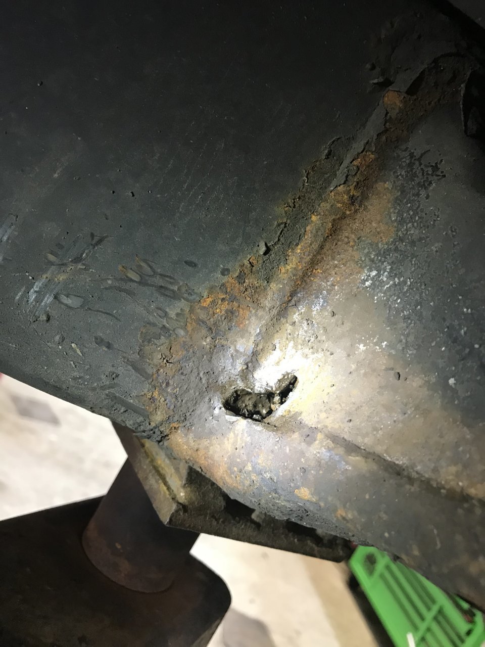

    I took mine (09) in a few months ago for drive shaft u joint recall. When I made the appointment the lady asked if I wanted them to inspect the frame while it was in. I said no because I did not want them inspecting it and putting crc on it. Basically I have until 21 Feb. 2021 and I'm in no hurry. When I took it in the service manager said we are going to inspect your frame for rust don't worry it won't cost anything. I did not argue with him. After inspecting it he said they were "able" to punch a hole through at one of the key spots on the frame but it was not 10 mm. He told me to come back in 6 to 9 months and by then the hole would be big enough and I will get a new frame. He never mentioned crc and I did not ask about it. The whole crc thing has me nervous thinking Toyota might reject a new frame because I never got the frame crc'd. I plan on taking it back before 21 May 2019 for a new frame.
