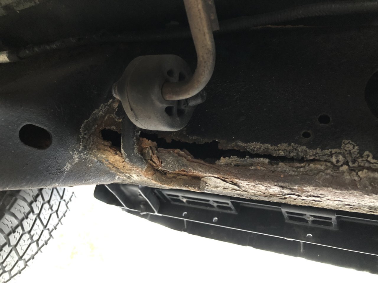

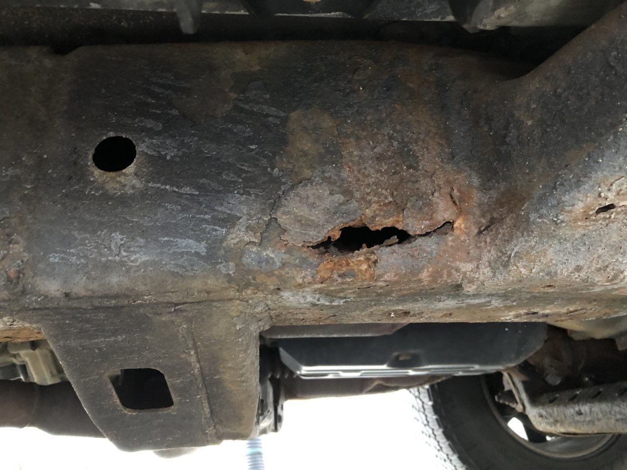

    New here so hopefully I’m not asking something that has been covered. Two years ago I helped my son buy a 2006 Tacoma, had 101k on it and looked very nice. The owner gave me the service records and he said one of them was to have the frame inspected. The receipt said it passed and they installed a CRC coating in mid 2014. Well today we were putting on some 2017 step bars and I noticed two significant holes in the frame! This got me to researching the web and found this thread. Does anyone know if they offer additional warranty if the dealer inspects and say’s its good but then large holes are found less than 5 years later? We felt good about it at the time we bought it and didn’t have a reason to check it again.

    For the 2006, the time to make a claim was 12 years from the in service date as was detailed in one of the posts above. There was an extension to the warranty that came in via postcard from Toyota which extended the warranty until the end of January 2019. If you missed that date, you might want to contact Toyota or a local district rep. From past posts in this regard, individuals have not been successful making their case, but you never know...

    Thank you for the response. The frustrating part is the previous owner said he had it inspected and the dealer found no issues. I didn’t think there was a need to have it inspected a second time. Clearly the frame coating cover up is just that, not a real fix and unfortunately I found out too late.

    I have an 06 that my daughter drives. I bought it out of Wisconsin but the previous owner had it coated and inspected. Bought in Feb 18. Inspected by a dealer here in SC in May 18. Passed with flying colors. But there was a ton of surface rust. I got the post card in October. Didn't do anything until I read a post here in December about an issue with the frame. So I knocked on it to see what the sound was and a long crack opened up. Outrigger body mounts were rusted through, so off I go on 3 January for the inspection. After 4 weeks in the shop plus time waiting for a frame, it is now at home.
    This doesn't help you though and for that I apologize.
    Doubt the law firm will do anything. The order has been entered and they've been paid. Unless there is a contingency clause in the settlement.

    Here is a pic of the damage we found. That’s a lot of rot in just over 4 yerars if it “passed” according to the dealer. And the coating clearly did nothing and might have even made it worse.41F094B5-5630-4086-89E3-2BA87120439D.jpg2F0FAB42-EFAC-4E4F-A24B-ED761CC1283A.jpg41F094B5-5630-4086-89E3-2BA87120439D.jpg2F0FAB42-EFAC-4E4F-A24B-ED761CC1283A.jpg2F0FAB42-EFAC-4E4F-A24B-ED761CC1283A.jpg

    Pretty bad! Go through an appeal process and see what happens. It won't cost you anything!

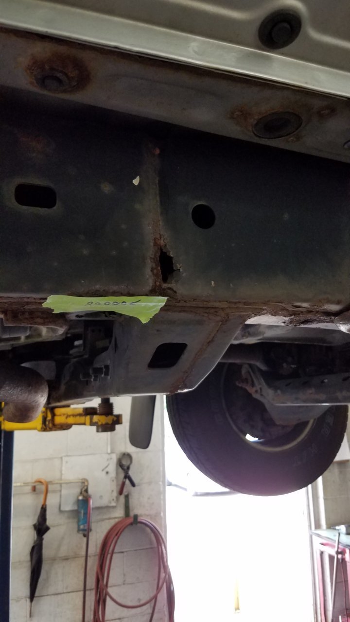

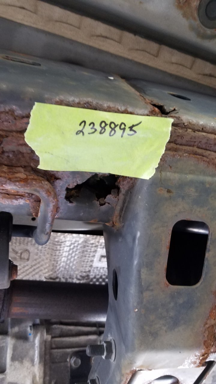

    2009 gets dropped off tomorrow. They say 2 weeks.20180824_112622.jpg 20180824_112612.jpg
