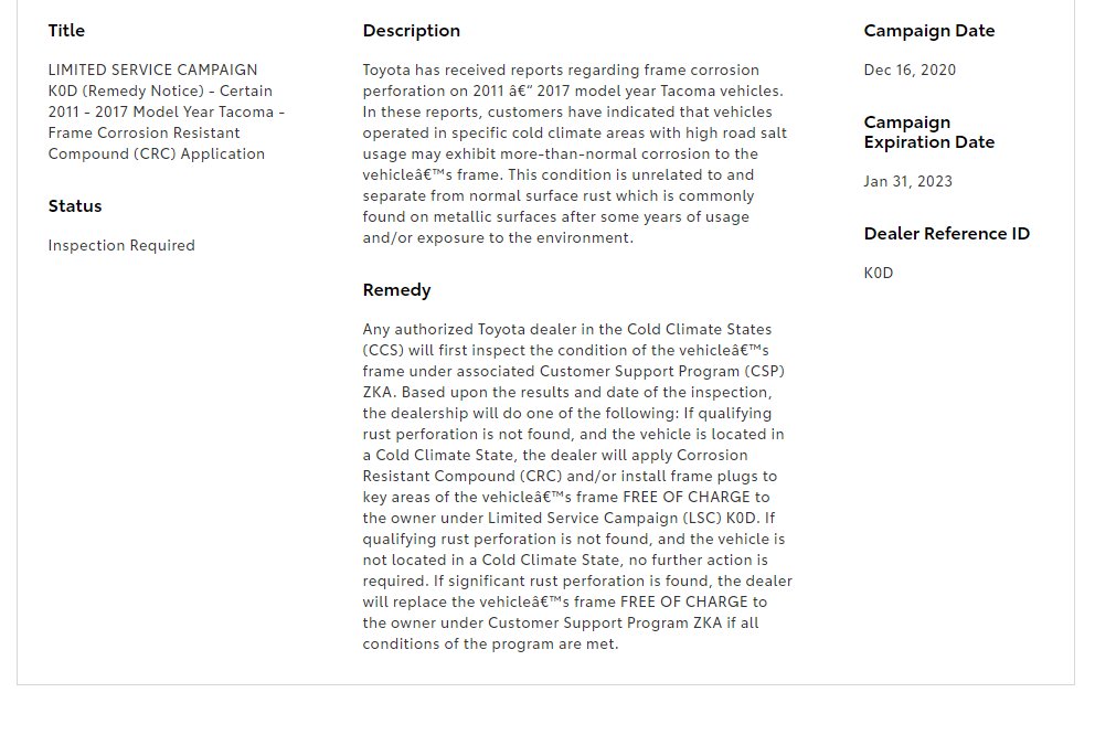

    I didn't get a letter but I looked at my owners page on Toyota.com and this recall just popped up. I called my dealer and they will do an inspection with my next oil change. He said they have to inspect the frame first and then they will set me up to do the CRC coating. He said they are backed up about 2 months on the CRC applications. Truck is going in this Saturday for an oil change and the inspection. The frame has had some sort of coating done before. It looks like a rubbery/tar type of coating if that makes sense. It definitely was done long ago. Truck has lived in the northeast since new but I crawled under again last night and other then some typical rust, the frame looks pretty good. I also did see a few plugs in the frame up where the cats are.
  7. Jan 5, 2021 at 1:12 PM
    #27
    fourfourone
    fourfourone Well-Known Member
    Mar 12, 2020
    #321977
    3,179
    2015 TRD sport(sold) 2023 Tacoma
    This is the recall.

    Looks like Toyota went back to 2011 for this campaign, just another reason I'm glad my 2006 have been given a FF coating similar to how Toyota is applying their CRC to the frame annually since 2014.
