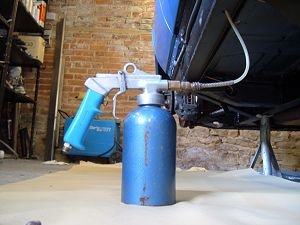

    I had several 2nd gen pickups (89-94) and those 22re's far outlived the frames provided you swapped out those doomed plastic timing chain guides for aftermarket steel backed guides. On one '93 frame, I cut the entire inside of the box frame out which showed that half to 3/4 of the box frame was stuffed with sand and rusty flakes of steel. Doomed! This condition only persisted between the transmission support and the rear of the truck, all of the frames were generally clean from that support to the front. Those frames had little 1/4" holes drilled in the bottom for drainage. They don't work to good when they're plugged. After that, I starting parking the truck on a steep incline once a year and flushing the frame out best I could with a pressure washer.
    The box frames are destined for failure due to their design, it's a closed in box :) the good old C-channel frames stay flushed out a bit better. Gotta keep the box cleaned out so they can drain and if you want the preventative oil treatments to get where they need to be to work but that's only for a dying breed like me who wants to get 25 years and 1/2 million miles on my truck before I can say it's a good truck.
    Run water through the frame until it's coming out those drainage holes. Make sure you drill holes in those rockers as well and lay the oil to it! The good old Shutz gun is all Toyota's best friend.

    I look forward to ATremblay answering as well but I thought I'd throw my 2 cents in as well. I've bought gallons of Fluid Film and gallons of undercoating from Napa. I love Fluid Film and use it religiously in other applications but I far prefer the Napa undercoating. Gotta be careful not to let it build up to much over the years though, it turns into a hard 1/4" layer that's dry on bottom where it will delaminate from the metal and let moisture creep in.
    I use a Shutz gun on a 30 gallon 5hp Craftsman compressor.

    I have the same gun, 3' flex wand with a 360degree tip, 2.5' flex wand with a 90 degree hook tip. Put over 1/2 a gallon of rust check on my new frame and rest of my truck when I got it back from frame replacement.
