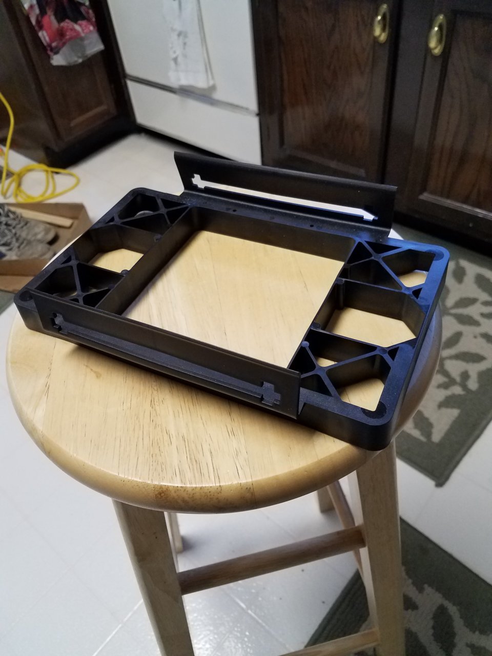

    What trays are people using to put a group 34 in the factory position? Most of the dual setups are for 34s but if I go with the split setup later, what tray would hold the one in the factory spot?

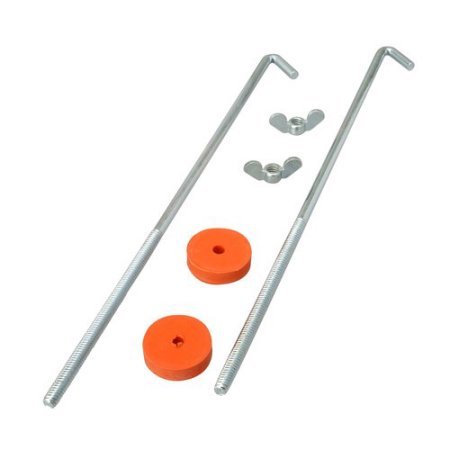

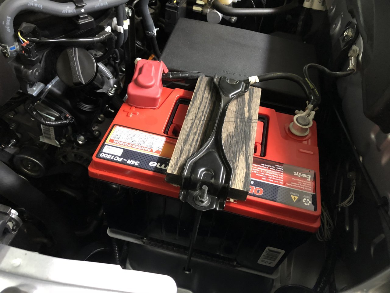

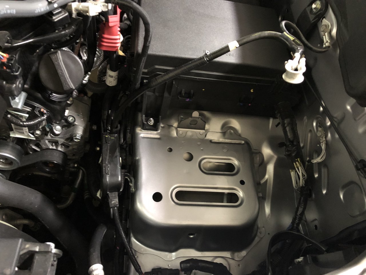

    Well I took a two hour lunch to put in the Odyssey Battery, bed hooks and finish the Choas bed stiffeners.
    After removing the stock battery I realized there’s no way I’m attaching the Odyssey stainless steel battery cage unless I weld it, but then it’s stainless to painted metal and what if welds break, etc. Measured each battery and the Odyssey is about 3/4” shorter than the stock battery.
    So, I used my mad woodworking skills and cut and stained black a piece of 3/4” oak so I can use the stock brackets. Works perfect and doesn’t corrode. It bolted down just as secure as before, even put a thin piece of rubber between the battery and the oak and under the two battery holds so nothing moves.

    If you ever feel like revisiting it, getting the rearward J hook out isn't that hard with a dremel and cut off disc. Then you could replace with proper length hooks.

    I don't know if something like this would be of interest, it is a Battery spacer. When I was with my ex gf she bought a Battery too short for her car, I stuck a book under it as an emergency fix and then got that spacer.

    Thanks and to the post before this I’ll probably just get the riser. I’m a little bummed I couldn’t use the Odyssey holder but I can return it, no worries
