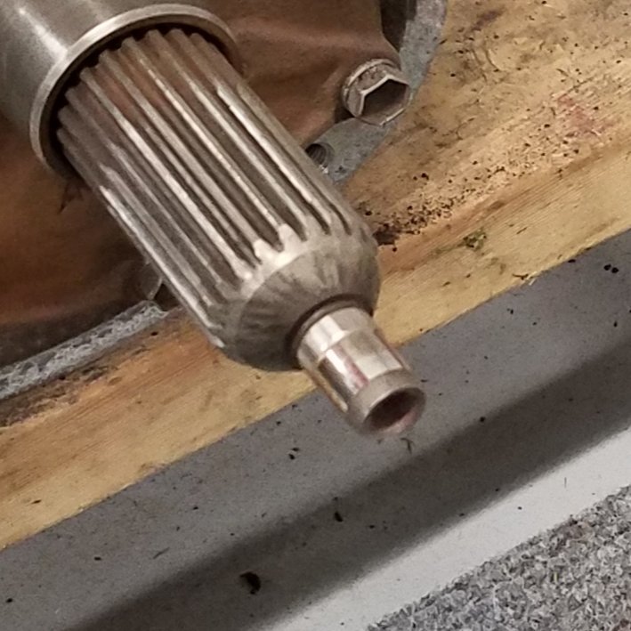

    That would be great. Below are a couple of pics of the transmission input shafts. The first one is from the R155 5spd.
    Here is the 6spd, notice its missing the end that goes into the pilot bearing.
    This is what id be most interested in knowing as it could be the limiting factor. Any info you could get would be excellent:thumbsup:

    If its a chassis designation, does anyone know the name of the gearbox?

    KUN26R uses R151F gearbox for 4x4 versions, it uses a pilot bearing in the back of the crank. The H series box is in the 70 series (76,78,79) Land Cruisers only.
