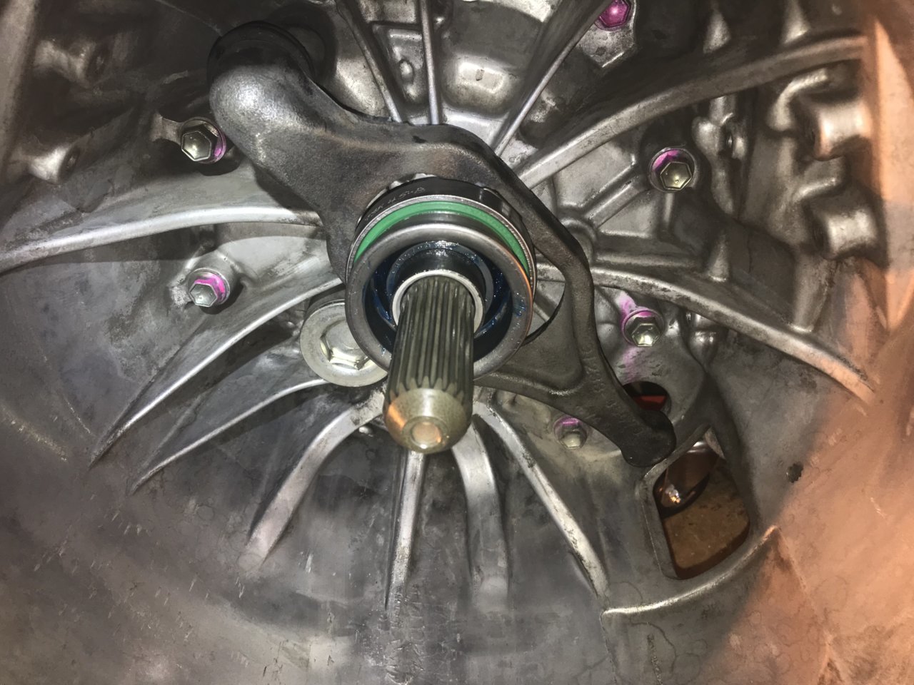

    Yes it wants to grind when shifting from 3rd to 4th under boost. If i try to do it even remotely quickly, it grinds. I am running 85w140 dino oil in it, and that seems to have helped quite a bit, but it still happens occaisionally. Just trying to get my ducks in a row for when the time comes for replacement, because i dont plan on ever getting rid of the truck

    Ahhh i know im really disappointed, id love to have a five speed in it. First gear is so low in my 6spd that it would make more sense to have a 5spd.
    Not sure on swapping the center shaft to suit my engine. Based on what someone posted in here earlier, it sounds like if there is a pilot bearing, there needs to be a place on the crank shaft to accomodate that. Not sure if i'd be able to change out a backing plate or somehting on the rear of the motor, or if the whole crank would need to be different. Also not sure if i could just cut the input shaft tip off and run it without one lol (this sounds janky af, but just curious if it'd work in theory- it's not likely something i'd do)

    I would need something without a pilot bearing/input shaft, or id need a way to modify it to make it work.
    Here is the picture of my input shaft from my RA60F 6spd. It does not have a pilot bearing, so im trying to find something that would work without a pilot bearing. If there is some way to swap input shafts, i wouldnt be opposed to that, just curious if it's even possible

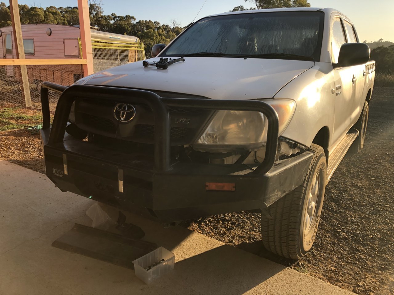

    318
    Justin
    2005 Toyota hilux v6 4.0L 1gr-fe
    None at this point
    17FC72BB-323F-4D11-86AC-8A01A257BAB6.jpg Started to fit the bullbar last night. Just need to finish bolting it on and put the plastic shroud under the headlights.
    TireFire likes this.
