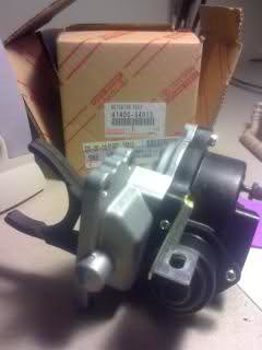

    part no. 41450-35010 Automatic Disconnecting Differential motor

    so kroggy, is this the part you did? drain the oil first right? can I reuse the oil? do I need any special tools on this?

    Yep, sure was! I thought something seemed wrong about the whole situation. I'm pissed you got that for $280, I paid $70 more than that.
    As I said before, you can definitely do it yourself. I used a really long ratchet extension to get to the top bolts, and box wrenches on the bottom. I would also recommend using jack stands, or those plastic lift things to get the truck up so there is more working room. Being 5'9" and having small hands helped me a bunch.
    Pick up some RTV silocone gasket sealer, because there is no gasket for the part.
    I would pick up new diff oil just for the purpose of you know it was done right. I'm sure you could use it again if you really wanted, but I'd rather be safe than sorry. 3 Quarts should be more than enough, I used valvoline synpower 75W-90, because I couldn't afford to spend $60 on top for royal purple, I think I ended up spending half that for valvoline.
    And one last word of advice for your install: Be prepared to cuss when trying to get the unit back into place correctly and line up the actuator with the clutch sleeve, it's tight, or remember how you got the old one out.
    Anymore questions post up or send me a PM. GL!
