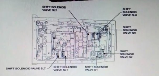

    Hey Roberto, after reading the extensive information on this site, and watching the vidieo I was led to believe that the SLU is the solenoid that controls Lock up.

    Oh wait, that makes perfect sense. S(olenoid)L(ock)U(P)
    That solenoid and the SLT fails as well. If you haven't done so already, like I said I would just get it over with and just replace them both.
