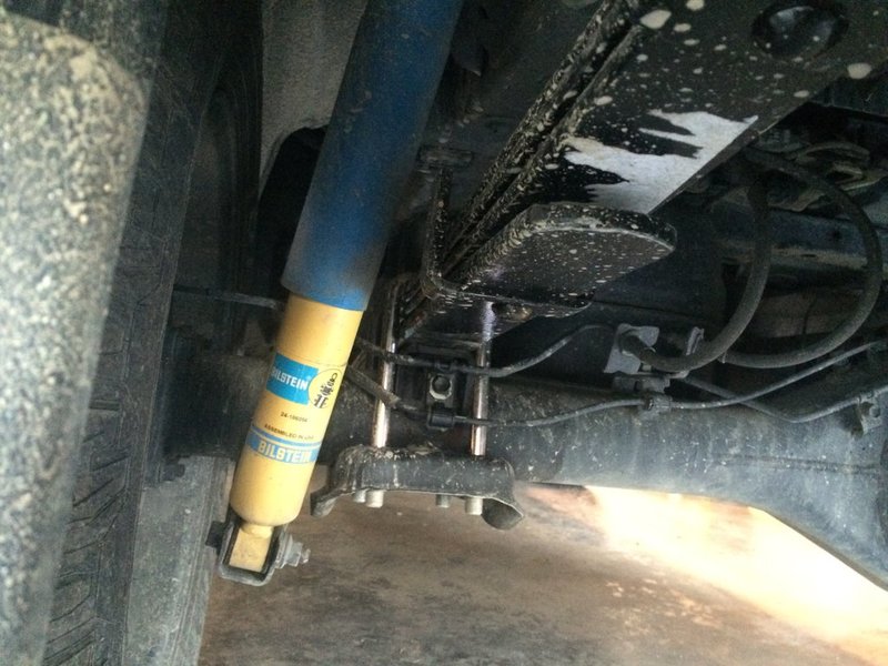

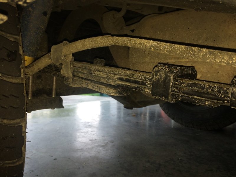

    Got the new springs put on my truck on Monday. Dealership got permission from Toyota Corporate to put them on prior to the 2016 rollout stated in the latest recall letter. Springs are a huge improvement. Axle wrap is greatly reduced, but not entirely eliminated. That being said I don't have much to compare them to. When I bought my 2005 Tacoma last year the springs were worn out, and they got progressively worse over the last year and a half. If I had driven a Tacoma with Deaver, Alcan, All Pro, etc. springs in the past I would have something to compare them to.

    are those the original shocks?

    I upgraded to Bilstein 4600 shocks earlier this year.

    They don't appear to have much arch in them :goingcrazy:

    Don't really know how much they are different. I'm assuming that since the old ones are recalled, the new ones should be different, but only time will tell I guess.

    You're right they don't have much arch.

    Do your new leafs have a sticker with a part # on them? I'd like to compare part #'s with the leafs they just put on mine a couple months ago.
    Edit: I didnt see a couple posts above 08trdoffroad asked for the part #'s and in the first pic, I see where there might have been one ripped off.
