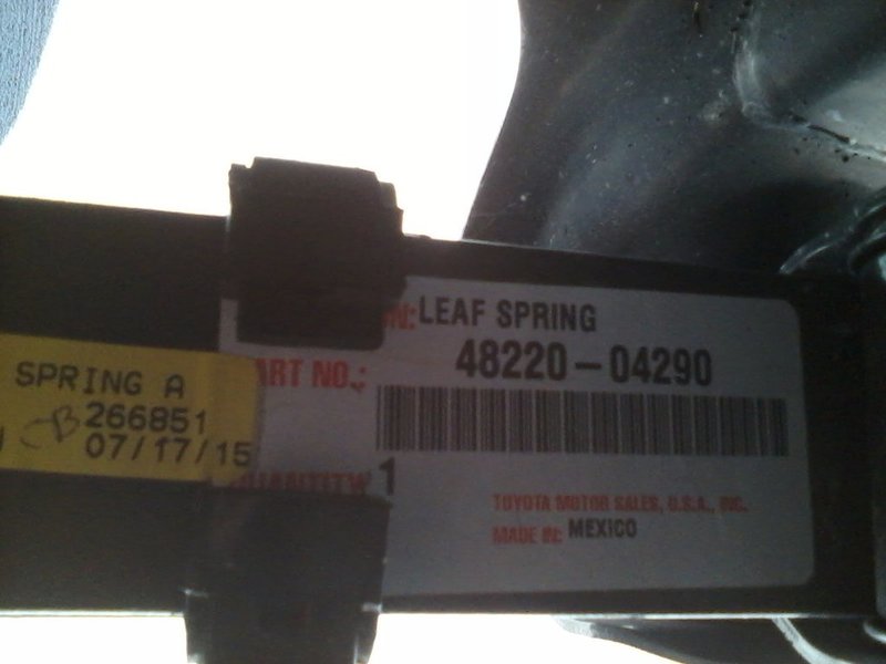

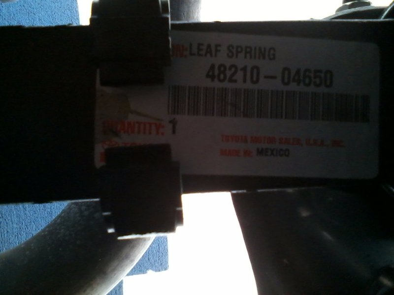

    Not the same part # as mine from the frame replacement. I've got RH side 48210-04650 and LH side 48220-04290 on the parts list, I can snap a pic when I get home from work.
    The only difference in the trucks is you have the TRD package and mine is an SR5. I dunno if that would matter or not.

    Here are the part #'s I got put on with the frame replacement on 8-18-15. I cant find why yours would be a different # though.
    Drivers Side:
    Passenger side:
