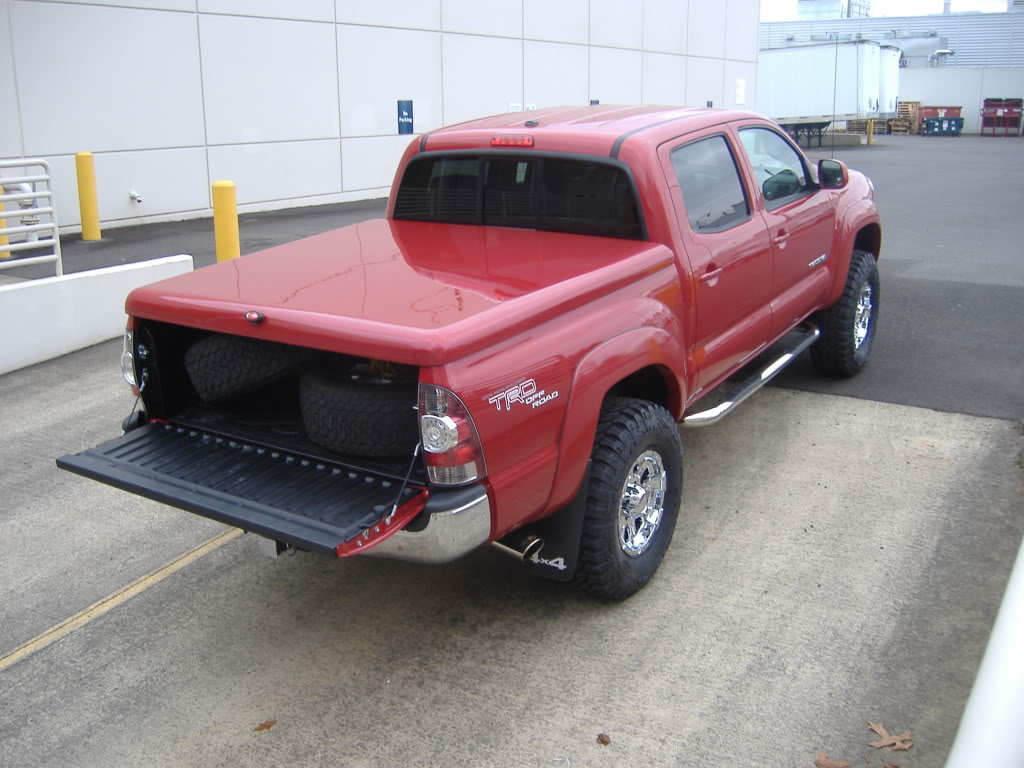

    Here are some updated pics. I have installed the hood scoop, fiberglass tonneau cover, painted mirrors, painted door handles, eyelids. The door handles are easy to install. I was really worried about the door panels and removal. They ended up taking about 10 minutes to install. They add a nice touch to the truck. I would recommend anybody to put them on. Not very expensive either.

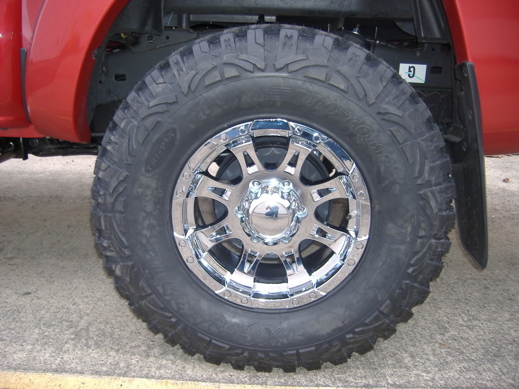

    I ordered 16x8 Raceline Raptor wheels in chrome, and 285x75x16 Pro Comp Extreme Mud Terrain tires. I also ordered Nerf bars. I will install the bars this weekend. The lift and tires and wheels will be installed on Wenesday.
    I will post up more pics once they are done too.

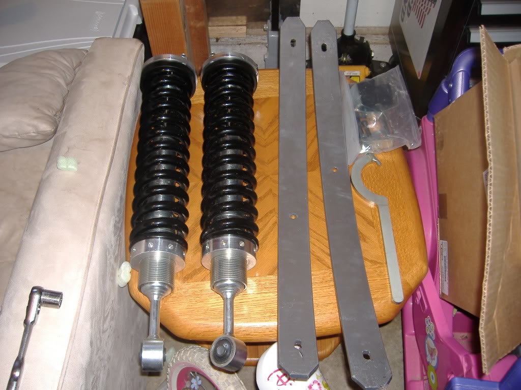

    This is the Downey Kit that is getting installed on Wenesday.

    Really nice truck! I'm jealous of the supercharger!
    Nice coilovers too, although I didn't know Downey suspension was still in business; but maybe I am thinking of a different company.

    You nailed it. Downey dosent exist anymore. I found the former owner Jim selling off the rest of Downey's inventory on ebay. I picked these up from him there. He said he didn't have anymore of the coil over kits, I got the last one. But he had a butt load of AAl springs still in stock. He is a really nice guy and easy to deal with. He goes by Tojo products on ebay if anybody needs anything. I has alot of random shit on there for sale as well.

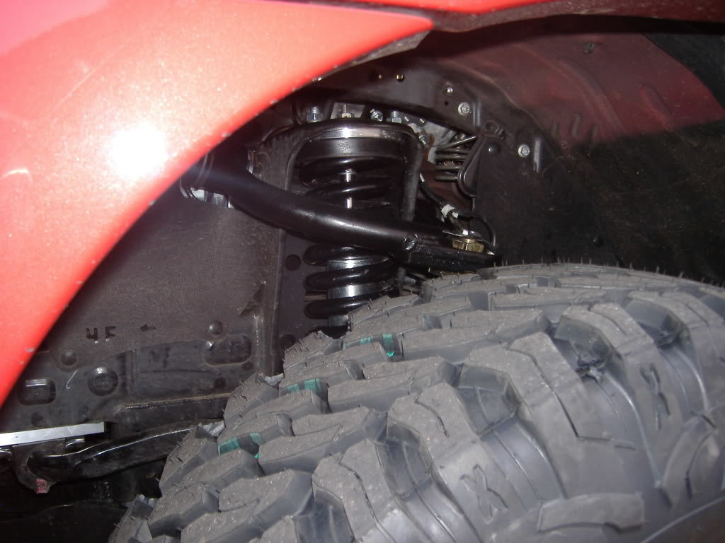

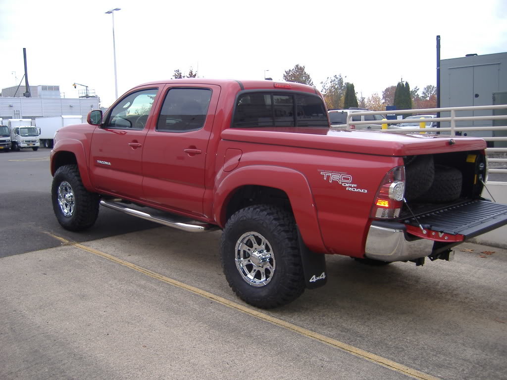

    Here it is finished. I picked it up about 2 hours ago. They did a really nice job on the lift installation. The lift did firm up the truck slightly. I really wanted to firm it but not have it harsh. This kit is perfect. Here are some pics for everybody to look at.
    I lifted the front with Downey Coilovers, this included Bilstein 5100 with a custom threaded sleeve on the bottom of the shock with Eibach springs. I also installed diff spacer, sway bar spacer from Toytech
    I also installed Light Racing Front Upper Control Arms
    The rear end is using Downey add a leaf and Bilstein 5100's back their.
    The wheels are Raceline Raptors 16x8 with 4.5" back spacing. Tires are Pro Comp Extreme Mud Terrain tires 285x75x16
    Driving forwards there is no problem with hitting anything. I did end up trimming the back part of the fender flare. However when I am backing up and at a full lock I do make contact with the body mount. I may trim the body mount and weld to take all contact away.
    The topper is a "Glasstite" tonneau cover, the step bars are from "Big Country"
    When the truck was in the shop to have the lift installed they finished the clear bra on the hood and mirrors. They also clear bra'd my eye lids.
    I have also started selling the eyelids painted to match your truck. If you look in the sale section I have a thread started there. If anybody is interested your welcome to stop by and let me know you want to be added to the list.
    Enjoy!

    nice rig i love how tall your truck looks what did you set the CO's at 2.5?

    CO's are set at 0 with the threaded Downey sleve over the top of that notch. The springs are Eibach springs and then there is a 1/2" spacer plate at the top of the spring. It actually drives and rides better then it did stock. The rear is a Downey add a leaf 2" and it is a little firmer but again drives extremly nice.

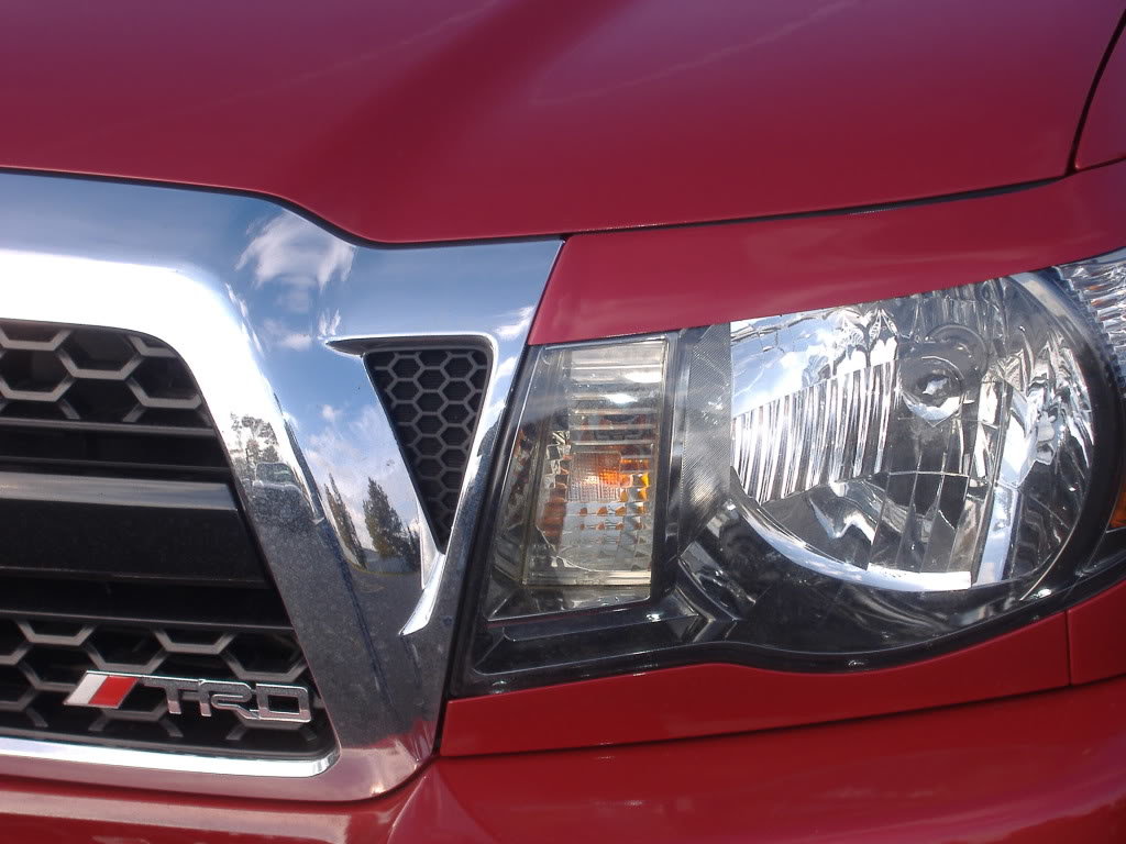

    Well, I bought my homertaco satoshi tonight. Painted to match surround and polished and cleared center section. I hope it comes out looking nice.
    I have started a group buy for painted eye lids as well. Got a body shop, might as well use it. If anybody is interested, you might cruise on over to the sale section.
    If you need something painted just let me know and I will see what I can do!

    Here is the newest mod. I put a homertaco grill and hood scoop matching kit.
