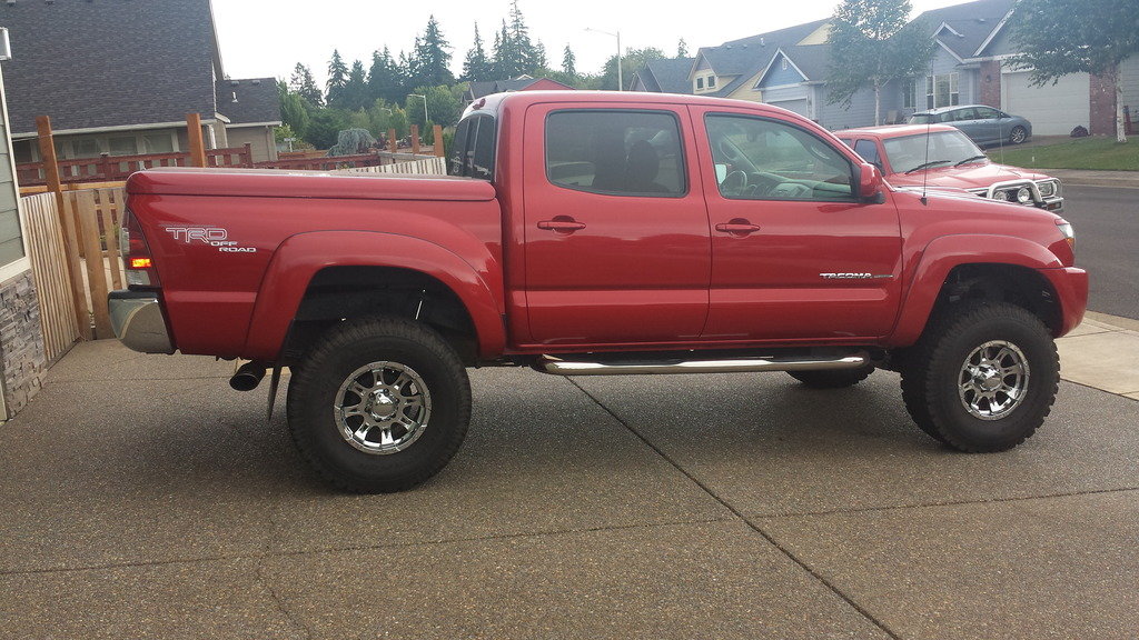

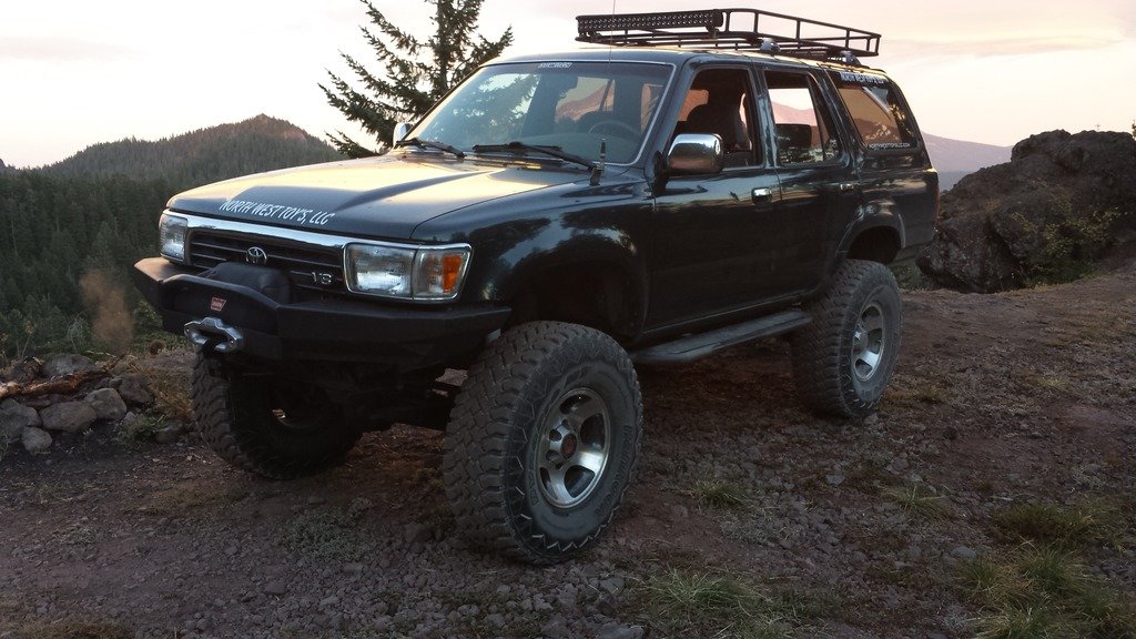

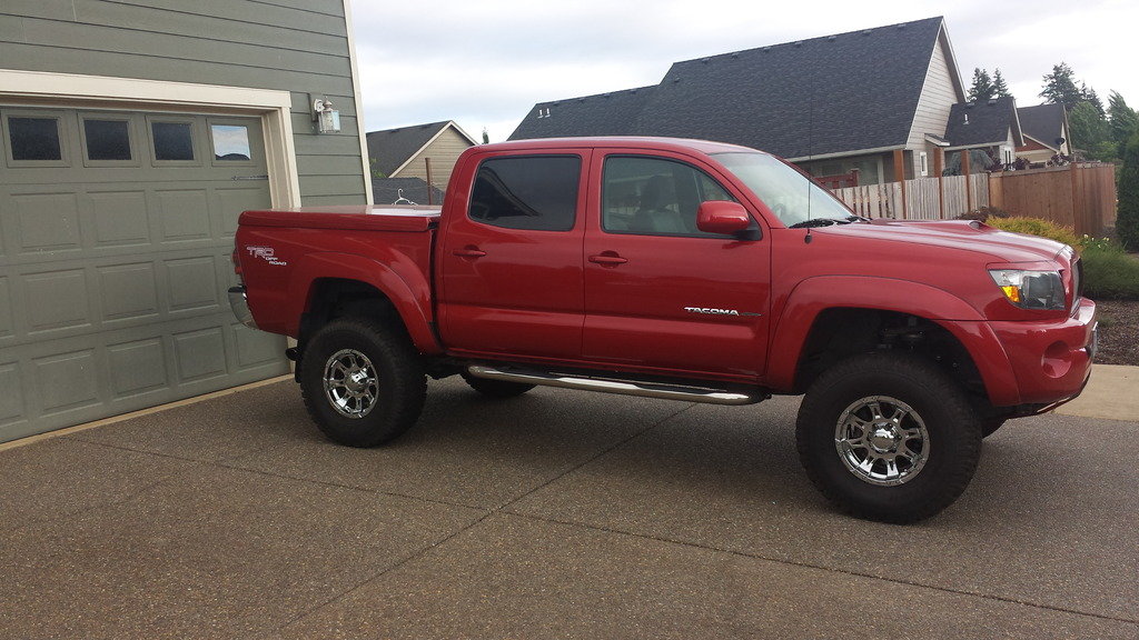

    So here is what I went with for tires.
    BFG KO1 tires in a 295x75x16 on the 16x8 Raceline Raptors. These fit nicely on the 4" lift kit. For this lift I used the add a leafs I was using on my other lift and then added the 2.5" blocks that the kit came with originally. I retained my Downey coil setup with spacers right now. I do have a custom set of coil overs on there way that will replace any spacers for this lift.

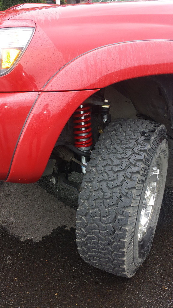

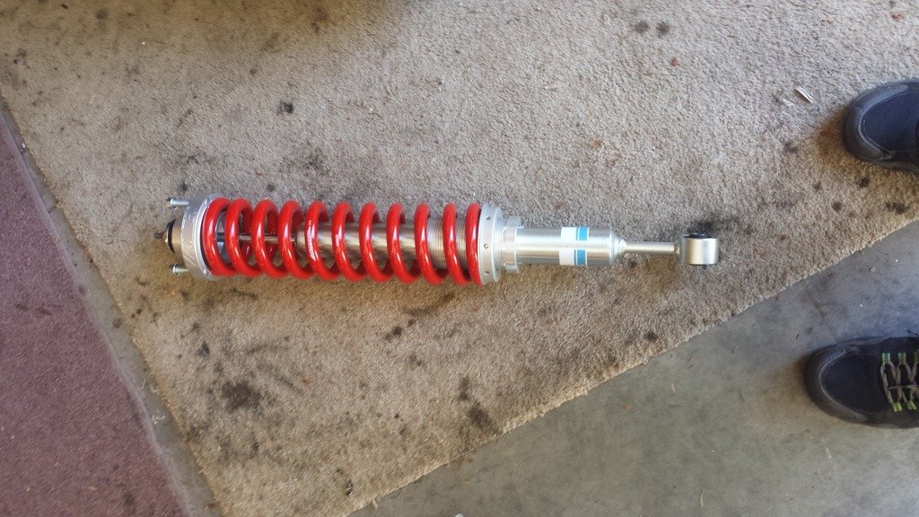

    Also got the new Coil overs from Toy Tec. Should get these installed in the next week or so. Strut spacers are gonna be in the scrap pile soon!!!!

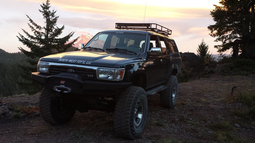

    Went for a ride last night to see the sunset.

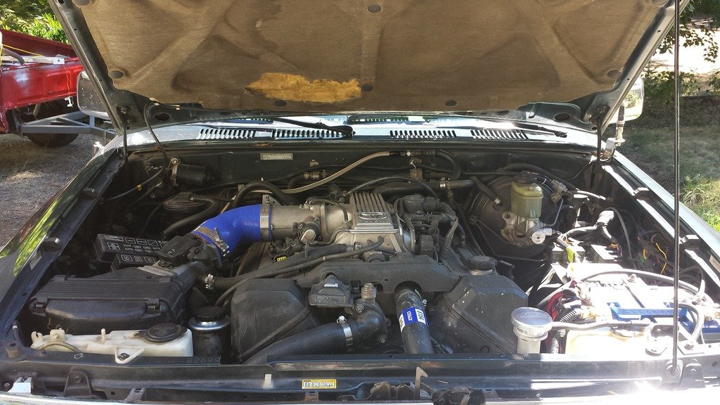

    Obligatory V8 pic

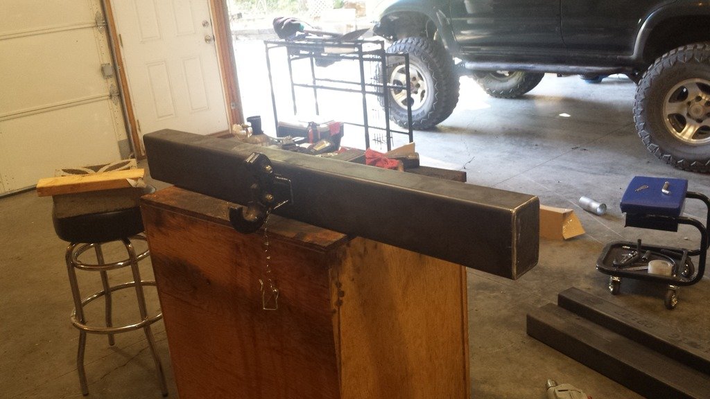

    Took the rear rock snagger off the 4runner. Started building a rear plate bumper for the rig. Center section is done. I still need to fab up the bolt in place side wings, but making good progress!

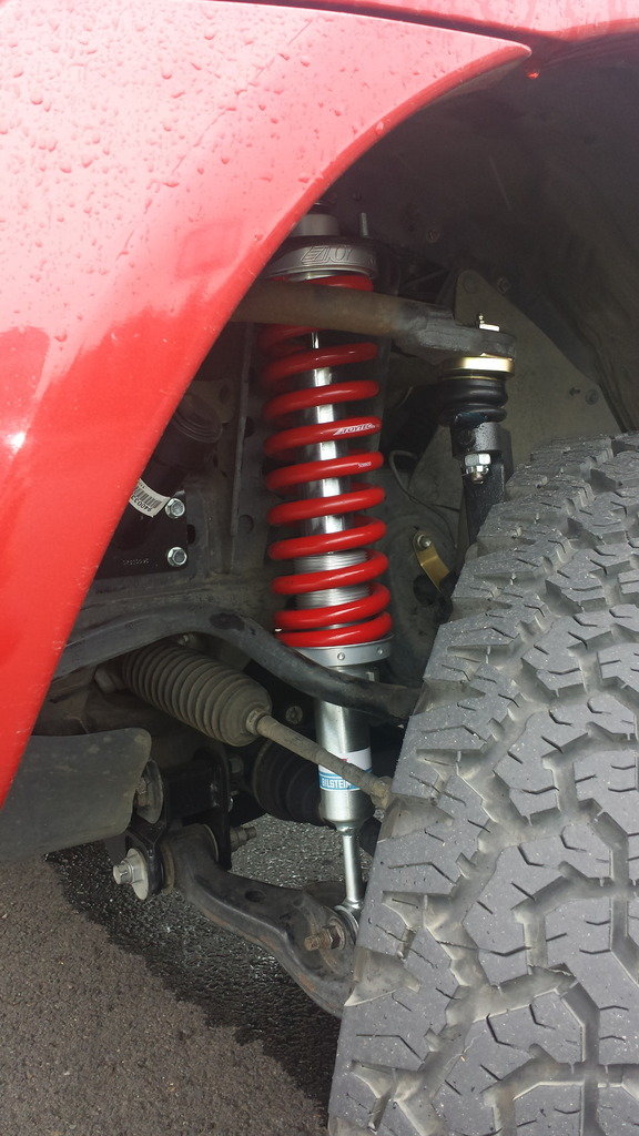

    Got the ToyTec spings and shocks installed. They went on great and the handling is so nice!!!! Also installed the replacement ball joints for the Light Racing upper control arms.
