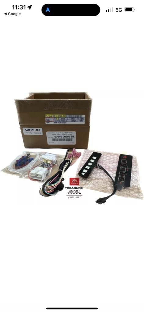

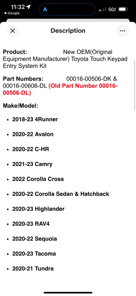

    My buddy has this on his 2023 3rd gen TRD Pro and it’s super convenient. It mounts just inside the very left edge of the windshield and operates with a touch thru the glass. Found it on eBay but doesn’t show as compatible with 2024+. Has anyone had any luck or tried an install to see if it works? Would be great to be able to lock up w/out carrying a smart key while biking, running, or whatever.
