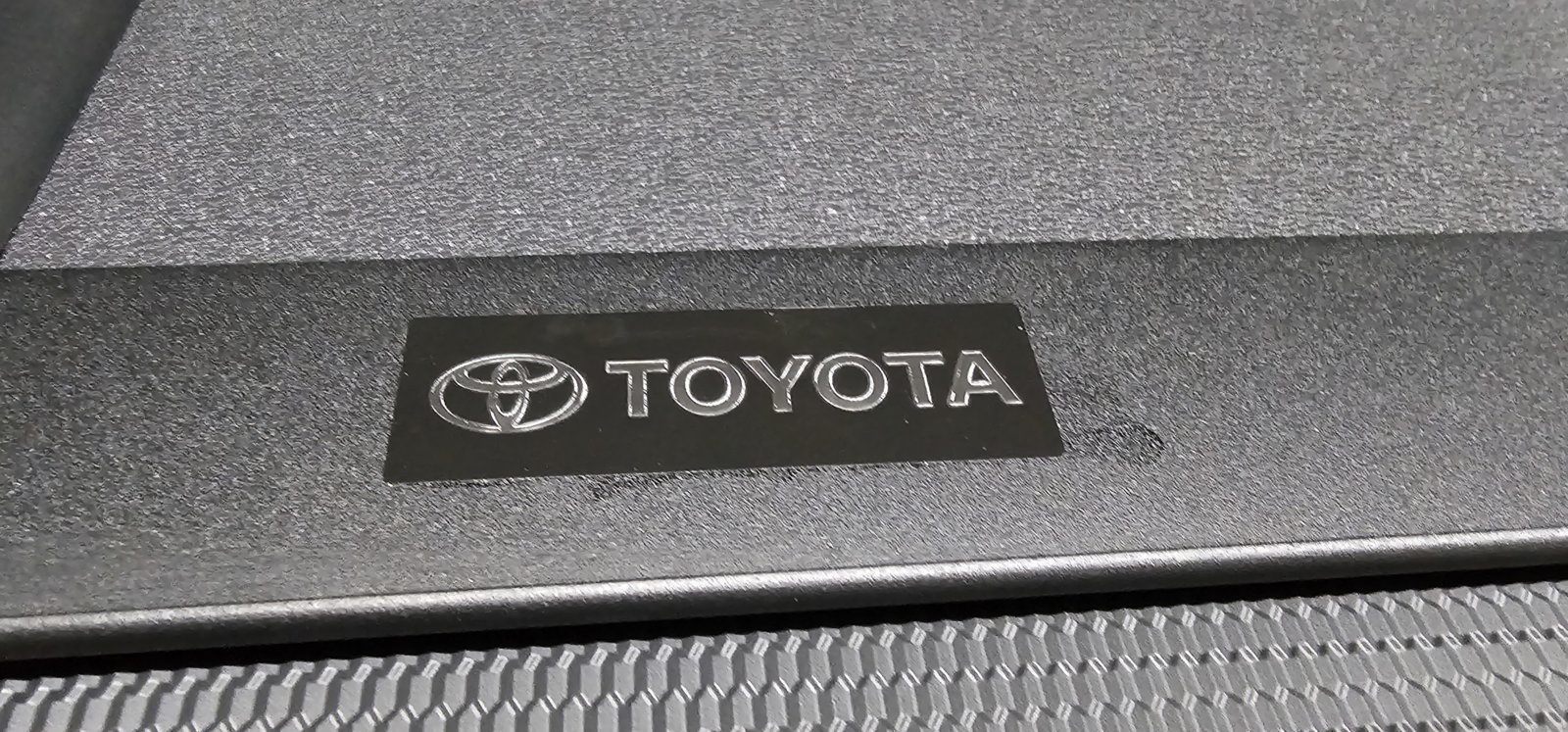

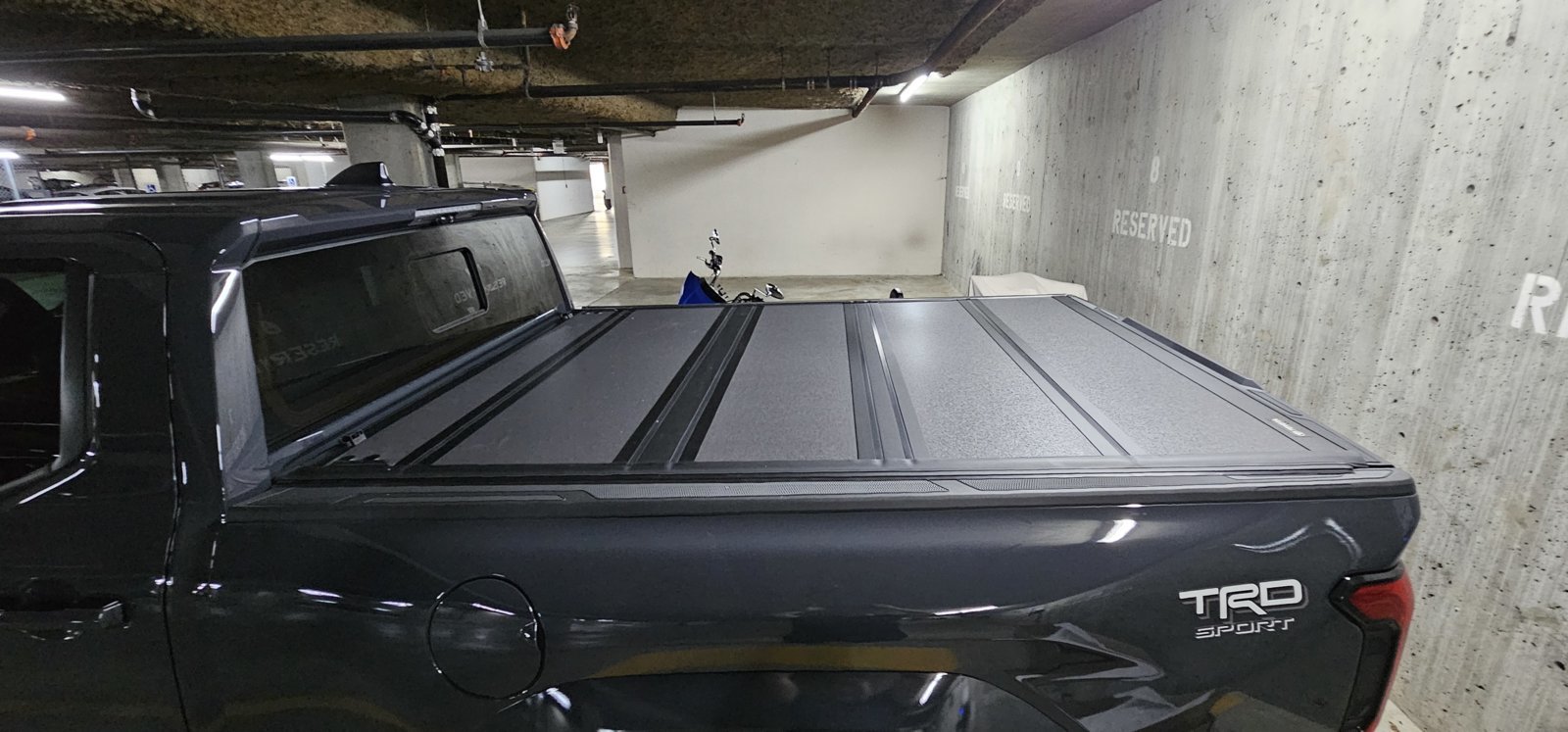

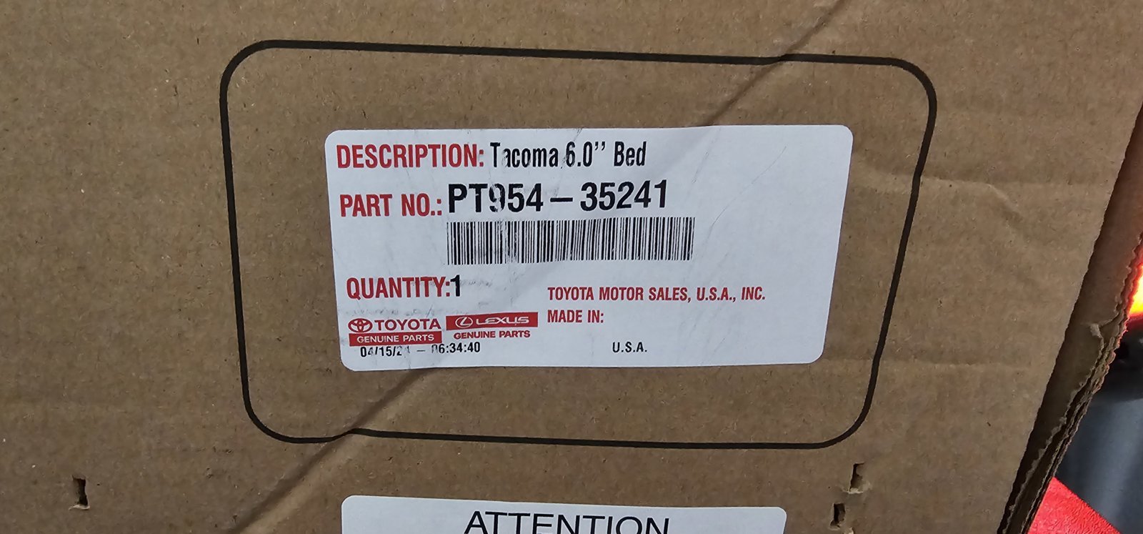

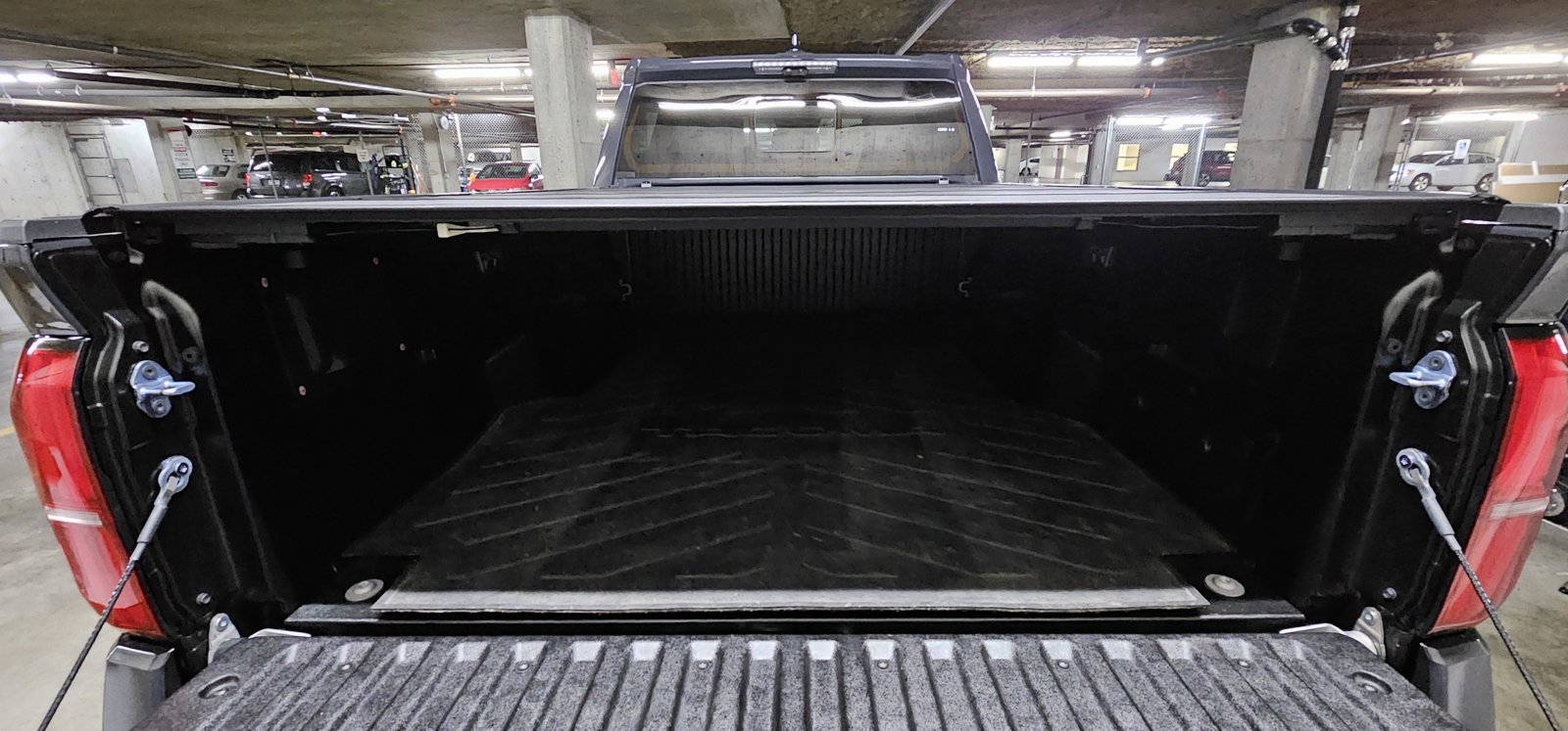

    I installed the Toyota OEM 6' Tonneau Cover today, part # PT954-35241. Looks great, appears to be the same as the Bakflip MX4. Took just over an hour to install, seems lighter than the MX4 cover for the 3rd Gen.

    Looks just like a Bak Flip. The only bad thing is with it folded all the way up it blocks the entire rear window.

    Damn that looks great! Seems so much better than the 3rd gen OEM tonneau.

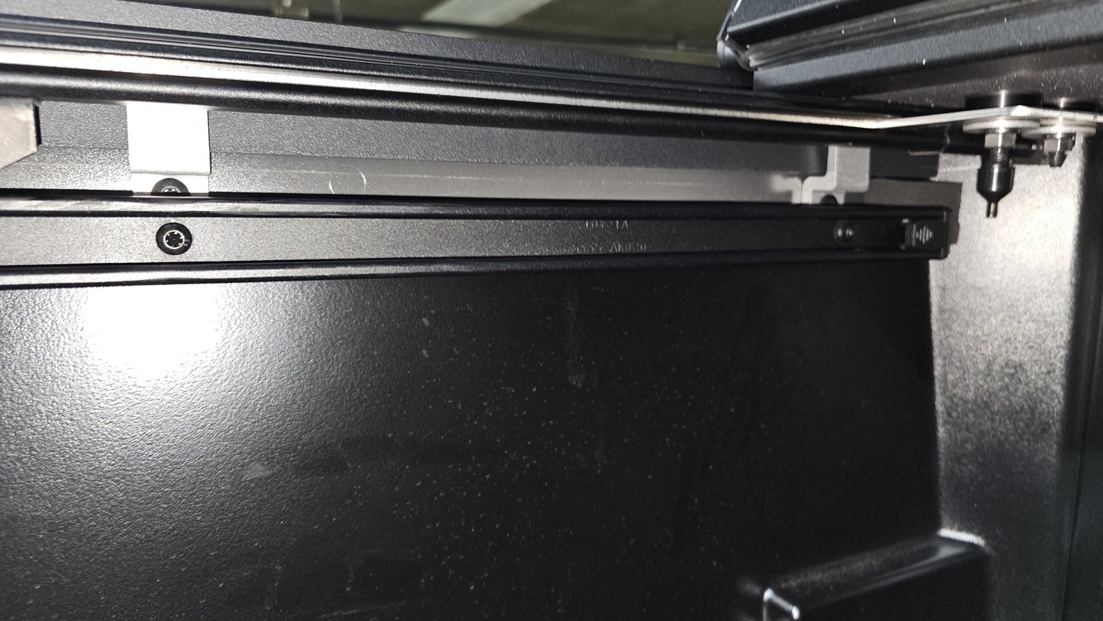

    Thanks for the info and pics, fast31. It presently seems that the OEM cover is the only game in town. Maybe others later. I'm very interested in the installation and what you had to do with the bed rails, if anything. I get the impression that they're not moved, but are now unusable. If you could spare the time to post a photo of a rail with the tonneau installed, it would be helpful - they're just not visible in your open tailgate pic.

    Very simple install, the rails are removed by removing x6 T30 machine screws, they are still usable as they are remounted to brackets that are installed with the side tonneau cover rails. I don't have BEFORE pics but this is what it looks like after installation

    Many thanks, fast31. Greats information. I can see in the photo where the top edge of the rail was mounted previously. I'm going to order this tonneau as soon as I find the best price. Did the cover come with mounting instructions?
