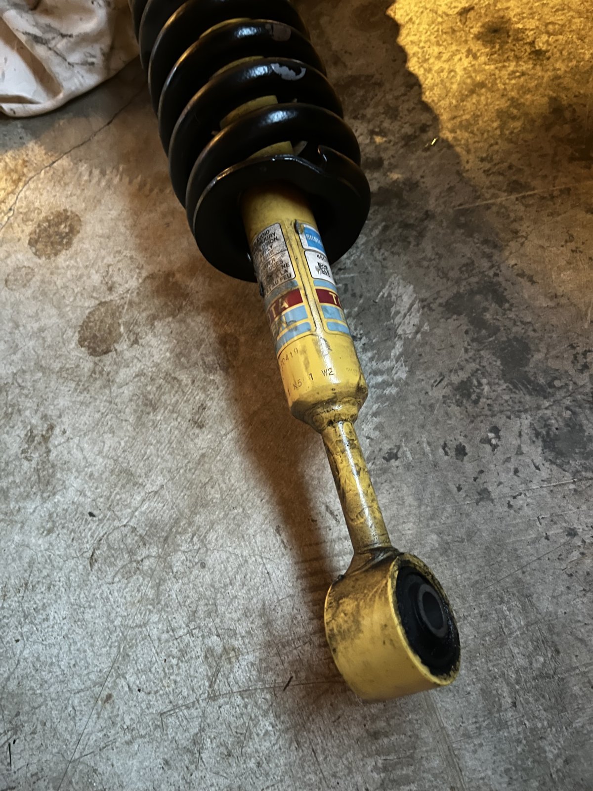

    Just recently put on some bilsteins from a 2023 Tacoma on my friends 2016 off road. They came stock with his truck. This was 5-6 months ago and he accumulated around 7k miles. The front drivers side blew the other day. Sprayed fluid all over the front end eventually and then back to the rear axle. Luckily we saved the old parts and put on his drivers side strut with ~70k miles with light off roading on them. The steering wheel is still straight and it drives better than the new shock on the drivers side.
    Symptom was a loud clink over bumps. And thumping on both sides of the floor board (probably the sway bar hitting). It started after we drove over a large speed bump (around 7-8mph) and then followed by 6-7 more speed bumps. I think the bumps over heated the shock and caused the seal to fail. Pic of the 7k mile strut.

    What coils are those? You might be hyperextending your shock if that's a longer heavy duty coil.

    They’re the struts that Toyota installs from factory. Wanted to keep the ride the same as new. They were take offs from a 23’ off road.

    curious because your photo cuts off the top side of the suspension pictured..
    was there a spacer of sorts installed that we can not see here?

    Nope all stock from a 23’. I did not disassemble them to install. Bought from a person who used them for 1500 miles off marketplace. They seemed pretty shiny and new when I got them. Definitely newish. They Probably went hard on them off road TBH before selling them.
    The strut we put back in probably has around 500 miles of off road. The passenger side is the same, brand new bought strut assembly that was taken off a 23’ model and put on the 2016. Once again it took about 5-6 months before it blew a seal. This was with zero off roading.

    Hi OP, I blew out two stock Bilsteins on my 2019. Toyota replaced the first one under warranty. After the second one started leaking, I swapped out all the shocks and lifted the truck.
    In both cases, the dampers melted.
    Curiously, on my wife's T4R, an SR5, we didn't have that problem while driving under the same conditions.
