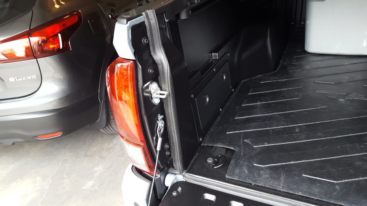

    This should help with the water leaking near the tailgate - https://www.amazon.com/gp/product/B00IPQWXZQ/ref=as_li_qf_asin_il_tl?ie=UTF8. As far as the sides leaking, I'm not sure since mine doesn't have that problem. Got lucky I guess.

    Quick tip for those who have leaking on the rear panel. Sometimes that panel does not latch all the way and you have to press on the top of the panel near the latch to get it to latch correctly. You will here it click when you press on it that will let you know it's latched and you won't be able to lift it up that much. You can tell if it's not latched all the way because you will be able to pick up the cover at the tail gate about an inch. I got mine cheap off a friend who got a topper and didn't need it anymore. I like it but it does leak like people have said. The tail gate seal above does help and you can do a few more things to stop the water coming in if you want to spend the time. I had to pop off the side rail caps when installing so I added some weather stripping under them to stop some of the water coming in. I also went around the top of the bed near the tail gate and plugged some of the open spots and holes with some black silicone. It is a lot better than it was but I still get water back there thru the seals where the panels flip. If yours didn't come with it I would look at an aftermarket one they probably won't leak as bad unless you get a great deal on an oem one.
