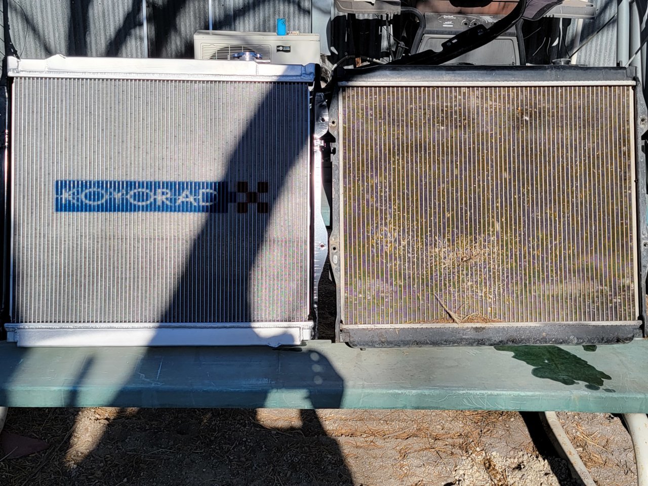

    I had a part store radiator in for a while but I never liked it. I'm doing a bunch of other work so I ordered a koyorad. I did have to order the Koyorad cap that goes with it. It just came in today. It firs perfect and looks great to me. I am a ways from having it running so I can't comment on the claimed improved performance or longevity.
    But if your looking for options it one.
    https://koyoradracing.com/news.asp?id=200
    I avoided the champion after this thread. They also stoped listing it for 4x4 probably fine for street but I wheel mine.

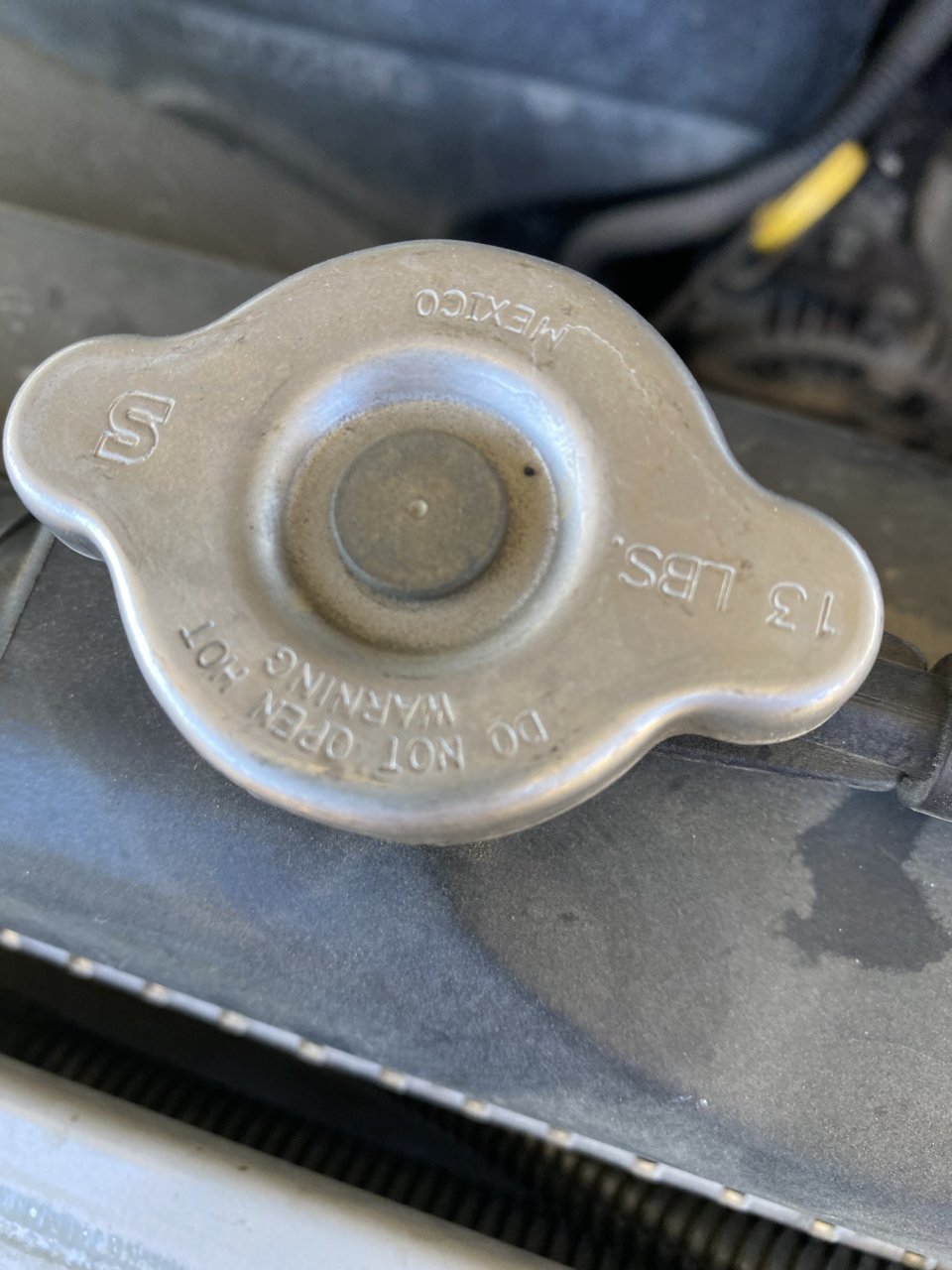

    I replaced mine with a Denso from Napa. Made in China. But the cap is made in Mexico!
    I see the big S on the cap for Stant
    :rofl::rofl::rofl:

    Just did a KOYORAD from Rockauto last month. It's thicker then my stocker (2002 3.4L 4x4 5sp) and also longer by an inch (factory skid still works). Comes with it's own brackets and fit like OEM. Very happy with it and the bit more in expense is totally justified with the quality and warranty.
    Just cannot trust chain store chinese crap anymore.
    Also Heard tons of horror stories from people running the Champions
