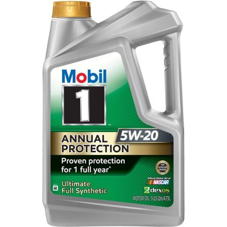

    Just use the Mobil1 annual oil and filter. Once year. You're done. Yours would be the 5w-30 flavor
    And if someone has already mentioned this. Sorry. I ain't readin' this whole thing. I'm still trying to catch up from the 750 oil threads that were posted last month o_O

    I would only drop the coin on this oil if you want to extend your OCI to 15,000-20,000 miles AND you put that on your truck in a year.
    This oil is about $80-90 with filters. No point in spending that when regular ol Mobil 1 can get you 10k or one year for half the price.
    I'm currently running this oil. I'm changing at 15k miles and will run an oil sample to Blackstone Labs to see how it does.

    Walmart has it for $39.95. Add about $10 for the filter....and you have a $50 oil change that's good for 1 year or 20k miles. That's perfect for the OP's needs

    No its not. The OP, if I understand correctly, barely puts 5,000 miles a year on his truck. ALL oil will be just fine for him and take him to 1 year.
    Mobil 1 Annual is intended for people who put nearly 20,000+ miles on their car per year.
    Again ALL oil lasts 1 year. It's the mileage interval that changes.
    The OP would be wasting money to buy that oil.
    This oil is very new and is going haywire on price. It was $100 for a Qt, jug, and filter when I got it.
    Cost at Walmart is $67 with an extra Qt and filter right now. Still silly to recommend the OP spend roughly $20-30 more on an oil not recommended for what he uses his truck for.
    It would be equivilent to telling him to put Amesoil in his engine. He does drive enough to benefit from a premium oil.

    No it's not. If the OP used that oil for 20k miles doing mostly short trips it would end up looking like chocolate milk.
