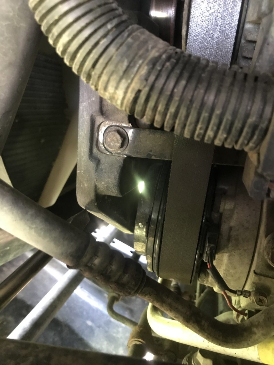

    you’re missing the supercharger that’s in the OP’s truck.
  2. Aug 23, 2020 at 9:48 AM
    #22
    cory02taco
    cory02taco Well-Known Member
    Jan 19, 2012
    #71007
    2,255
    Cory
    Maine
    2013 trd super sport
    for reference here’s the compressor behind the s/c tensioner assy. On my pickup. Notice how the clutch is a little more shiny than the rest of it.
    TreeFortRichard likes this.
