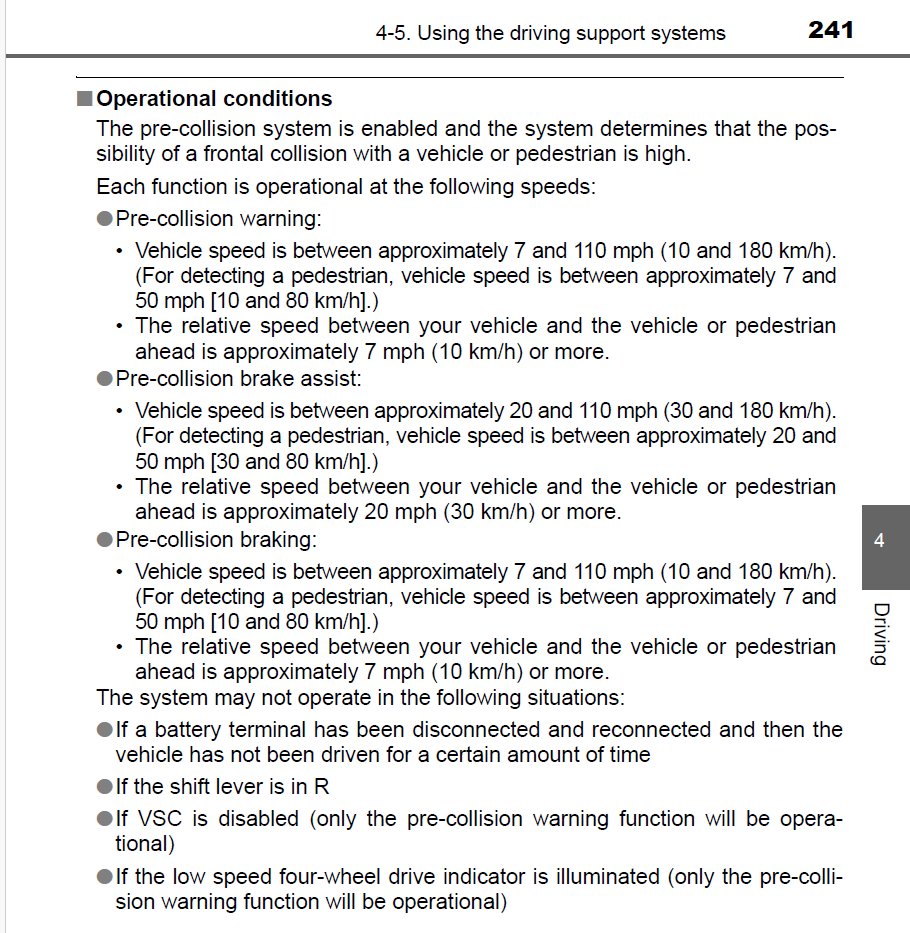

    It does, but I'm not sure what the difference is between the 2nd and 3rd,, relating to OP's question. What is the difference between "pre-collision brake assist" and "per-collision braking"? Their speeds vary from 7 to 20 mph.

    At low speeds the PCS is disabled. It also won't activate if you are tailgating somebody.
    It needs distance to register an objects motion relative to your grille

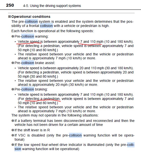

    I read up a little on this subject since I have PCS (Pre-Collision System)
    Here is states the system works at 7mph for pedestrians.
    On page 254, it gives instances where the system may not work.

    I think this may be it exactly. atleast it was a small accident kudos to @Chew for posting up the manuals info that's awesome and exactly what I was looking for. Makes a lot of sense and helps me understand it's limitations better!

    you can download the manual on Toyota's site. It's much easier to use, being able to search hundreds of pages in a split second.

    I believe the assist requires the driver to press the brake pedal, and the truck applies additional braking faster. Versus Pre-Collision Braking the truck applies brakes without the driver doing anything.
