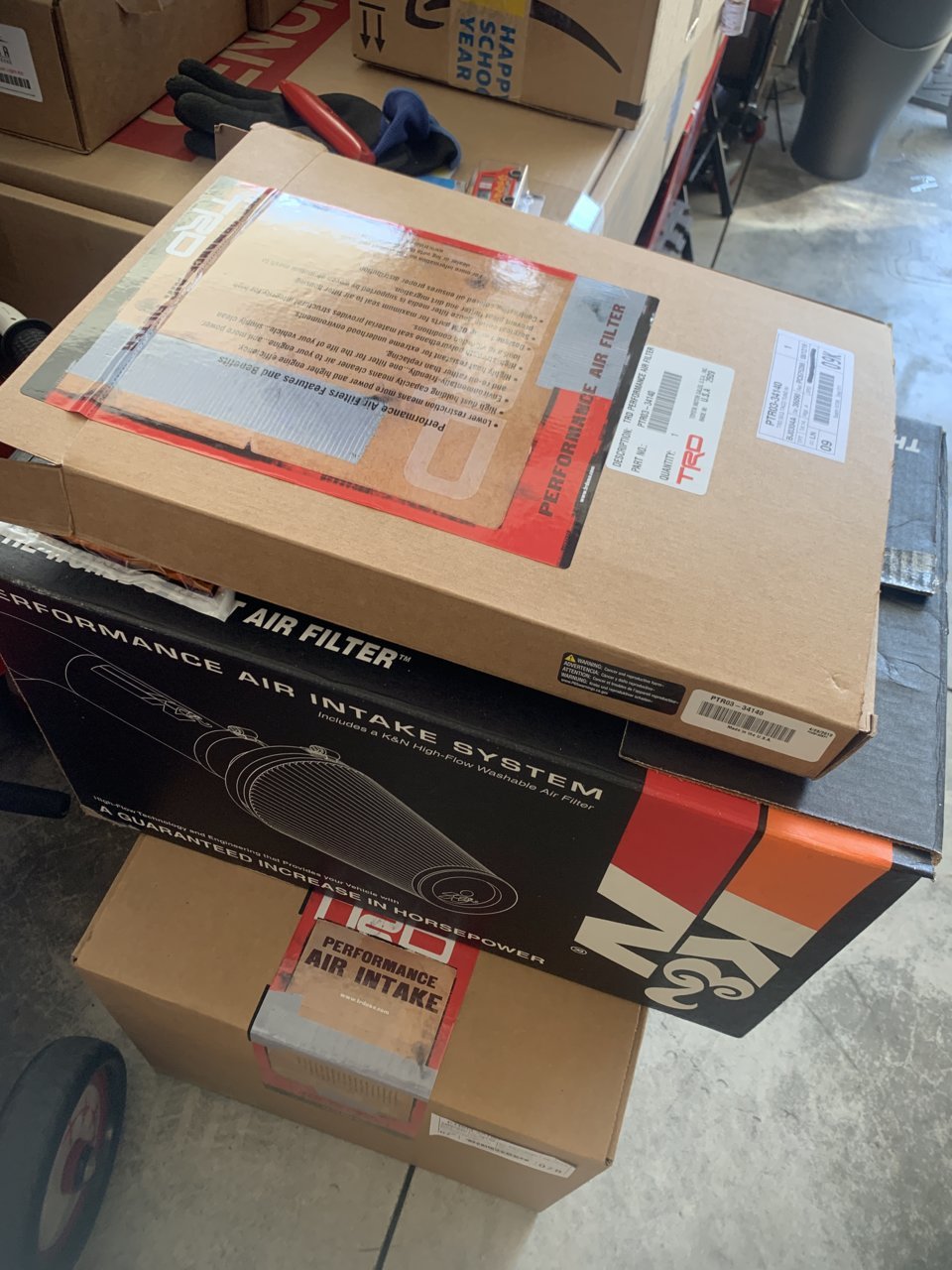

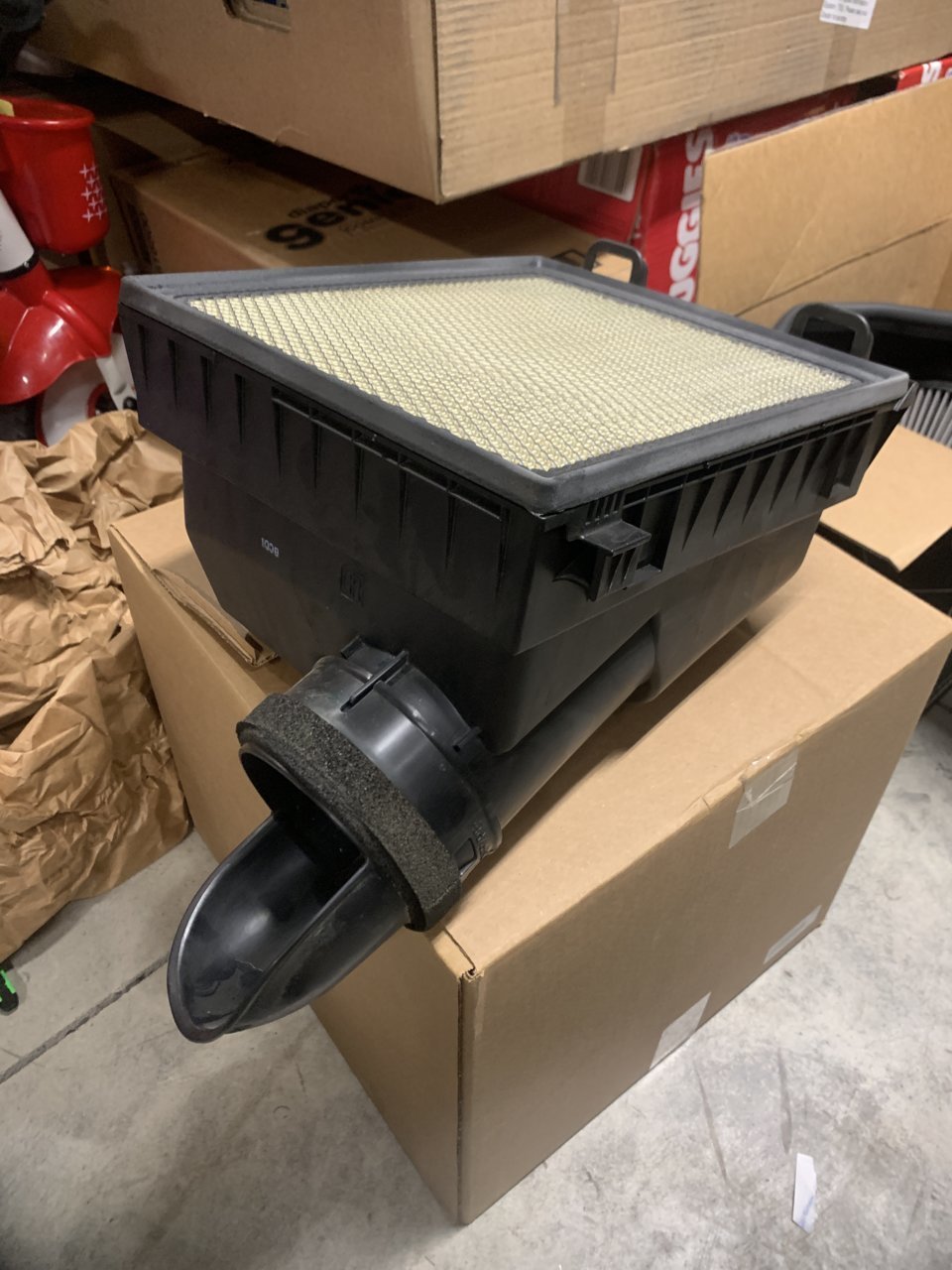

    I also will be testing out what u see pictured here, TRD air filter (currently), to TRD CAI, to KN intake.

    Put a logging vacuum gauge, right before the manifold, w/ stock air filter. Do a few 0-70s with the pedal squished.
    Drop in a KN hi-flow filter. Repeat the test. See that? The lower peak vacuum proves the KN makes a difference.
    It isn't much, but it's there and it's real.
    That is the most you can achieve with this set of tubing without adding some way to force more air into the manifold.
    Add an NO2 bottle where you measured vacuum. That'll be noticeable.
    Or, sell the truck and buy a McLaren ffs.
