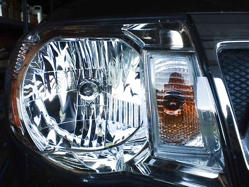

    Just a note if you are going to have the dealership install new headlights and you have after market bulbs, make sure you tell them to use the old bulbs that were in your bubbled or cracked headlights. They almost threw away mine. Thankfully I got them and installed them tonight.
    Aftermarket PIAA on the left and stock on the right.

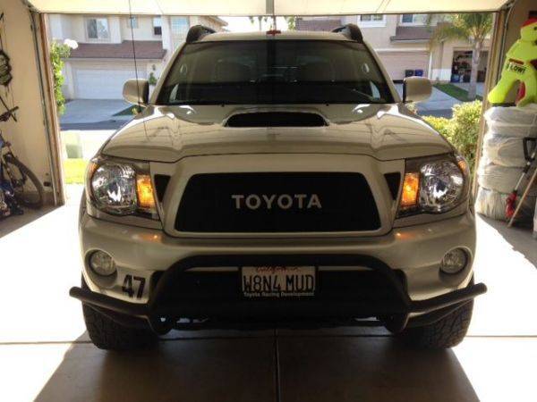

    So here is what happened... Frank Toyota, more specifically Mike in Service, hooked me up. He knew I wanted smoked Chrome and Toyota Motor Corp followed procedures and sent them the all chrome headlights because of my VIN. Mike was able to convince his bosses boss to exchange the replacement headlights for the smoked ones for me. After an additional day of waiting, they did it. The original day I went in for the inspection, it took them 2.5 hours and nothing was done except for placing the order after a thorough inspection. When I went back today, I unfortunately had to wait 3 hours at the dealership. I'm still very excited about the whole exchange and it not costing me a dime except for a little bit of my time.
    THANK YOU MIKE.
