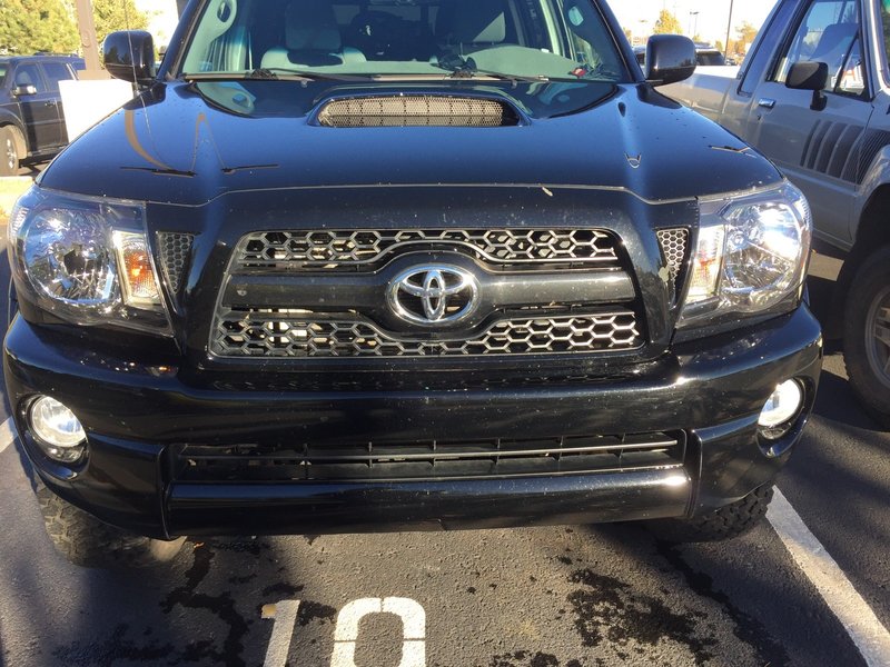

    squeezed an appointment in and got mine replaced last friday. makes the truck look almost new again lol

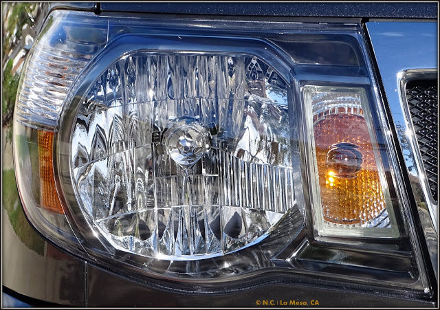

    I got mine taken care of earlier this month. Warranty expires Nov 30th!!!
    Thank you Toyota!!!
