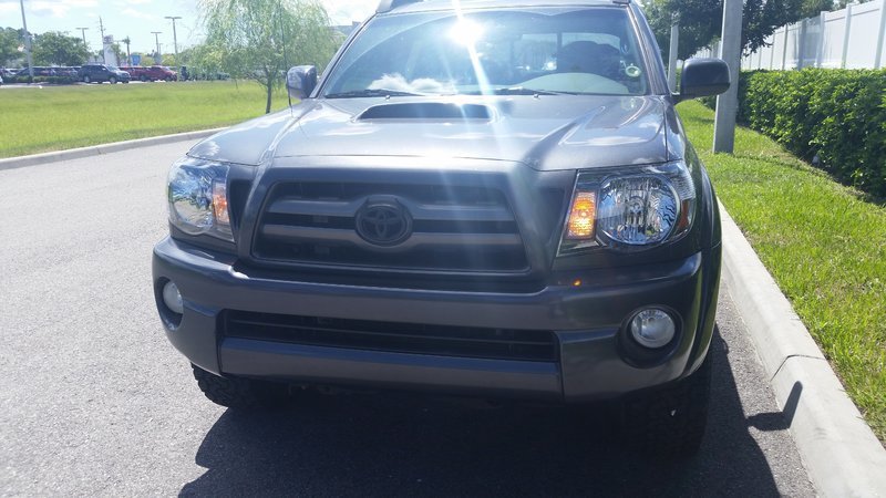

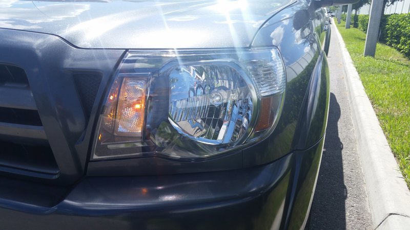

    Here at the dealership. I showed them the error of using the same old faulty buckets for my warranty repair- part # 81110-04173,(RH) and # 81150-04173, (LH).
    The TSB states they should have been replaced with 81110-04210 and 81150-04210. Note the 04210's are the tinted Sport lenses. Others like SR5's and Off-Roads get the 04200's... They are ordering me the proper replacements that should have been originally used last year when I brought it in.
    Win! Thanks to the sharp eyes here helping a brother out!!!

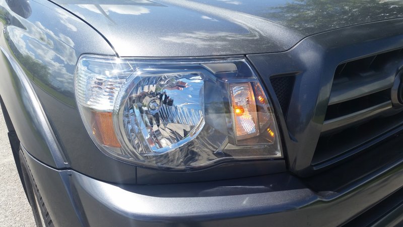

    New buckets were in stock, so they swapped them out on site this morning, stoked! I will likely pull the amber running light incandescents and replace with amber LED to further minimize heat melt again. West Marine, here I come.

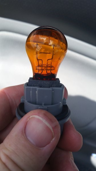

    Stock Running light bulbs are the Sylvania 4157NAK.
    Looking into the led swap appears to not be as simple as swapping a bulb- i just found the relay mod thread needed to make the led swap. Not really thrilled about randomly grinding away on a relay hoping I create the correct resistance needed to run the leds..

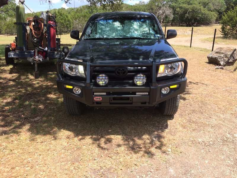

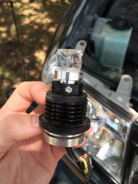

    I had this recall done last year on my 09 at Boerne Toyota because my DTRLs melted the inside of the housing. I am now running V3 Tritons in place of the Sylvania bulbs to try to keep this from happening again. Good results thus far.
    i would go for the V3 tritons so it's all plug and play. They have resistors that plug right up

    Yeah the price is definetly high.. but ive found with LEDs that typically, you get what you pay for and these also didnt require me to cut the factory wiring to run load resistors, so that alone was worth the price difference for me. But yeah they run cooler, instead of the bulb getting hot like traditional incandescents, the metal housing of the bulb is designed to help disperse the heat. I got them because i wanted switchbacks and was tired of wasting my money on cheap LEDs. here are a couple photos of mine
