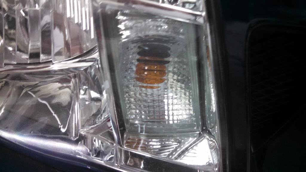

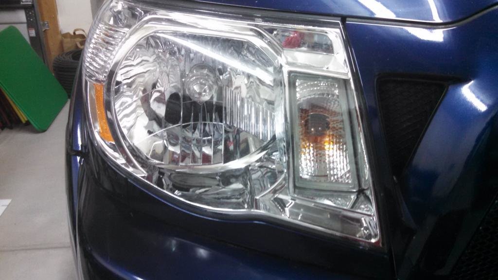

    Mine was the first replacement on the new warranty program my dealership had done. Ordered parts on Tuesday, arrived Wednesday, and installed Thursday.
    Here are the before and afters...
    Before:
    After:

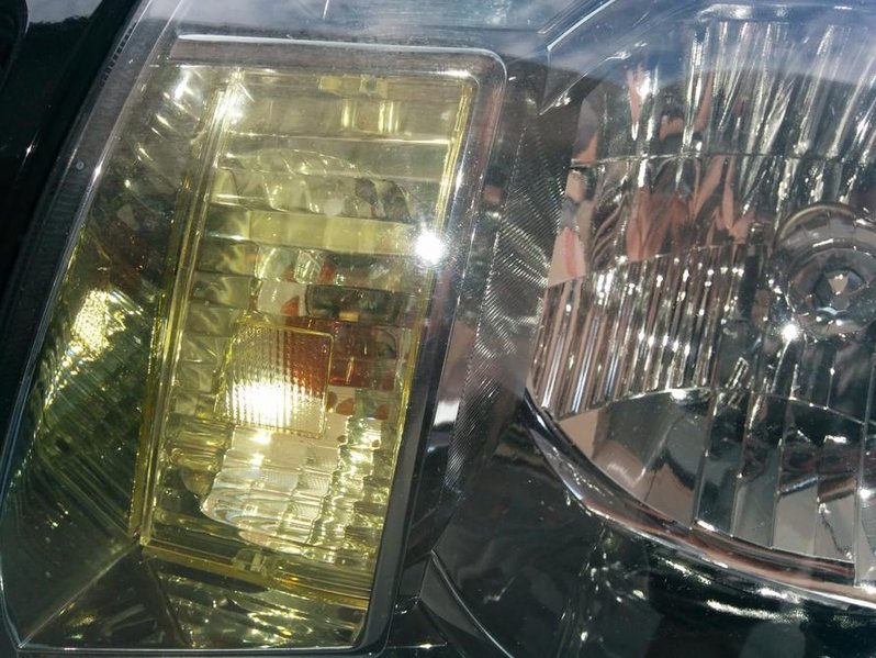

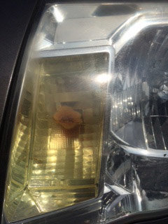

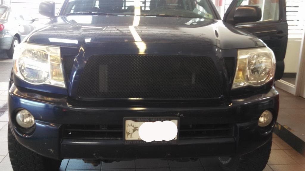

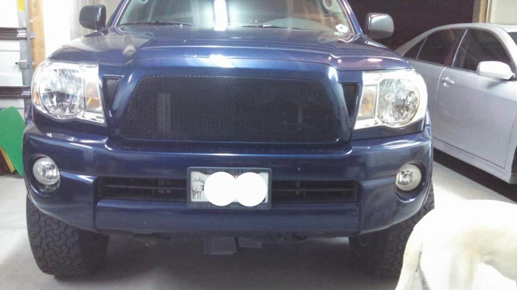

    Had the new headlamp assemblies installed this morning . . Moss Bros Toyota in Moreno Valley. First pic (before, with the melting/cracked inner lens) and second pic (after).
    Big thanks to TW.

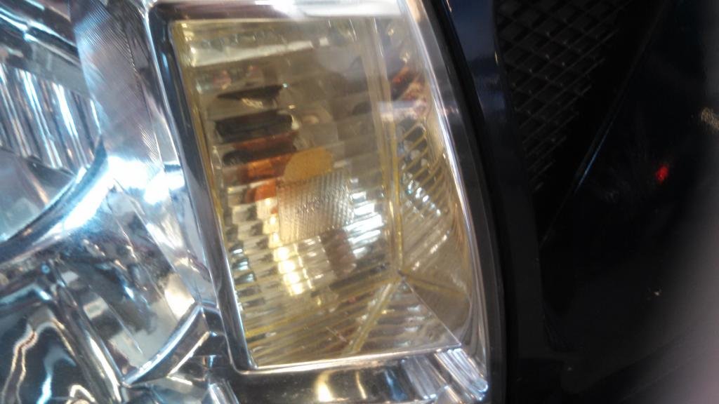

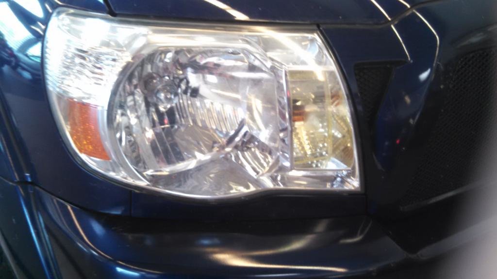

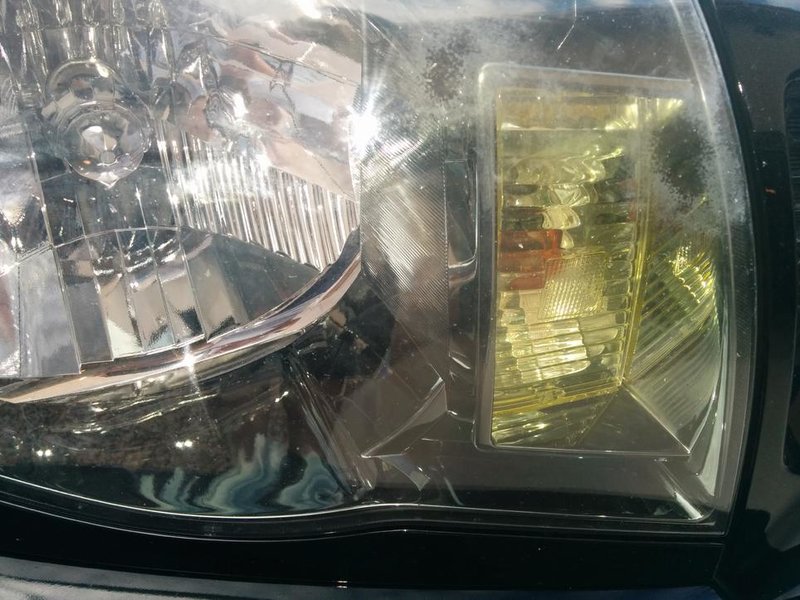

    Got mine done, but they put the wrong headlights in. Old (melting) style:
    I just checked the part numbers. Installs don't match the TSB or whatever the *uck it is:
    Oy vey. :mad:
