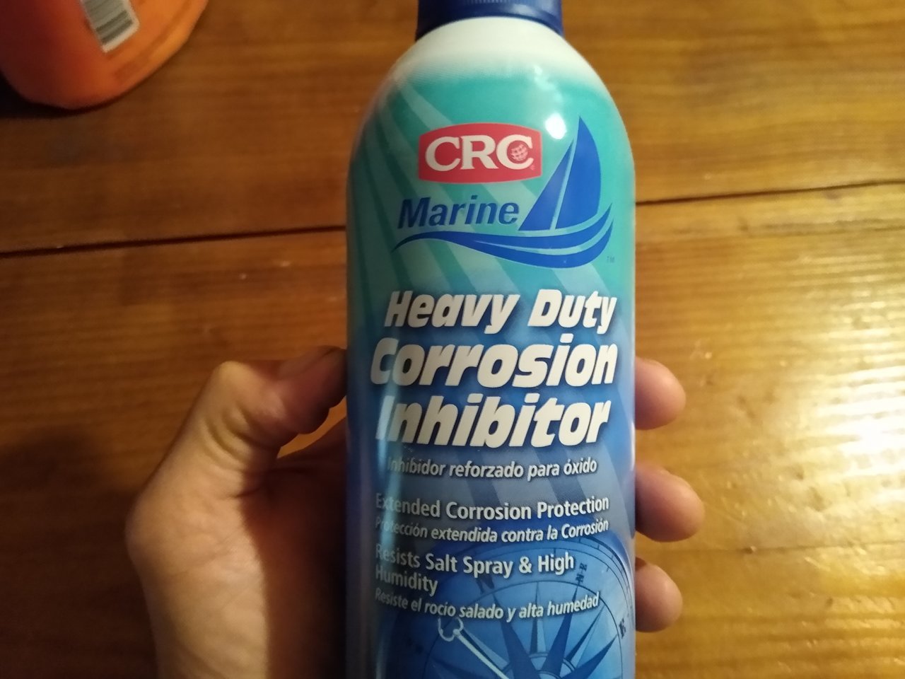

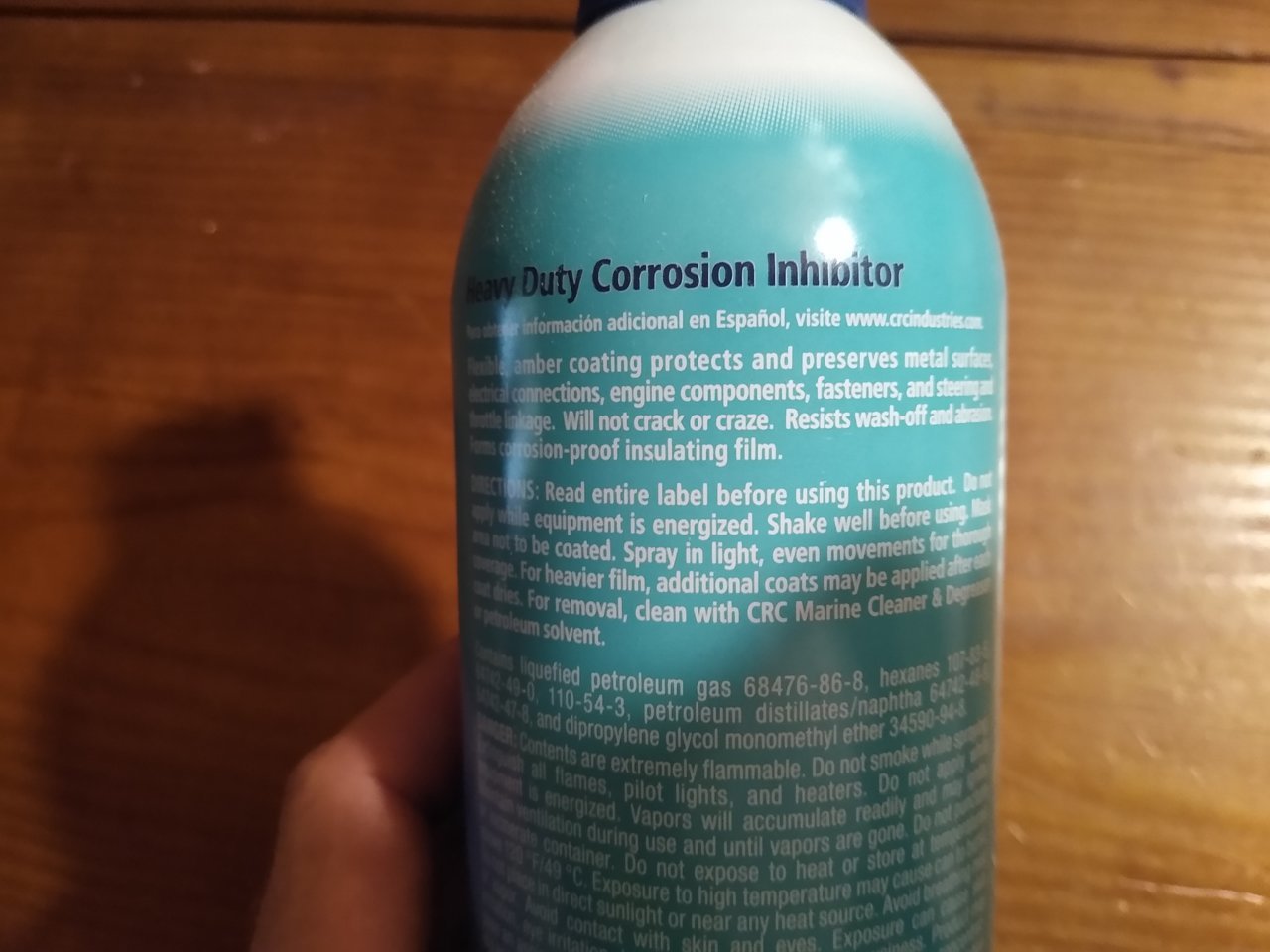

    Sorry if this was already covered, but what is the make up of the CRC they apply?

    I applied this crc last winter..i had the truck new for about 3 months when i applied it...it seems to be holding up..i will crawl under there again when work slows down...not shure if it needs applied every yr like fluid film....i have a test going outside...i speayed the crc on a stick of rebar and have the rebar leaning ip against the building out side in the weather and sun and rain...its been out there about 7 months..and i do see its showing trace abounts of rust..so i think this stuff needs applied every yr..

    When my 01 tundra frame was inspected for a bad frame under their program. They replaced the spare tire cross beam carrier and the fuel tank straps and used that crc stuff on it which was part of that mandatory program. I wasn't too impressed with it. I noticed after a couple years i had to re-coat it with fluid film as that spare tire carrier was already rusting pretty good in places....same for the fuel tank straps. Only best advice is to keep on if you plan to own the truck many years.
    This is the first time i've used cosmoline on my new vehicle so it will be interesting if what they claim about this stuff holds true. At any rate the undercarriage of this truck now looks better than when i first picked it up at the dealer.
