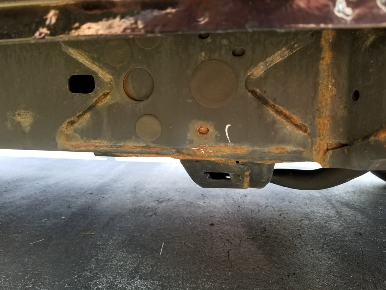

    One of the big problems is silica deposits on the welds. It'll leave a small island here and there, then they paint the frame, and later on the silica deposit falls off leaving exposed raw steel. You'll notice most of the rusting is at welded seams. They need to sandblast the frame before coating it. But that's time and money.

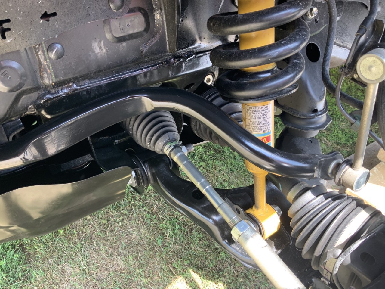

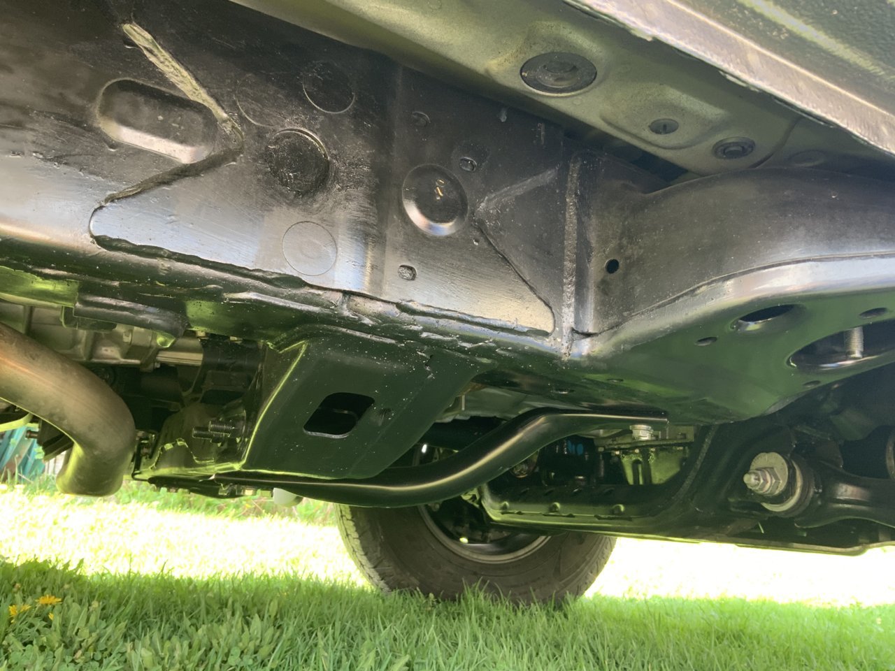

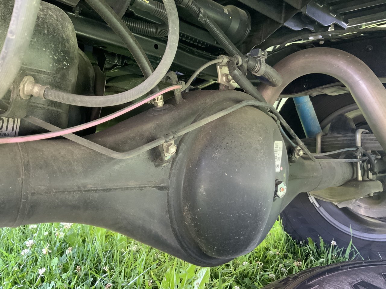

    My truck does not look like that because I went under it when new, hand wire brushed the surface rust off the frame welds (and raw machined parts), then rattle canned with Rustoleum. I then applied Rust Check in the cavity areas (again with rattle cans). Cost less than $100.00 and took about 4 hours. Still looks new underneath even though the truck is used on a farm, gravel roads, mud, rain, snow, trails, etc... I occasionally pressure wash the underside and reapply the Rust Check. Perhaps spending less time complaining on the Internet and more performing preventative maintenance would help. 6E708B3A-4C5F-400D-AD8E-078C13FB57AF.jpg
