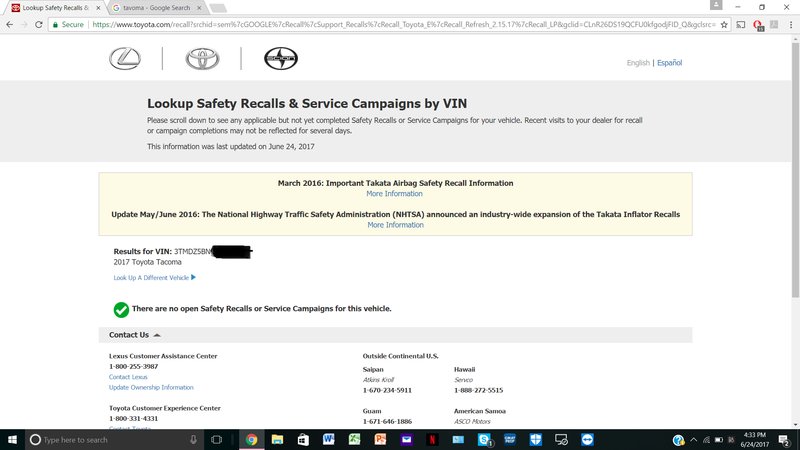

    as of today still no recall notification. Don't want to take my truck in yet just to make sure after the stories I've heard. Will wait until the have a legit fix.

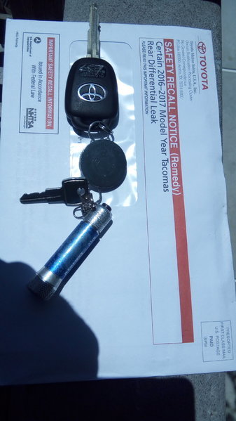

    o_O The heck do you mean my truck isn't the on the recall list? My vin IS on the recall list and I got the notice in the mail telling me to bring it in for the recall.
