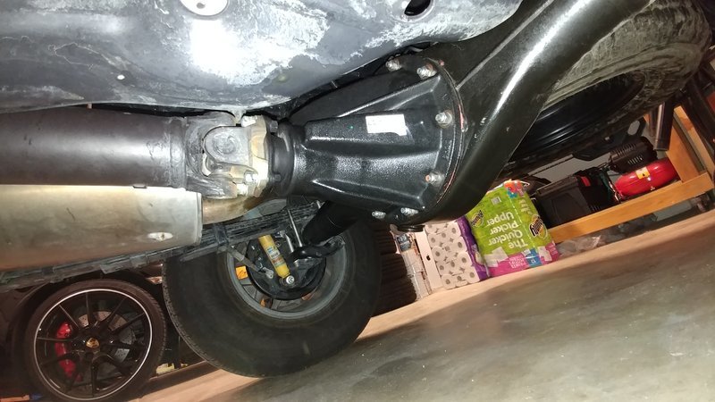

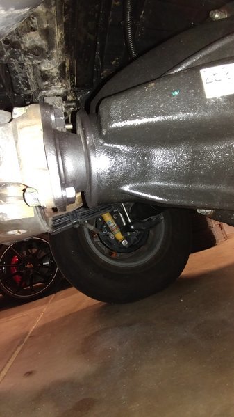

    Pics for reference. This was after wiping it all down. I've been driving it for going on 2 weeks so I would not think the oil would have been as clean as it was when I wiped it off if they had just not cleaned it up during the replacement.

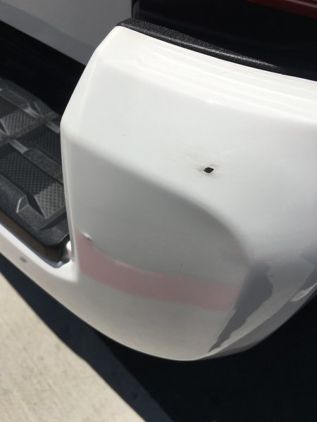

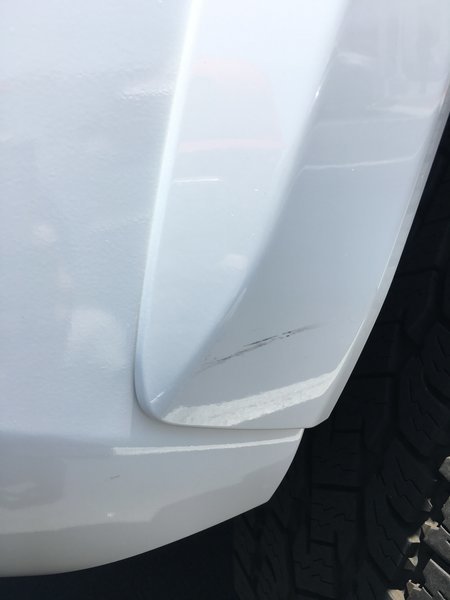

    My truck has been with Toyota for 43 days and still nothing, I received a call from the service manager last week stating that my truck should be ready in a week, a week went by and still nothing, I finally decided to take my truck home because I hated the fact that it's just been left out for so long. I now have my truck and am still 2nd in line to get the repairs done once the parts arrive, worse part about this is now I have 2 scratches on my truck which ofcourse will also be fixed together with the differential, I should've never brought it there so early and just wait
