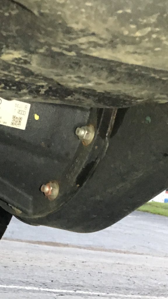

    I have a TRD Off-Road, and wasn't really too concerned about this since I wasn't part of this recall. But wouldn't you know it I was bored are read through a bit of this thread....then I was like "man....maybe I should crawl under mine and check out the situation...."
    Sure enough I have two small spots on both the driver and passenger side of the diff (total of 4 spots) that are weeping.... great... I'm not even sure what to do with this at this point, since it isn't part of the recall. I guess I will take it to the dealer this coming week and at least get it documented since it doesn't sound like they are doing jack shit for Off-Roads....
    It never ends with this truck...

    Take it to the dealer and they will either fix it under warranty at the moment or retorque and send you on your way. If they retorque and or send your way at least it is documented. From what I can tell there are a lot of trucks not on the recall that are weeping. I am thinking the 228k were just the beginning of this fiasco. GLWYT
