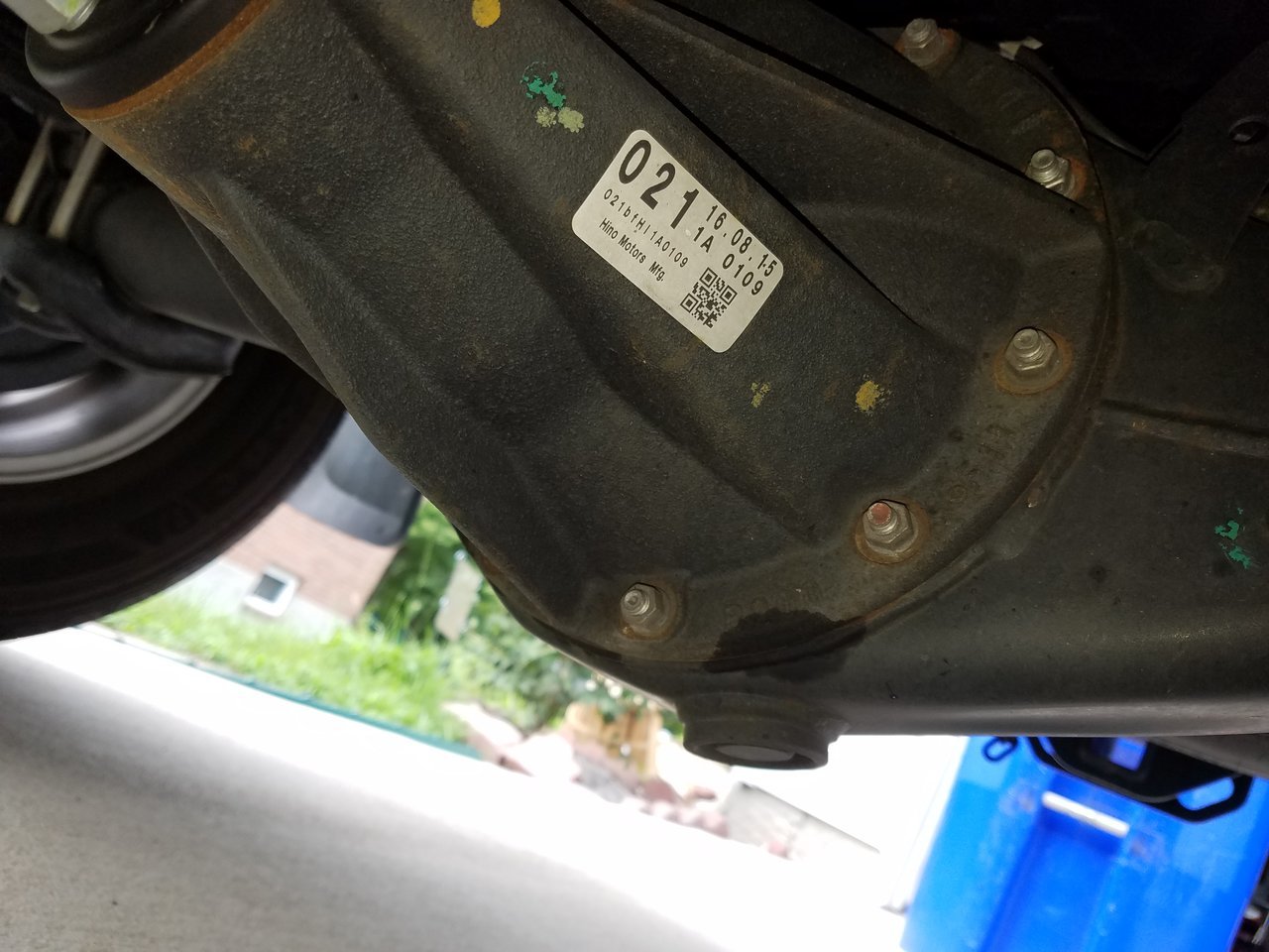

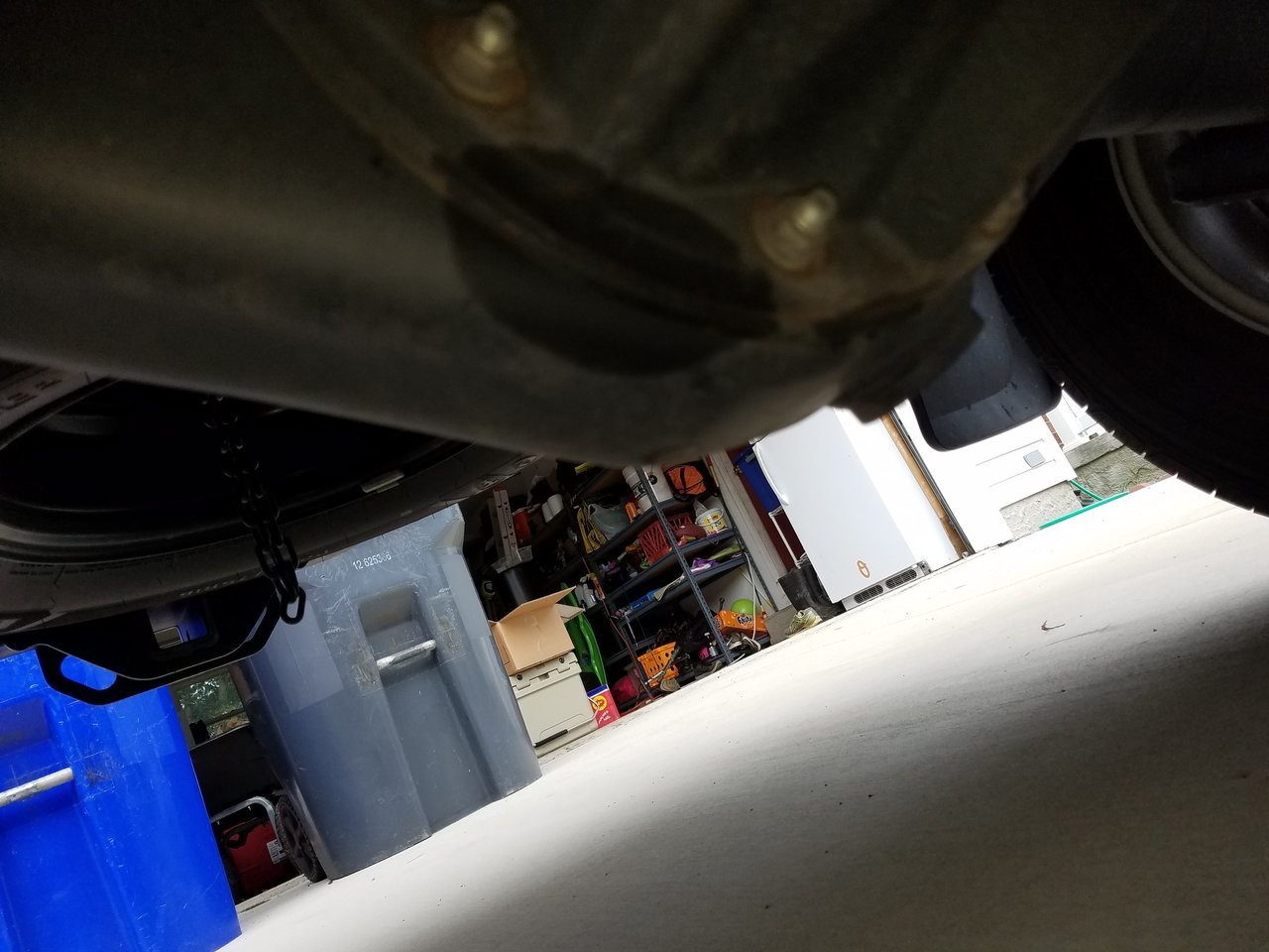

    a81lp Active Member
    Sep 16, 2016
    #197421
    43
    2017 SR5 INFERNO DCLB
    SilverII likes this.
