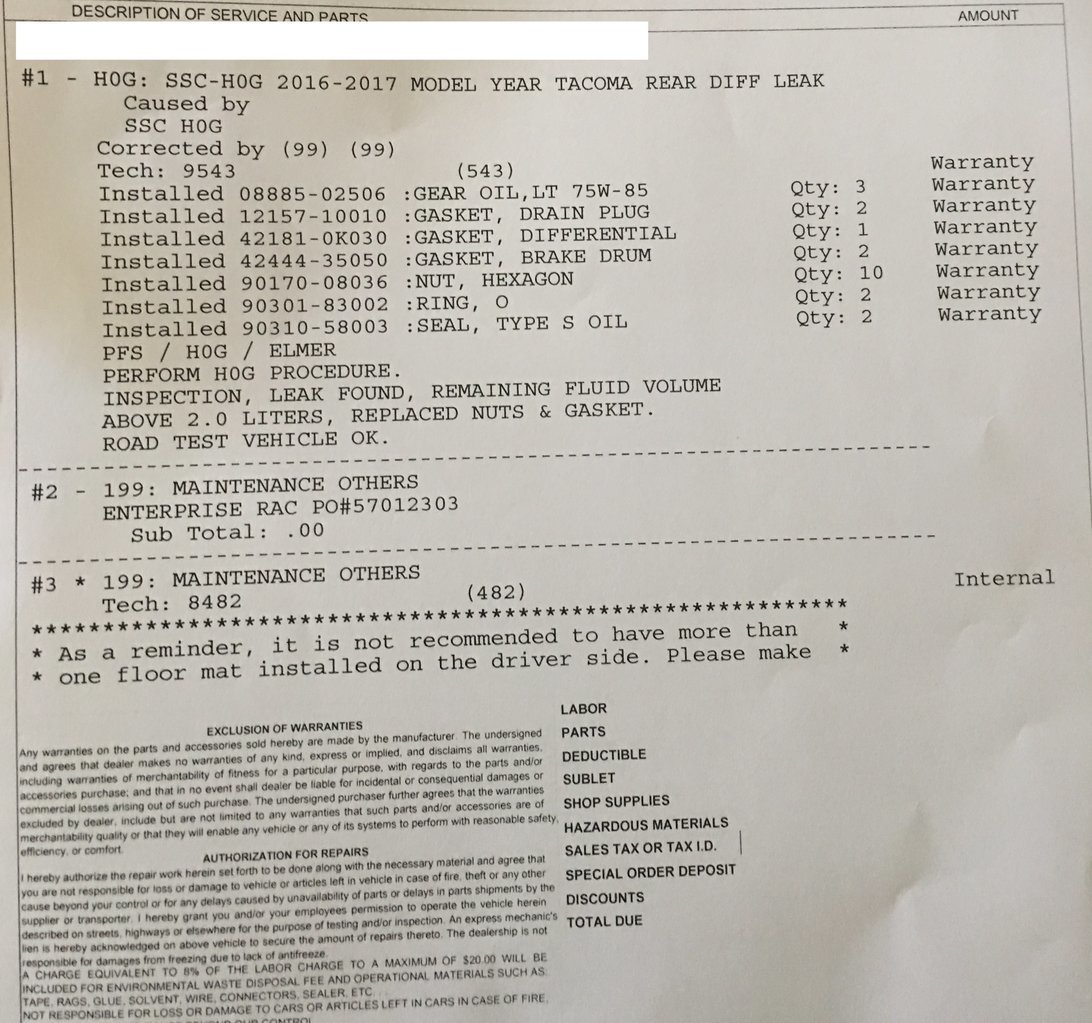

    It depends on what was done per say. My invoice only states the same parts for nuts seals and gasket. But in reality they changed out the carrier (not entire axle) which leads me to believe they may have changed everything inside too. But again. Those parts are not listed and i can clearly see it's a new part bolted up.

    As I am saying beyond what I can see I can't tell you what the complete repair was if the invoice is only what they want to print on it.
    I see what your trying to do and not trying pee on your leg.
    So I got the new parts on the invoice plus extra, but how much extra?
    The truck feels completely different. Like it should have been from the start. No major shifting flares and it holds gear a lot better. Still has the clunk when shifting from park or drive to reverse occasionally and had a little hard down shifting or axle wrap going from stop sign to stop sign when engine was a little cold. I would say most of it is corrected and only time will tell if it will last. On another note.
