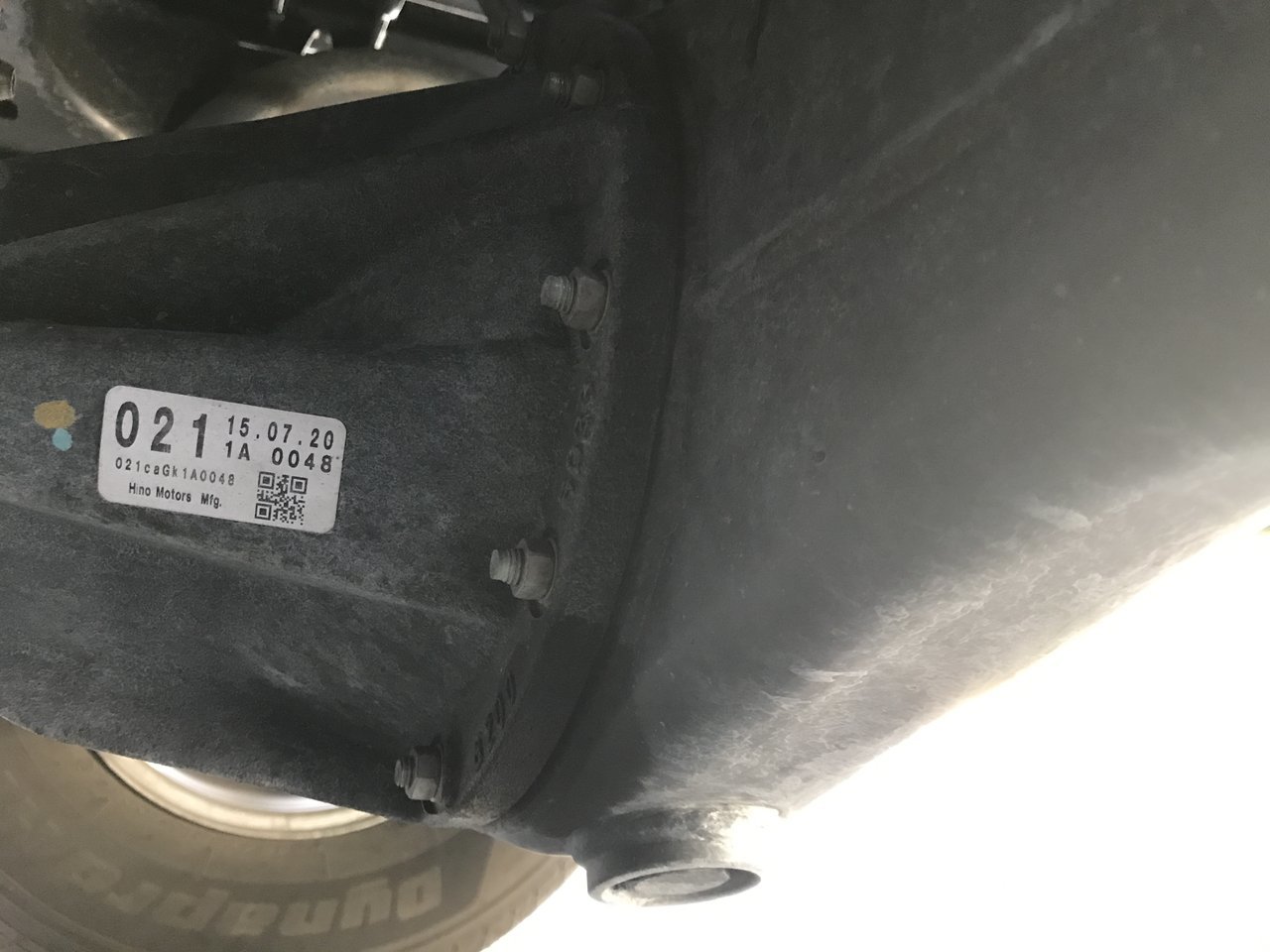

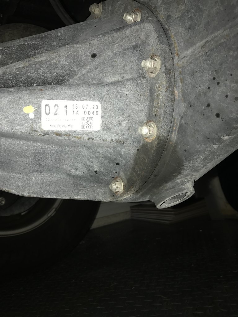

    Well I finally got mines done at Toyota of Orlando.
    This is before.
    This is after..
    So looks like they just tightened the bolts.
    Won't be purchasing this lease!

  6. Aug 18, 2017 at 5:49 PM
    #3566
    cliffyk
    cliffyk Well-Known Member
    Oct 27, 2016
    #200890
    2,039
    Cliff
    Saint Augustine, FL
    2009 DCSB SR5 TRD Sport 145k miles
    Send those photos to Toyota and tell them the dealer did not properly perform the recall--"Any sign of leakage, even very minor, is still leakage. Minor seepage is still considered a leak."

  9. Aug 18, 2017 at 7:03 PM
    #3569
    cliffyk
    Oct 27, 2016
    #200890
    2,039
    Cliff
    Saint Augustine, FL
    All they did was tighten the "differential bolts" (which are actually nuts, but expecting a dealer to know the difference is a bit much), which in all honestly is all I would have done--in my garage without a trip to the dealer). It is nonetheless NOT what the recall explicitly, and in no unambiguous terms, calls for...
