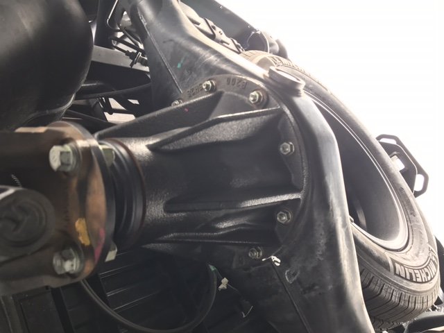

    This is how mine looked from factory. It's also what I expect it to look like once repaired.
    Thanks for picture.

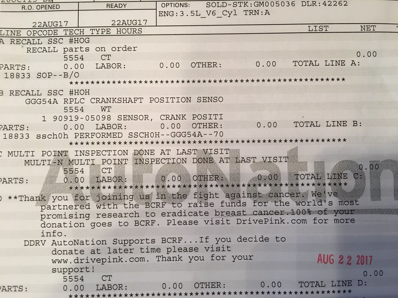

    I took mine in today for both the diff leak and CPS recall and they replaced the CPS and it looks like they ordered parts for the diff recall. My service adviser left me a message just saying I could come get my truck and then wasn't there when I got there so I haven't spoke to him yet. You can see on my invoice it says H0G RECALL parts on order. I'm glad they didn't ask to keep my truck. I did stick my pinkie finger in the diff and found oil so I'm not too concerned about driving it while waiting for the parts.

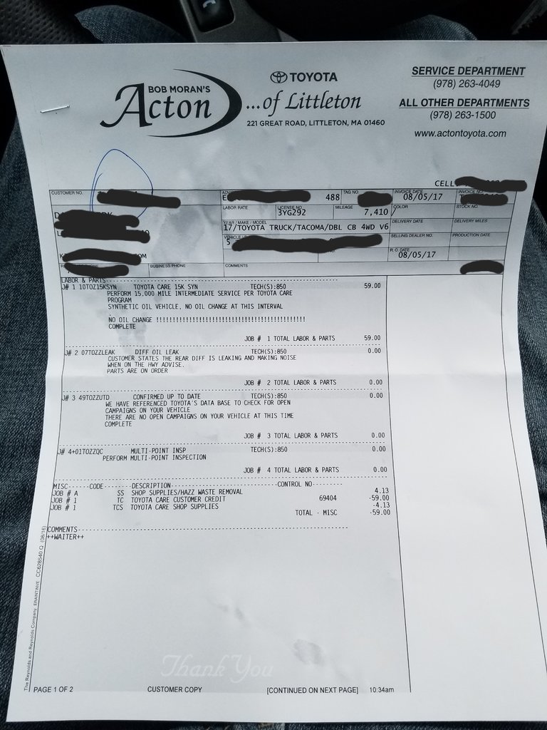

    Strange how it says no diag leak found
  11. Aug 22, 2017 at 2:06 PM
    #3611
    FritoBandito
    FritoBandito Well-Known Member
    Sep 26, 2015
    #165230
    400
    Texas
    2016 Limited 4X4 DCSB
    I don't see "no diag leak found" on my invoice. Is it encoded?
