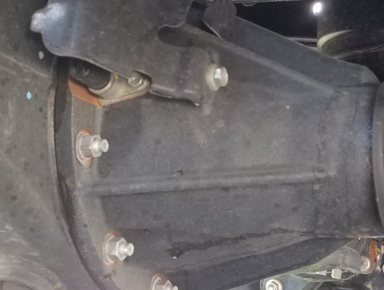

    LEAK. took mine in for 10,000 service 7 weeks ago.. i saw weeping 1/4 as bad as yours. told them look at it ,and i said, i knew there is a recall , but i said im not on it , they comfirmed, i was not on it,, they ordered parts, they called 10 days a go, said parts are in, taking it to dealer friday am 8 am. they said about 3-4 hrs.... getting loaner for the day, not waiting that long.., go back sat am. and pick it up,, first problem with my pro,, 1 yr this month...

    That's exactly what mine looks like and I was denied saying it was normal. Not a leak from the service manager's opinion.

    At the time, I coudn't even get a residue smear onto a white cloth. It also didn't have a petroleum gear oil smell.
    I took the pictures so I could have something to compare against if I had any new marks.

    They are full of crap....print out the TSB and the repair process and their definition of " leak, weep and seep". All are the same....leaking ...period.
