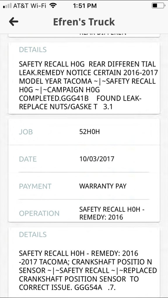

    I took mine in for my last Toyota Care and they did both recalls on same day. After reading all these post I really thought I was going to be with out my truck for a while. I was REALLY shocked to get it back the same day and my truck did have leakage. It was at Gosh Toyota in Hemet.

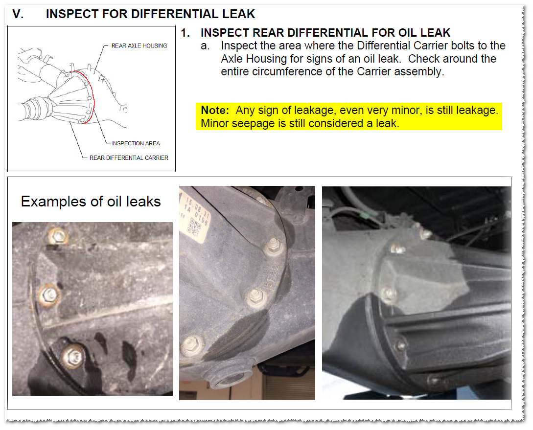

    So apparently that only counts as leaking on a non-off road. Wow.
    FWIW - their own words in the recall campaign states it pretty damn clearly. They're just hiding behind the fact your VIN isn't listed.
